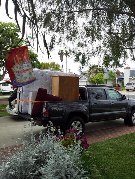

    remember the trucks total payload INCLUDES all passengers and cargo, in the cab and in the bed. 1100lbs or so goes very fast with 4 people and gear
    U didnt mention WHICH TRD u have..........sport or offroad?
    sport should have 4 leaves, offroad has 3.
    Id suggest getting a PROGRESSIVE AAL like Icon or wheelers before ur current leaf pack takes a permanent dive.
    a single aal will not be as smooth as a progressive.
    Ive had the truck stock (3 leaves).........then got the TSB (4 leaves)..............then got 5100's and a toytec/deaver single AAL............
    all rode stiffer in the back than needed (yes even for a truck)....it hopped around on convex bumps in the road and of course offroad. I wasnt aware until I installed the Icon 3 leaf Progressive aal......then it rode plush and the suspension actually did what its supposed to (cycle).
    The truck handles a load just fine tho, so I sacrificed nothing......
    Sometimes I wish I did the Icon 1st, but atleast now I can say "I have tried all of these and can vouch for the progressive aal". Learn from others mistakes and save some money :)
