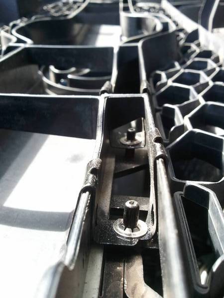

    These are the brackets we made using galvanized "plumber's tape". Just bend them to fit in between the grille fins, paint them black (soak the metal in vinegar first so the paint sticks), then put the locking posts from the emblem through the holes, and voila, you have a "permanently" mounted emblem without drilling or gluing your grille.
    I did do some grinding on the metal to make it flush with the TRD lettering, that was the most time-consuming part.

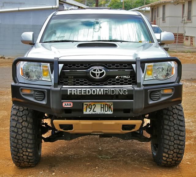

    Just got this one off Ebay:

    You have an awesome truck man, but I gotta ask... why would you have the beefed out ARB bumper and the pathetically weak 'fake' TRD skid plate? Why not get some real under armor to go with that beast bumper?
