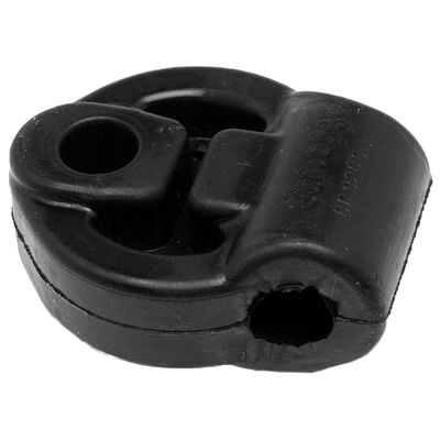

    The stock exhaust hanger looks like this but no longer fits:
    (straight through on both holes)
    but it looks like for a new one, it would have to be "offset" with both holes.
    or basically a "twist" like this one from an Infiniti
    I'll take more pictures ASAP
    Wondering what the best and cheapest solution would be, such as:
    -consult an exhaust shop; they might cut off the stock hanger rod and weld on a new one, new section of pipe, or heat the hanger rod until it's red hot and twist it to a different angle with pliers or a wrench
    -install some kind of "twist" new hanger rubber
    All of the other parts seem to fit. The front 3 or so hanger rubbers, the flange mating part, and so on. It's just the rear most hanger that is now coming at a different angle, so I've left it unattached (probably not good to do long-term)
    closest near the exhaust tip

    edit: I just tried to see if Autozone stocks the Infiniti/Nissan "twist" hanger and found this Walker part that can be ordered:

    Walker exhaust hanger catalog says OEM part number is 35725, with 1 3/8" between the hanger holes
    and a twisty version available of part number 35149, but the holes distance is bigger at 2.5"
    I think that one would be too big vs the smaller Nissan one, otherwise I'd order it from a general auto parts store
    wouldn't that set the truck on fire and melt the spare tire
    a torch will probably run $20-50 for the gas canister and handle head
    twisty hanger might be $7
    decisions decisions

    i had to do the same thing on mine, i ordered the hanger you have in the picture from mbrp for 14 dollars

    this will work , i had to do the same thing
