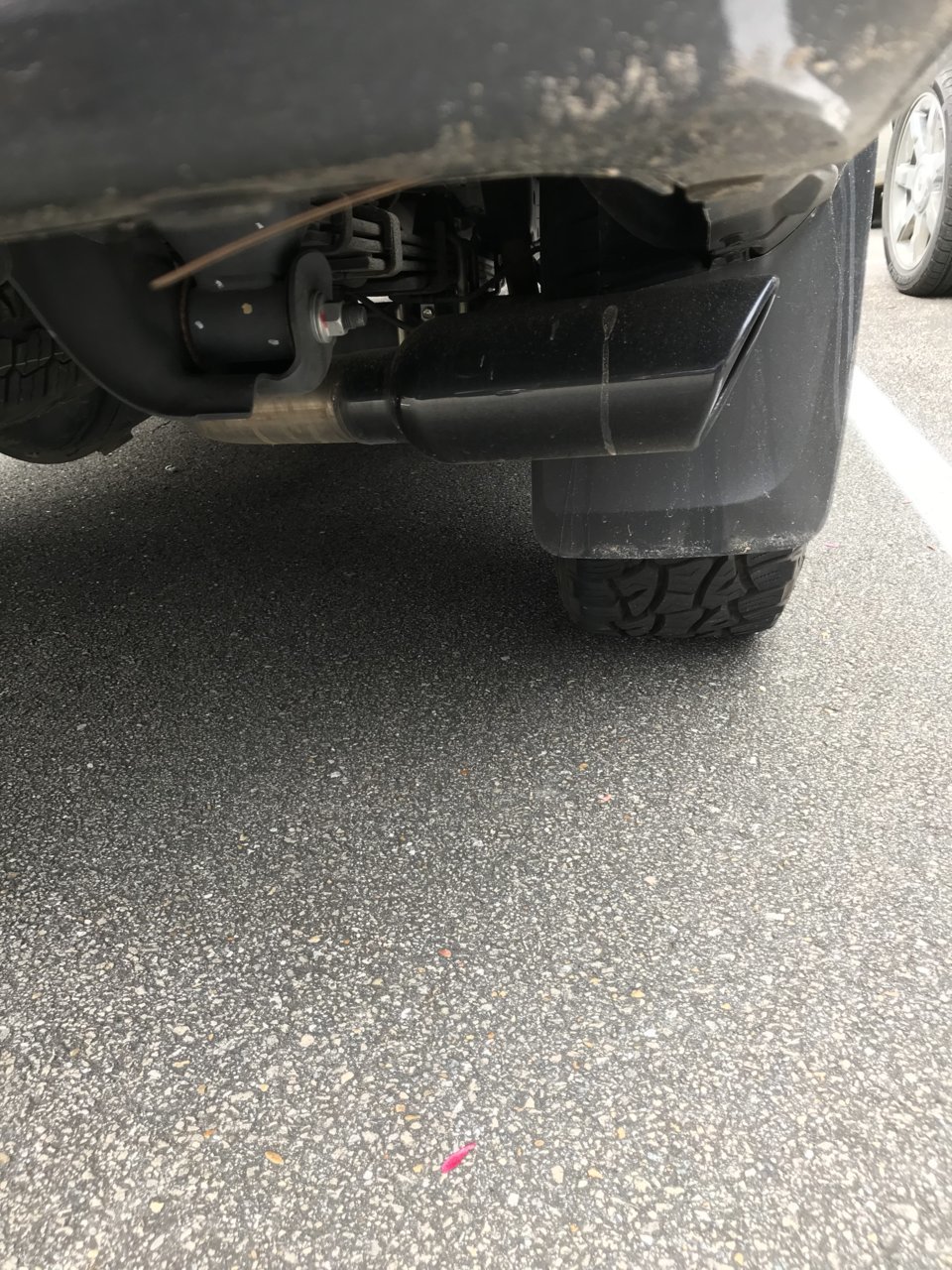

    Has anybody experienced any drone with their TRD exhaust? I installed the exhaust over the weekend and it's quite a bit louder than I was expecting after reading the comments here. Think I'm getting a bit of drone as well between 2k-3k as I'm feeling some vibration. I don't see any rubbing but I didn't replace the gasket at the joint. Don't hear any leaks there at idle but I guess it's possible I'm getting some leakage at higher RPMs. Thoughts?

    Did you replace the gasket? I replaced my gasket when I had my chrome tip version with no leaks. I did not hate the drone, I did notice less drone with OEM bed mat.

    My DCLB with the TRD exhaust has never droned.
    Move the exhaust hanger rubbers around and see if that helps.

    Did it ship in 3 pieces? Try turning the tip up. I think my Borla sounds better after doing this. A little less resonating afterwards.

    It’s almost like some resonance I’m getting around those RPMs... I can feel it in the seat. I’m going to get under there and look at everything tomorrow morning. Might go ahead and replace the gasket as well.

    I’m starting to wonder if it is just my perception. Crawled under today and the hangers all look fine. I ordered a replacement exhaust gasket to rule out an issue with leakage at the joint. My two previous cars, Civic SI and Focus ST, both had cat-back exhausts. They both had a bit of drone, I was just surprised to notice any with the TRD. It seems the general consensus is it isn’t much louder than stock.

    I think it’s more quiet if you can pull the tip up closer to the body.
