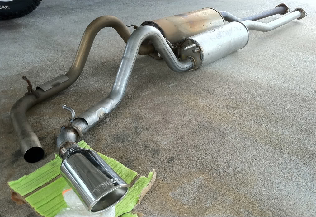

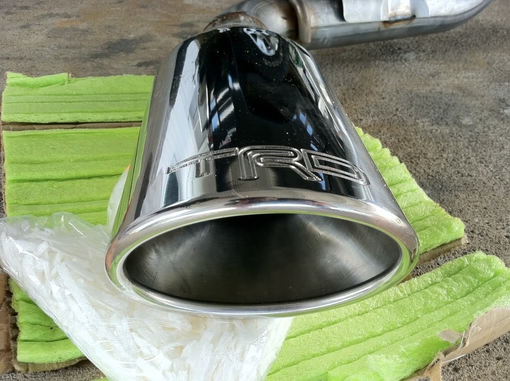

    Got mine and had it installed last week. Overall, it isn't nearly as loud as I thought it would be, but it does have a nice deep sound. I kinda wish it was bit louder but at least it doesn't sound ricey like how some other catbacks do.
    Pics if anyone is interested...
