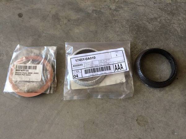

    just finished this today, with one hiccup. i ordered the wrong gasket.
    i have an 07 with 4.0. the gasket part number is: 17451-0A010
    it's flanged, not flat.
    here are some photos of the gasket, to go along with this writeup. haven't seen any photos of the gasket in any of these types of threads.
    wrong, new, and old gasket:
    new and old gasket comparison:
    paid cost at the dealer. could have ordered it from Amazon with prime shipping but i had already taken things apart. rode my bike down there and picked it up instead.

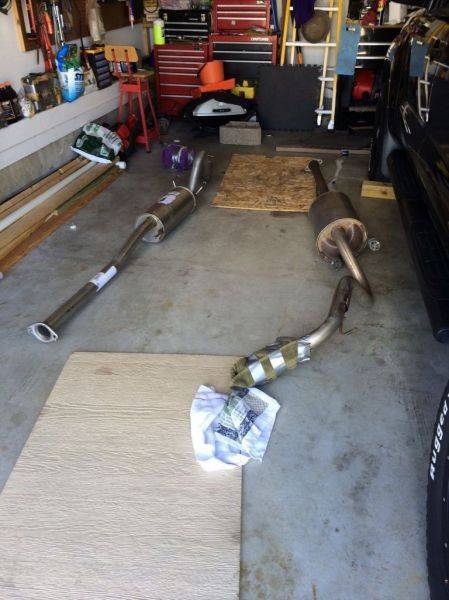

    it's fun. like you all said, i noticed the smell and tone. it does not drone as much as i expected it to, especially with all the mixed comments. will wait until it has a few miles to notice it settle down.
    also, if you're worried about hitting and damaging the cables on the rear axle, you can unclip them and move them out of the way.
    thanks again. fun and easy project.
