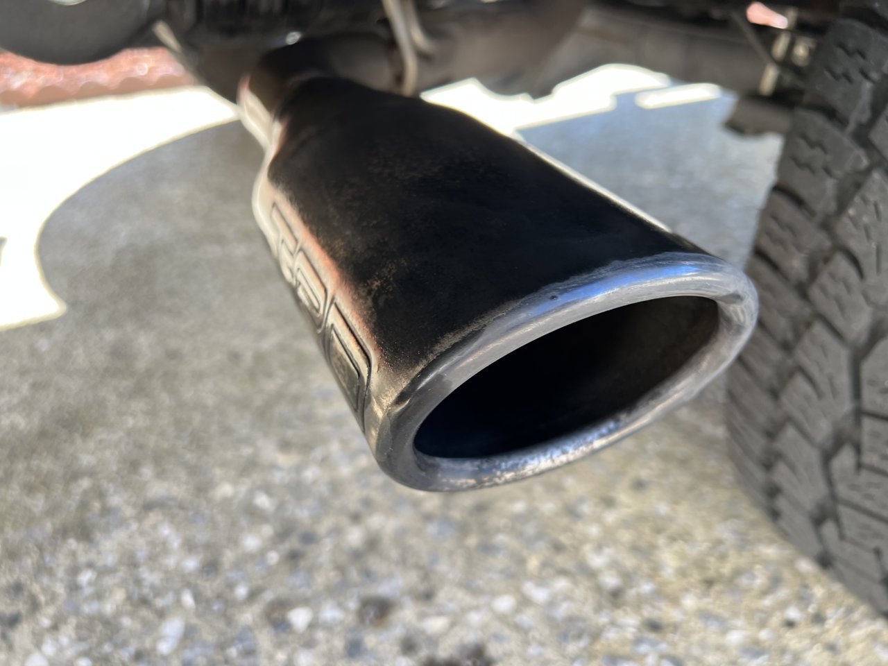

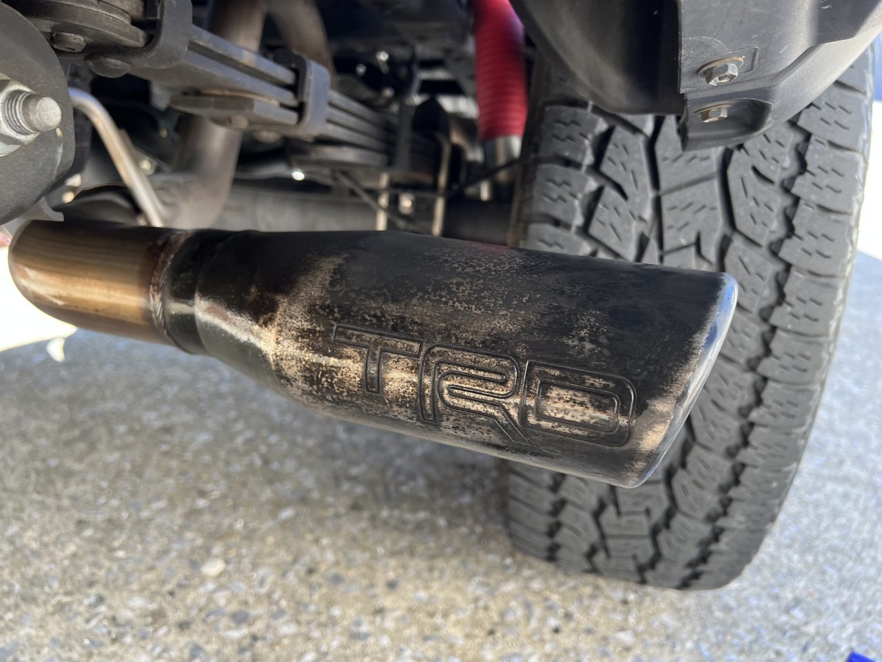

    I've tried all of the above, steelwool, chrome polishing compounds, etc... The pictures I posted is how it looks after cleaning. Never had that problem with any other chrome exhaust.

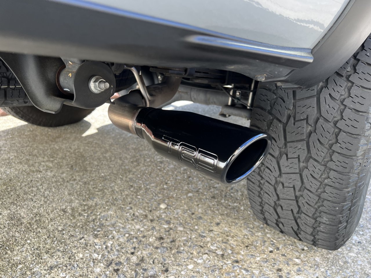

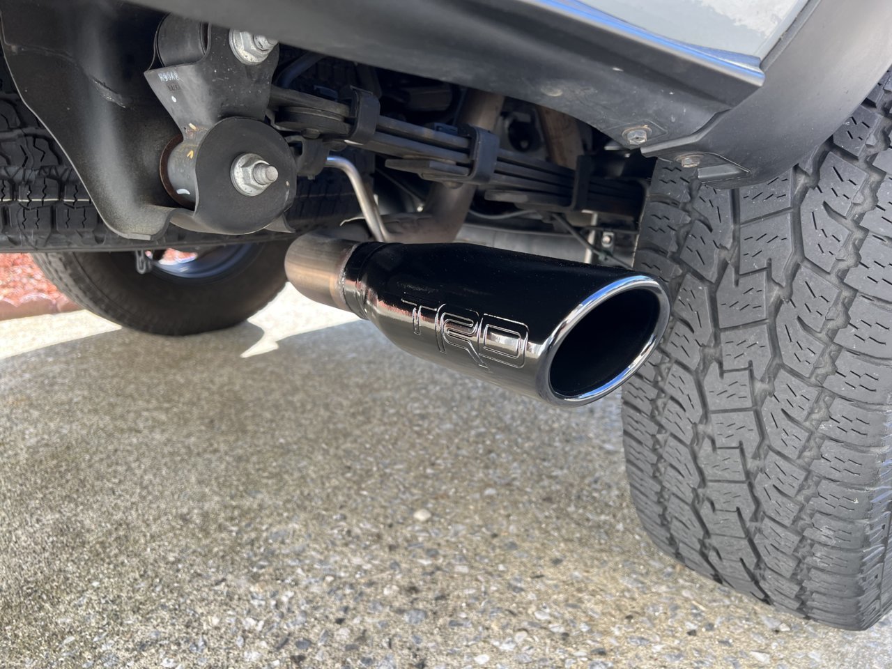

    Finally got to it. Sanded it down and painted it gloss black with the engine block paint. Came out nicer than when it was new.

    It seems that the problem is mostly with the black chrome tips. Whatever Toyota uses to black them out is garbage and can't withstand heat.

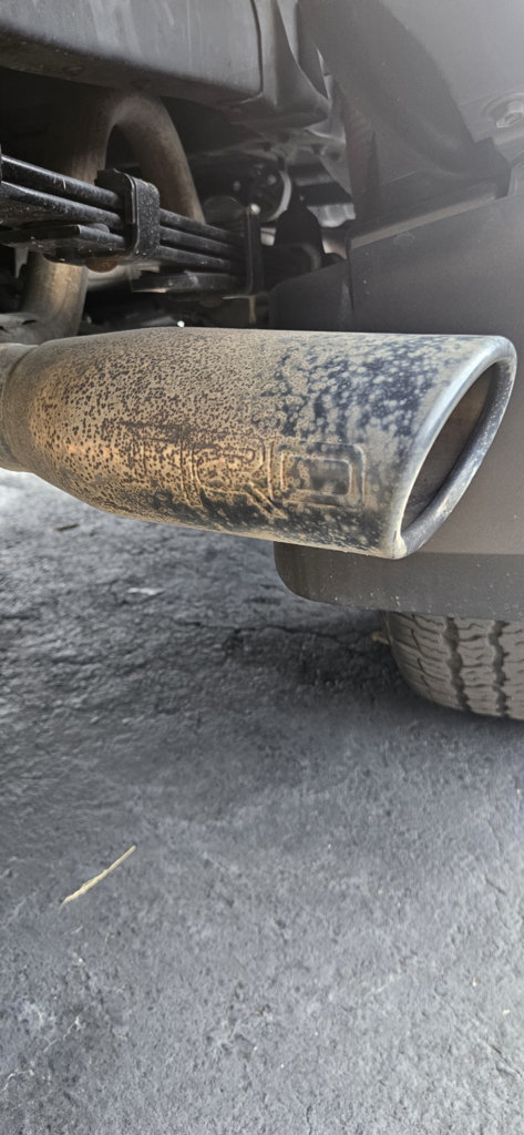

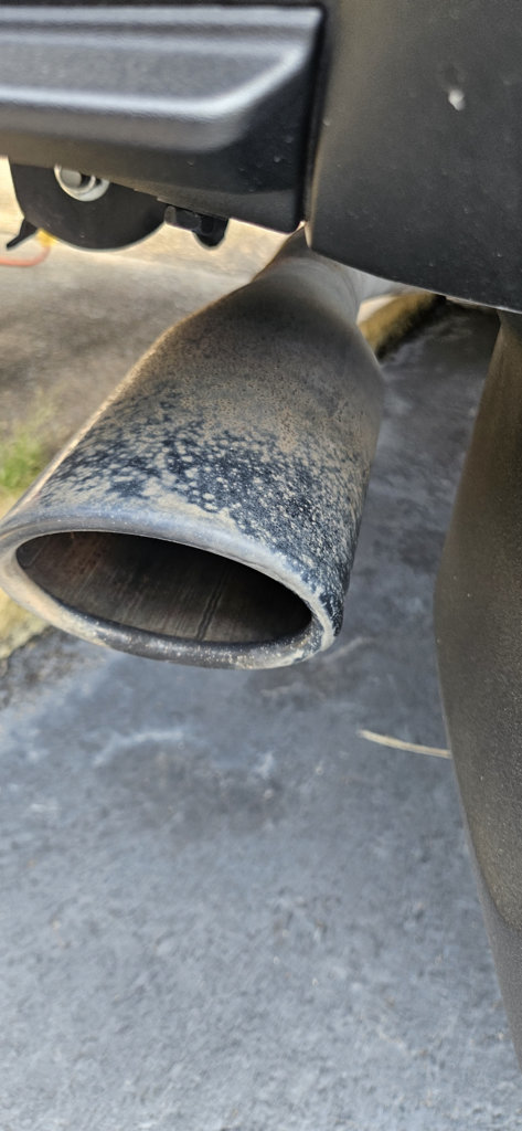

    Glad I found this thread before starting one, bought a used, but new to me '23 pro with 31150 miles on it, the tip looks like this....
    Im gonna steel wool it, then maybe wet sand as well, then paint with high heat exhaust paint matte black
    @RX1cobra
    What did you do???

    How does it look now?

    I just stopped looking at it. :anonymous:
