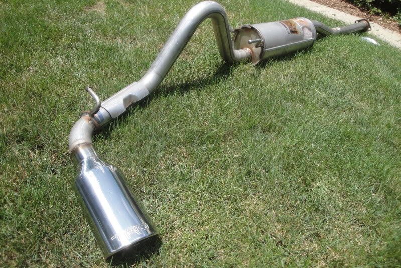

    Only way is to check the muffler, really. Heres a pic of the trd if it helps.
    Borsa is stamped on the bottom. Theres some numbers on the bottom of the muffler too. I might still have a pic laying around somewhere

    Whats he asking for it btw? I can't imagine it being worth much more than like 150 bux since its been hacked up... maybe... I dunno. Any more than that and you can probably pick up an aftermarket muffler and have it welded into your stock exhaust for the same or less $. There really isnt much difference in the bends/piping between the two.
