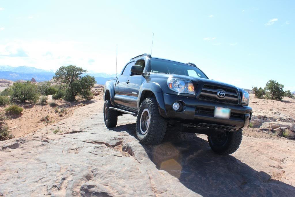

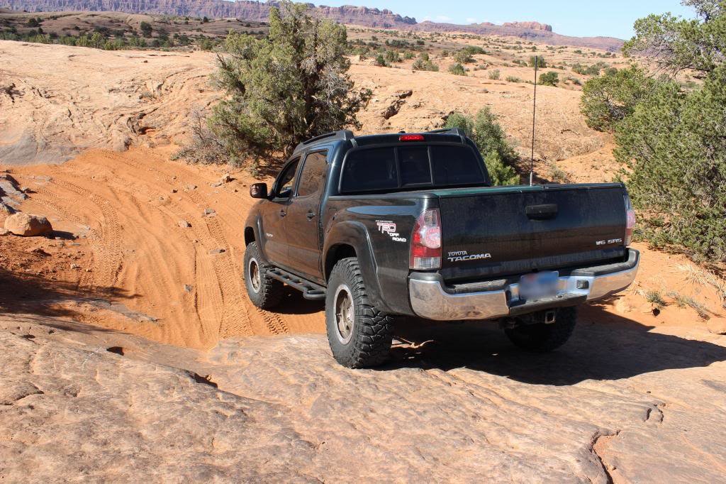

    Here are a couple of poser pics. Nothing too extreme here. I believe both were taken at fins n things.

    They're actually 285's. No CMC, and it has never rubbed.
    UCA's are required though...
