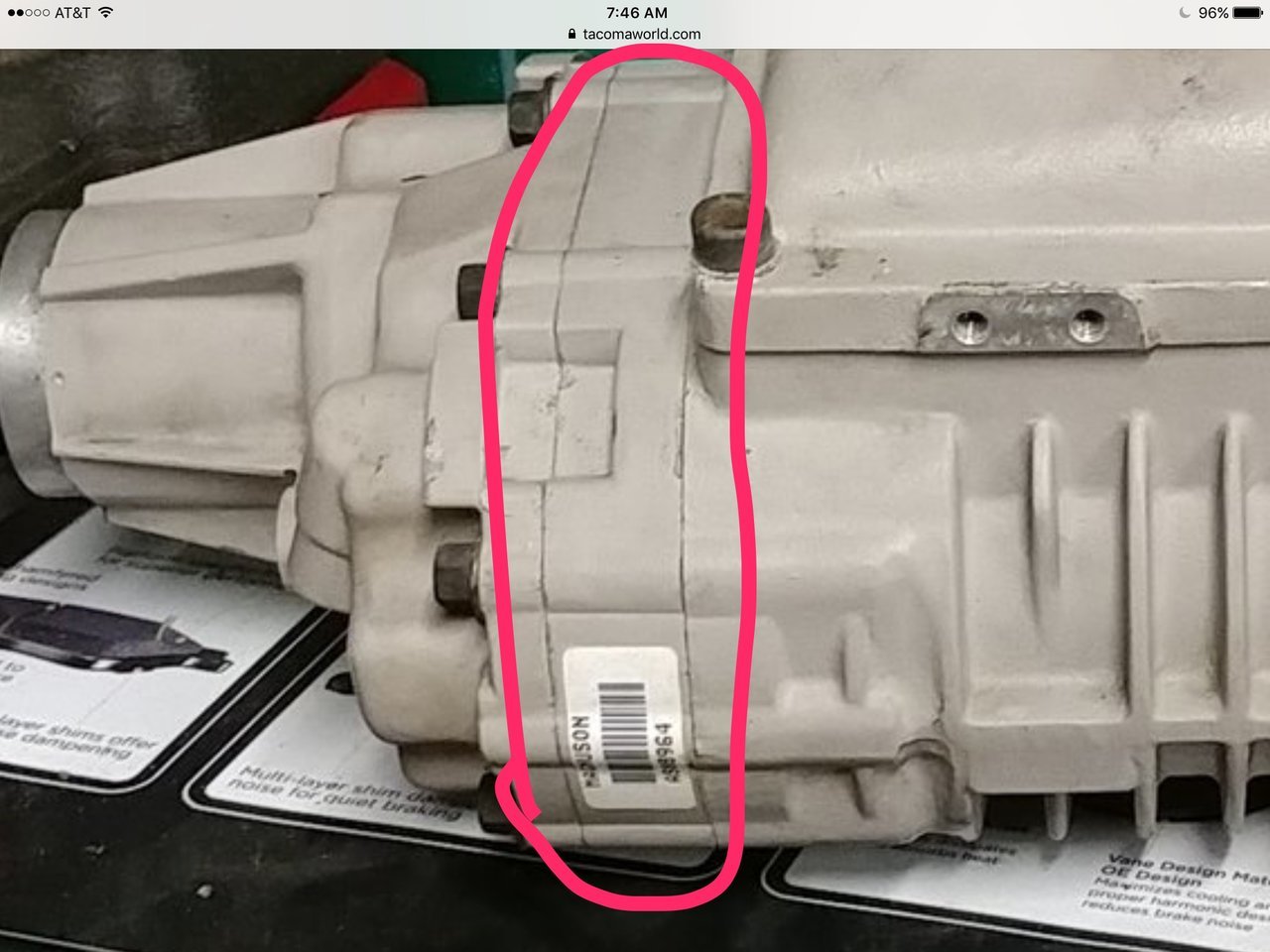

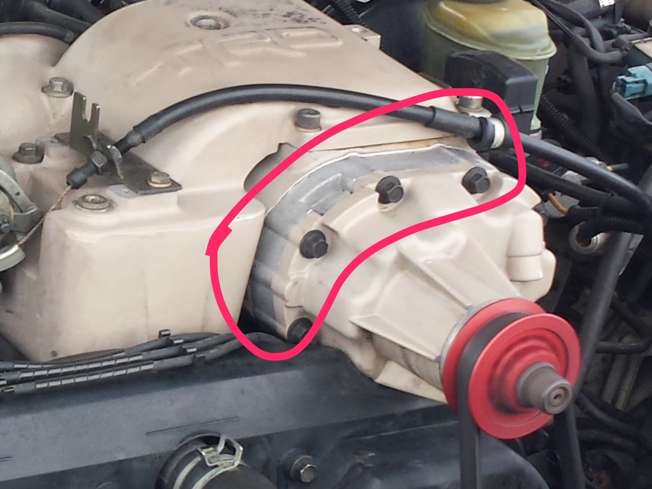

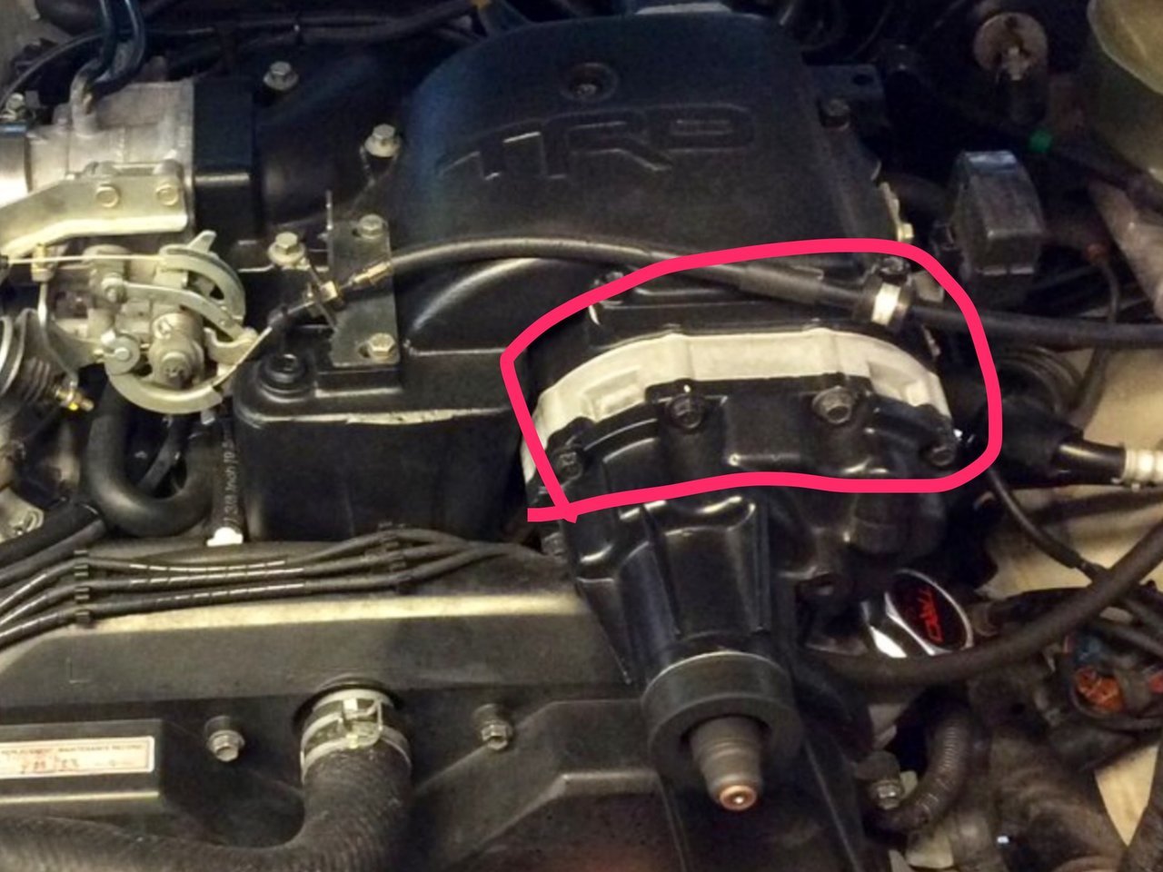

    Typically when these supercharger are rebuilt by the Magnuson company or a professional shop
    the rotor pack plate is replaced and not repainted, the rotor pack plate on this unit looks original still,
    So it probably has not been rebuilt as it has the original sticker, original paint and or might just have low miles, hard to say.
    When shopping for a supercharger if you see the rotor pack plate not painted that means
    it's been rebuilt at some time.
    Either way this is probably a great buy as long as it has no bearing issues or nose seal leaking. These superchargers will last a lifetime with little maintenance but will need a complete rebuilt every 150,000 miles.
    As with any used part it's always great to be able to have a video of it running before u buy.
    New pulley and bolts and gaskets and oil change will be 100-150
    and I would have a butt screw added by a machine shop for 50.00
    so that u can do an oil change in 5 minutes
    Here are the differences, FYI

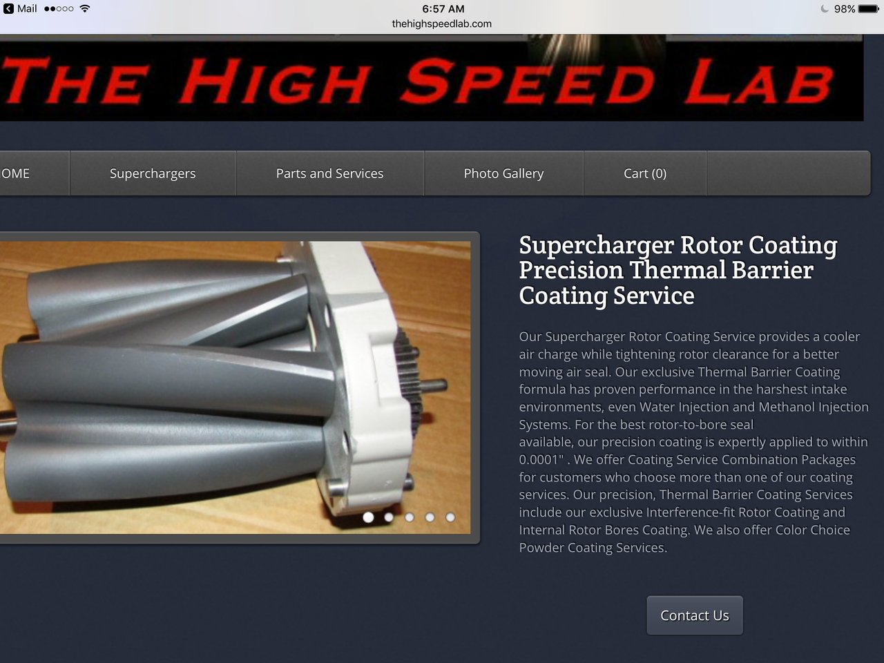

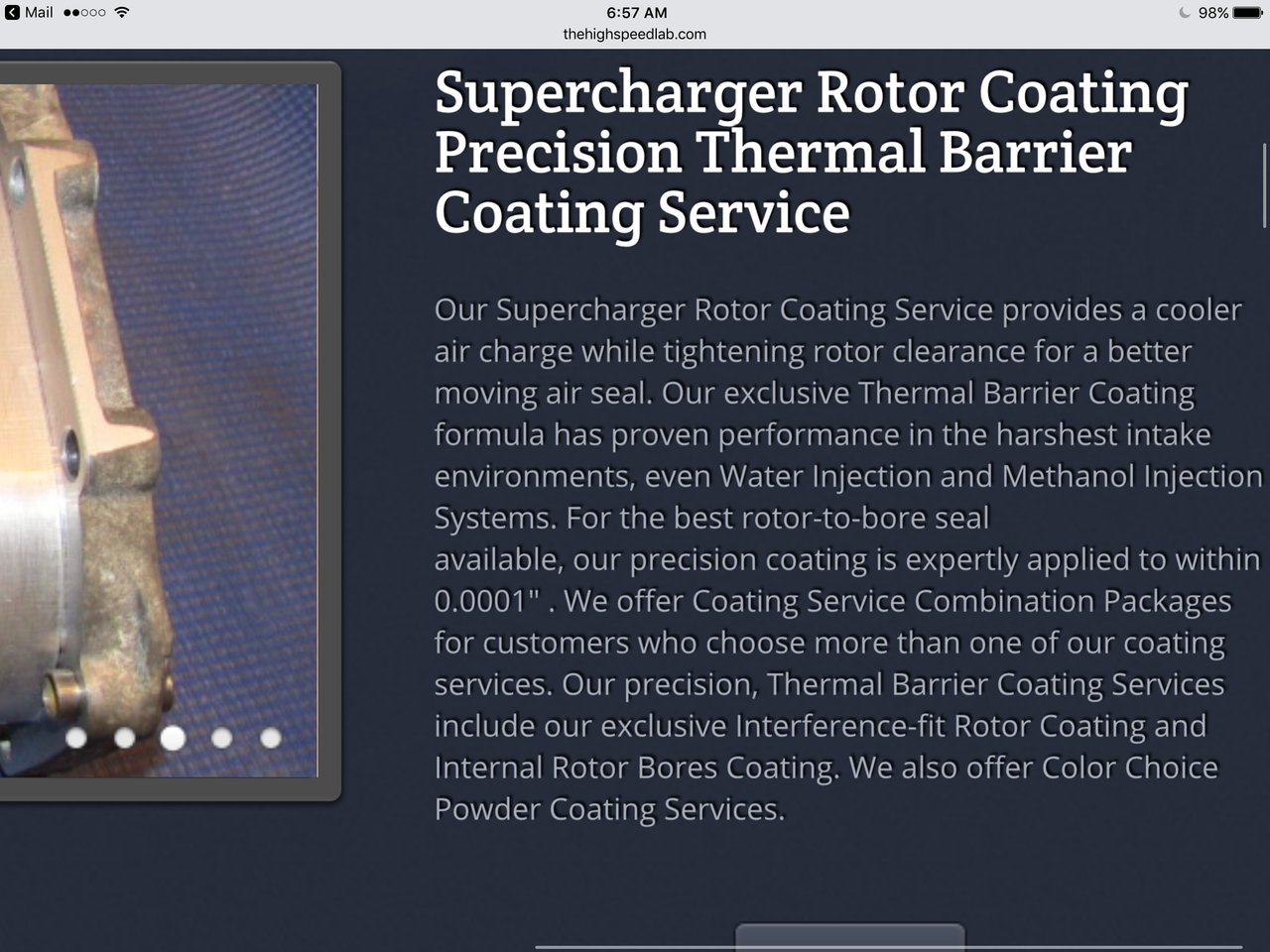

    Sc rebuilt usually, get the rotor pack recoat for tigher clearance.Tigher the more compression =hp, over time rotor clearance open up due to coating coming off or wear. I used to work for a sc company for a few years! Lmao

    Any good places to get it rebuilt between here and Fresno?

    Send off to the high speed labs

    I would send the rotor pack to any company that are willing to recoat them, but I can tell you it's not cheap! Not sure if other company would take another company sc for rebuilt. The rebuilt anyone can so it's the coating that makes a difference. The high performance sc we built can't be turn by hand! Lmao clearance are so tight it's crazy.

    Ryan recommended that place to me and I gotta say it looks like a super impressive spot. The only thing is for the price of a rebuild I'll have to find a s/c for $700 or so to hit the price I want to pay, which do come up. Sometimes out here in SoCal you can come up on amazing places that charge cents on the dollar of other places so I figured I'd ask. Case in point - an off road race fabricator would normally charge me $350 for a steering rack rebuild with the the same seals they put on their trucks, but they got too busy to do it and told me where to take it and what to ask for. $150. My jaw dropped. So I like to ask around sometimes, but thanks for the suggestion. High Speed Labs will be where I send a sc if I get it for cheap enough and don't find anywhere cheaper that does top quality work!

    Ok cool, John (btw) not Ryan, if you think you can do the clearance setting on the rotor pack.
    I know a few people that did the rebuilt but had issues with the rotor pack clearance hitting each other and had to
    send in the whole supercharger to have the clearance set correctly.
    I don't know how the clearance is set or adjusted.

    The coating is unbelievable thin, definitely a process getting it applied evenly,
    I would be nervous trying to figure out the clearance and timing :)
