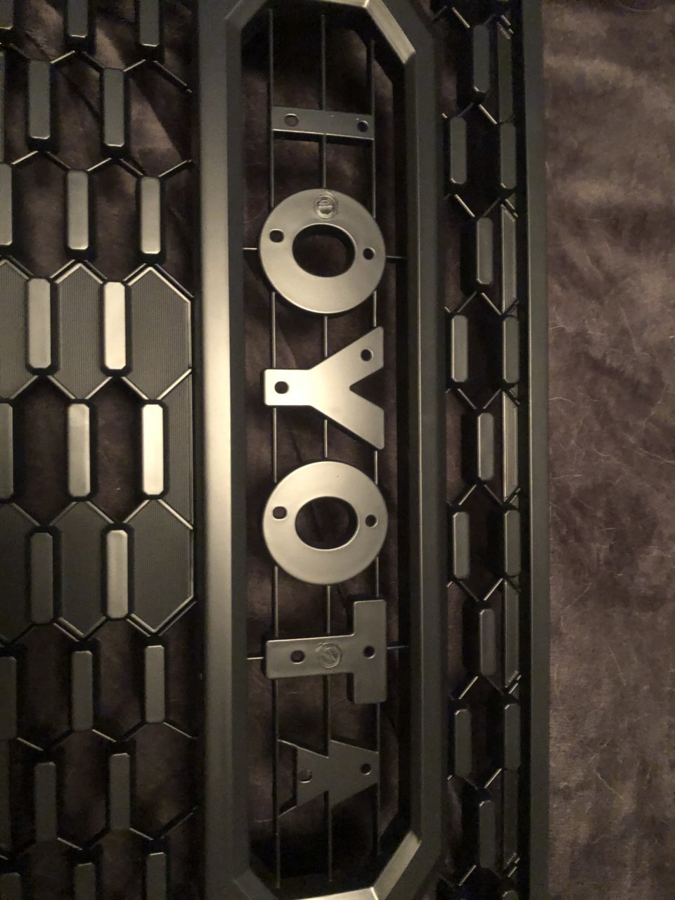

    I bought a grill for my truck and the let’s came separate so I guess I have to attach them myself which isn’t a problem. The problem is they didn’t come with any clips or anything to hold them in place on the grill. How should I do this?

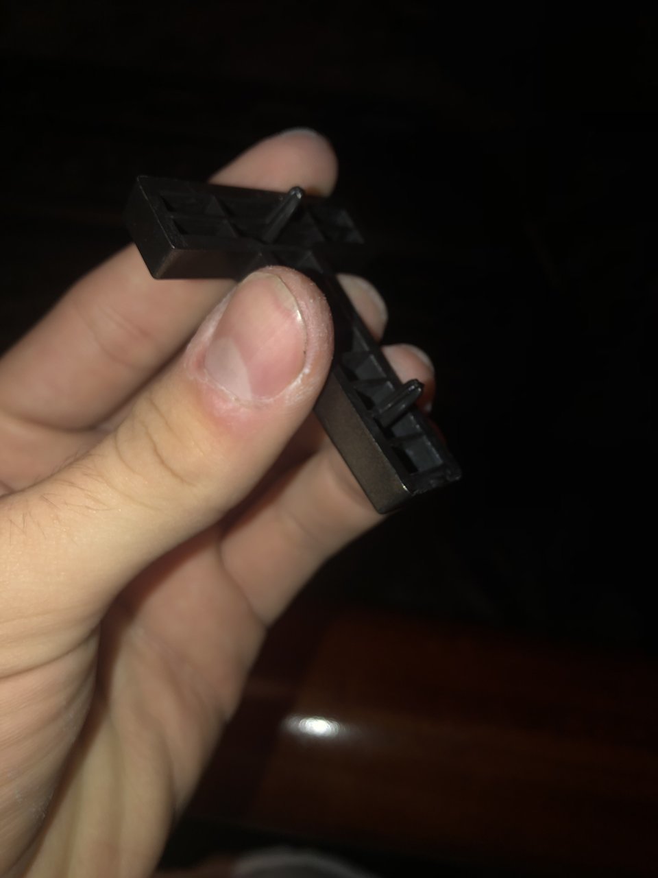

    D4842489-D3B0-4277-A08A-88E69459F76F.jpg E541A401-E0A2-495C-91A2-693B45A36FFB.jpg

    Ya, it’s double sided tape. Mine arrived attached. Dab of hot glue on the post and push it in should be fine.

    Hot glue will melt in the heat, sitting in a hot parking lot in the sun.
    Plastic weld them would be the best route. You melt them down with a soldering iron. If you don’t have one you can use micro torch to heat them up and press them down with a screw driver or something similar.
