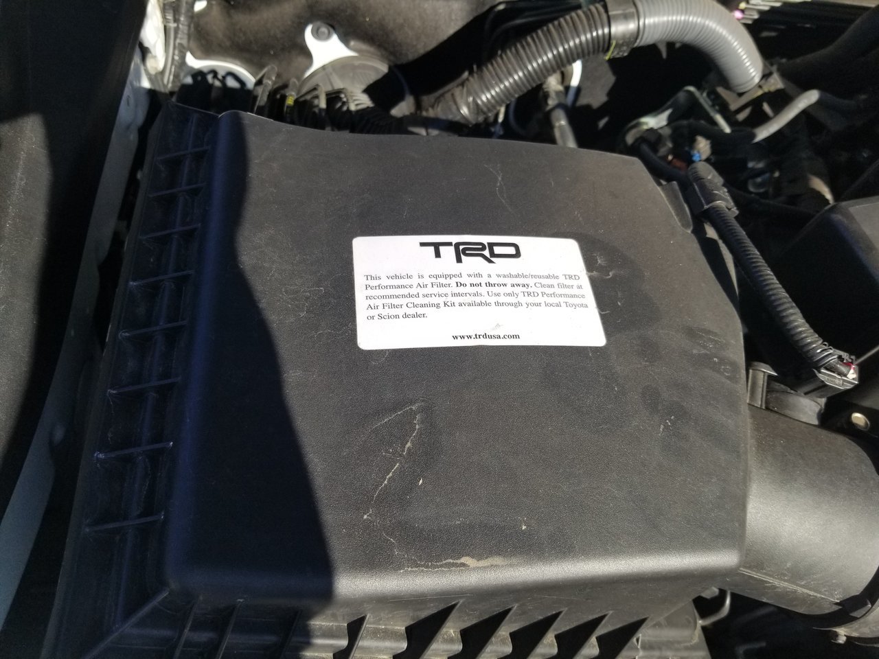

    Just curious if this kit has to come with the carb compliant sticker for us in California. Any ideas? My stock setup already has the TRD rechargeable filter and has a carb sticker on the box. I was going to reuse the filter and piece together my setup.
    Edit:. By the way just ordered all the pieces today minus the filter for $279. They are running a free shipping this weekend only deal and didn't want to pass up.
    Edit #2: I just looked again and actually mine doesn't have a carb compliant filter it just has this sticker.20171217_094621.jpg

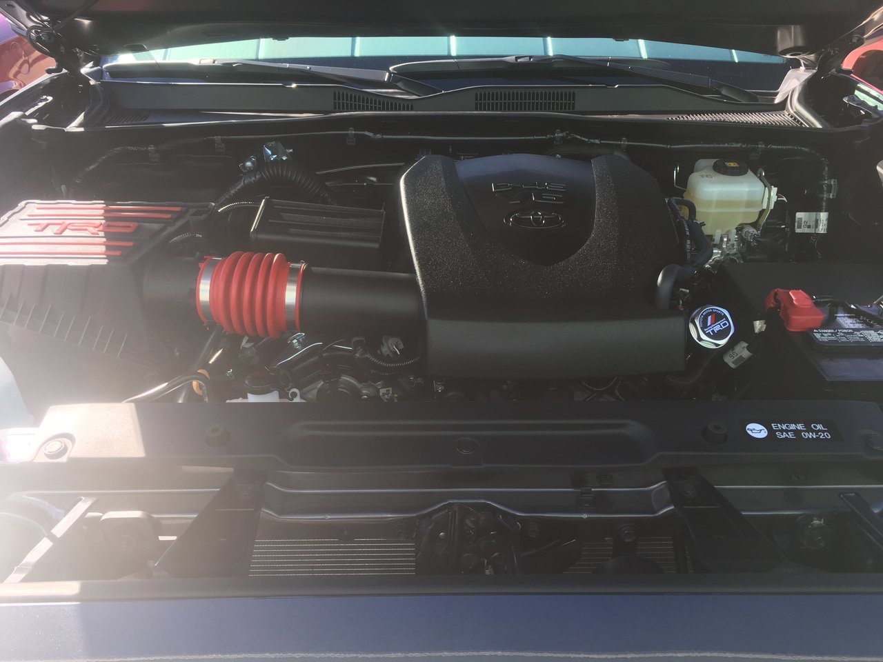

    Thanks for listening all the parts and Feedback! Installed mine yesterday. Very happy with the results. :thumbsup:

    :thumbsup: That is one clean looking engine! Do you spray it down and clean it regularly?

    Thanks! I haven’t had to yet, it’s brand new. 314 miles. :)
