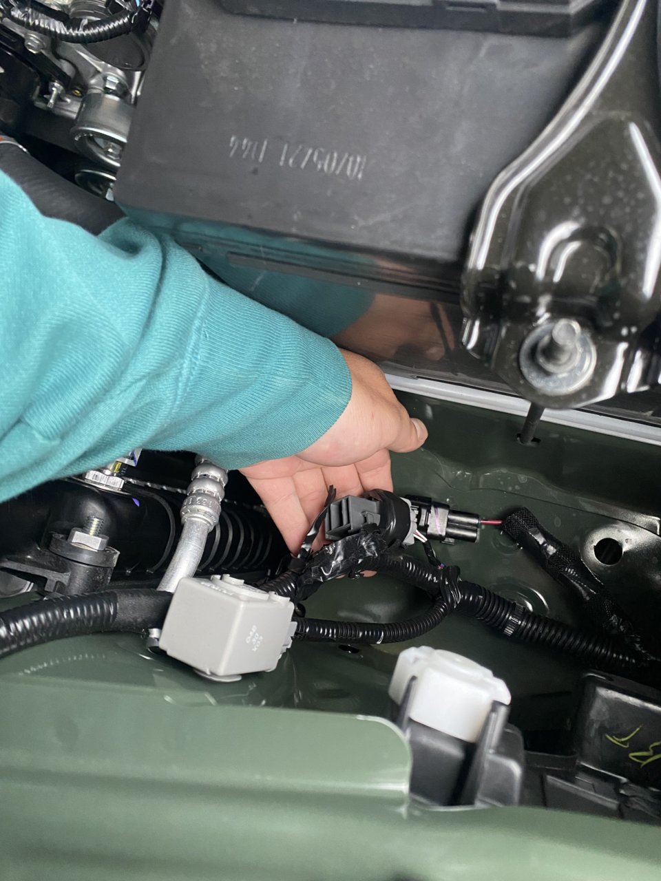

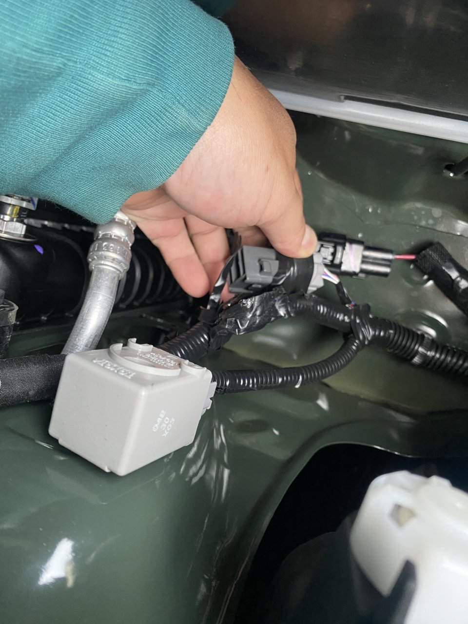

    I just did some more digging and found this which was hidden from view originally. Wiring noob but it looks like a connector missing the other end and the tape near it has definitely been messed with. I also dont see any other connector nearby or really anywhere that could be plugged into it.
    Does anyone know what this normally is connected to or what its for? right in front of the battery.

    Not a pro or anything but that doesn’t look right lol.

    No it does not. Hopefully someone on here can tell me what it goes to or if theres a fix I dont see. And in the meantime ill cross my fingers its connected to nothing worse than the fog lights.

    It's a junction block, it ties a few circuits. OEM stuff.

    is it normal to be taped and look janky like that out of curiosity?

    Tape yes...janky, no. Could be someone tugged at it. A little more tape gets it back to the main harness.
