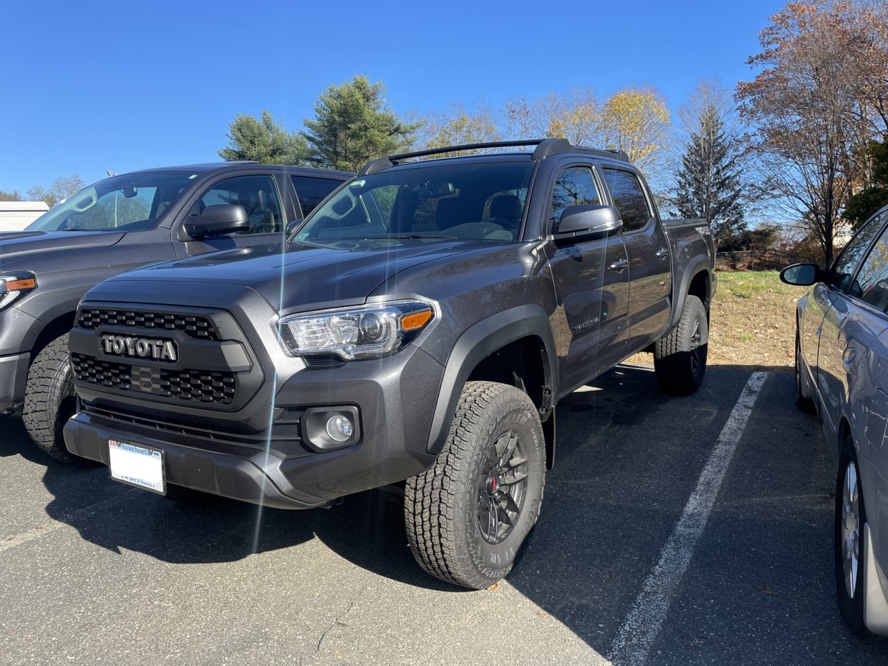

    tacoma.jpg I just realized I only have 1 picture of my truck on my phone lol...
    Here is how it looks hard to tell. Aftermarket grille BTW. I measured it out and it's about 1/2 different front/rear - which I like.
