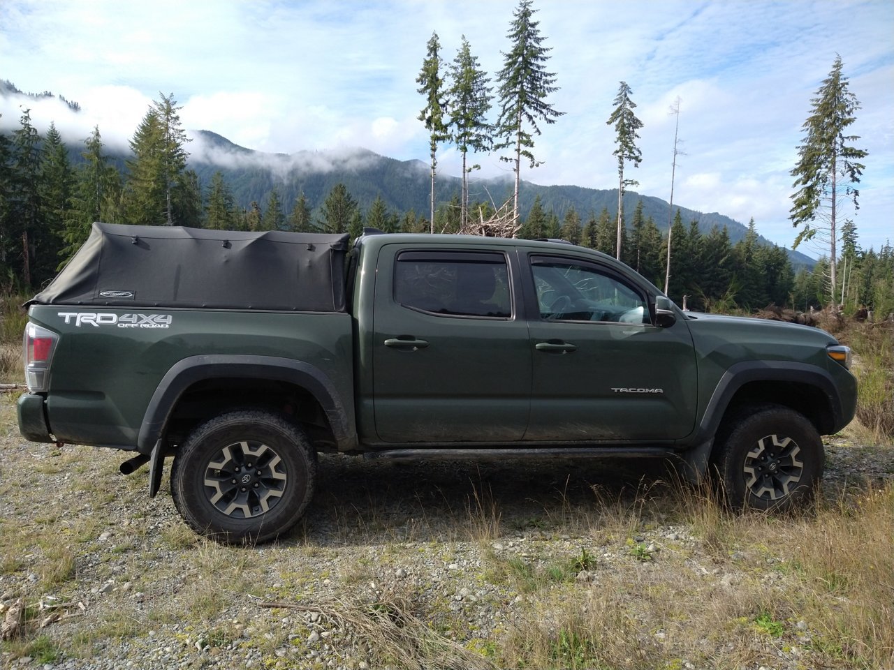

    Another question: can I use an add a leaf kit for the rear, or do I need specific bolts because of the lift kit spacer blocks in the rear? Want to beef up the back end to avoid sag under load.

    I would assume the blocks would be removed if you AAL. I am interested in this as well though.
    Edit: Mind posting a pic of your truck with the lift? I am waiting on an AG to come in.

    With TRD lift kit. No AAL yet...

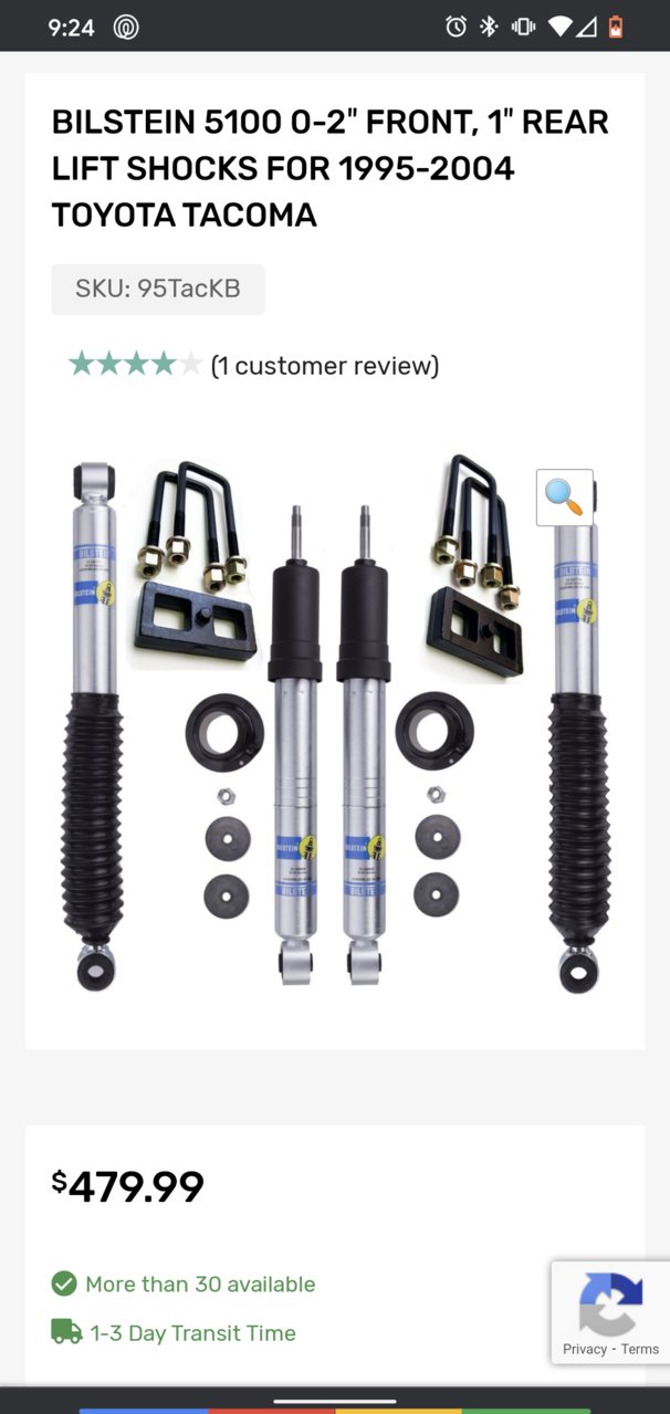

    a lift can’t void your warranty unless the failure can be proven and linked back to the kit. Also don’t overpay for a bilstein 5100 kit… just my two cents but this Toyota kit is a ripoff when you can get a much nicer kit for same price.

    More than just struts... if you like the kit and if you can get for under $1,100 go for it

    it’s a trd pro grill and bilsteins

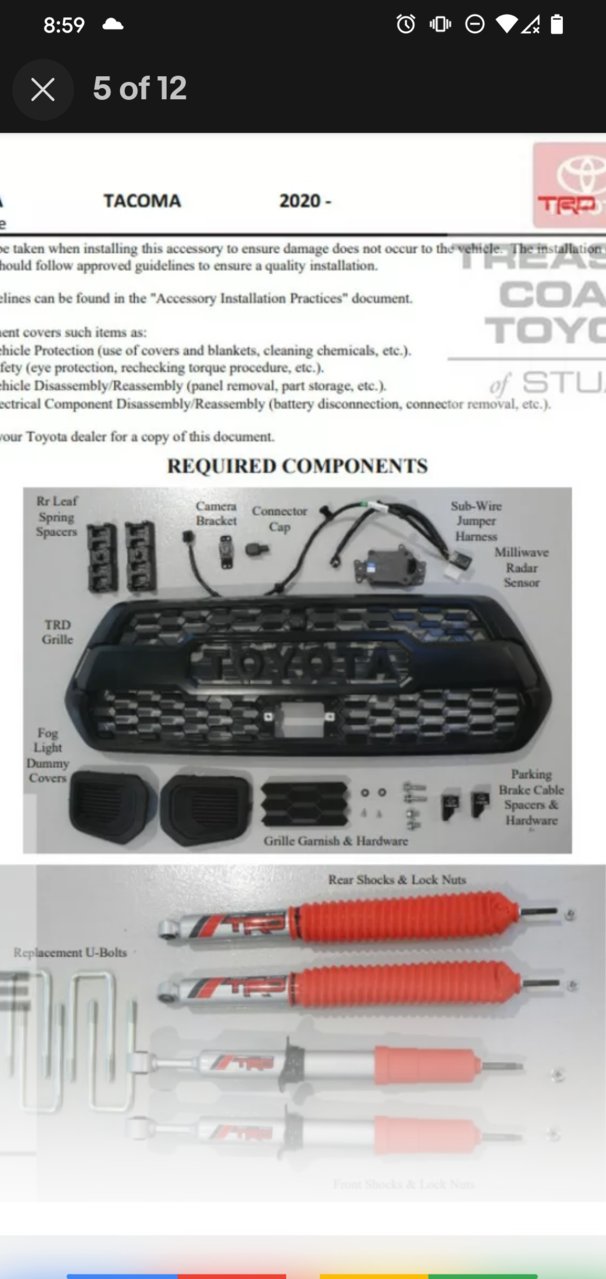

    Take out the cost of the grill it's not too bad. The sole reason I am going with this kit is to avoid dealing with TSS issues down the line. Toyota won't recalibrate any other lifts and I've had shitty experiences with Toyota warranty claims in the past.

    This is all you get, if you buy this and OEM grill you still don't have all parts included with this kit. Cheap? no sure isn't. If you don't want the grill I can agree that it doesn't make much sense. But this and a OEM grill is almost $900 and isn't the same amount of parts

    To your point though for going on the cheap and buying knockoff parts, where's the rest of the parts included in this kit from Toyota if the OP went that route and bought a knockoff grill? Your at about $600...How much would the sensor, harness, brackets cost? For about $400 more you get a complete kit, with warranty, and assurance TSS works properly, with OEM quality parts to boot.

    The TRD lift is already installed. I was simply asking about add a leaf with this kit because I want to get back to the original stance, avoid sag under load, and maybe switch the Softopper for a mid height rack and a James baroud clamshell tent, or go fast camper someday.
    Boy, you guys really go down a rabbit hole debating the merits or lack thereof of the TRD lift kit... That is already on the truck...
    Yes. If I wanted a rig built for Moab, I would have gone aftermarket 3 inch lift. It's my daily driver, and these rigs suck fuel enough. But which lift to get wasn't my question. Thanks for those that gave me some good info.

    Yeah and the trd lift kit grille is different than the standard OEM trd pro grille (black letters instead of grey and includes a camera mount up top) however, the garnish is really expensive and is included in the trd lift kit ($300+) so the kit really is a pretty good deal overall
