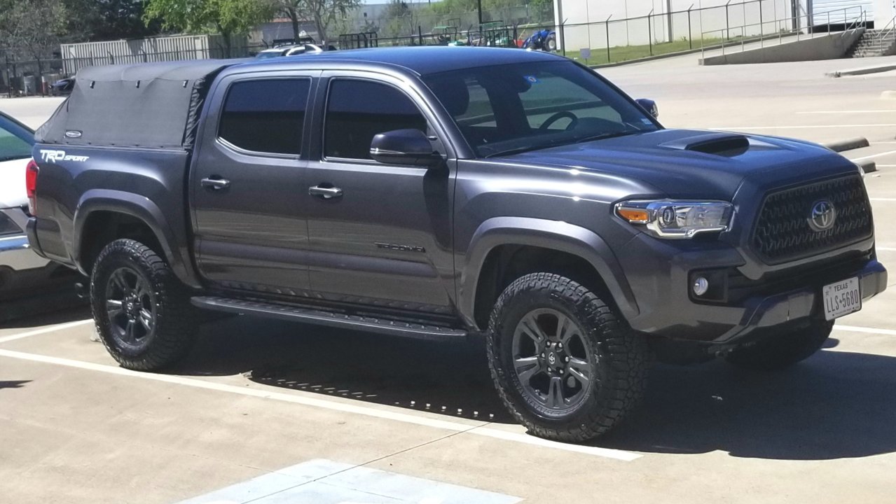

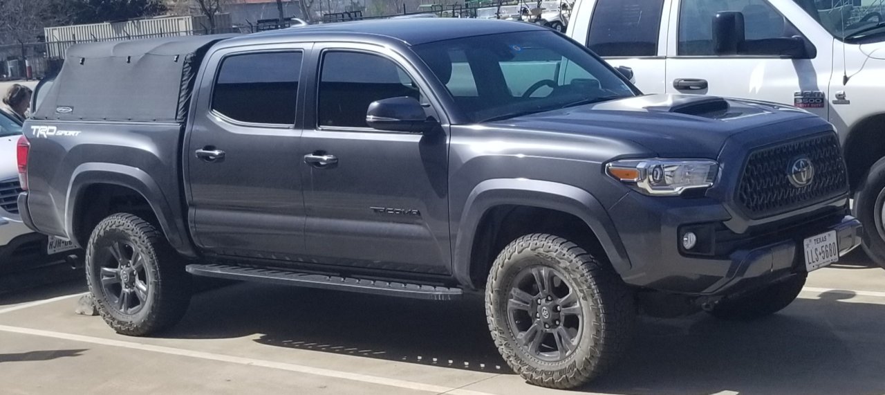

    I've spammed pics of my mediocre truck in practically every thread. Screw it, I'll spam it again. :cookiemonster: Here's a side-by-side-by-side of what you are considering:
    Stock size, 265/65/17:
    +1 size, 265/70/17:
    the same 265/70/17 tires but with 1" lift and 4-Runner Pro wheels
