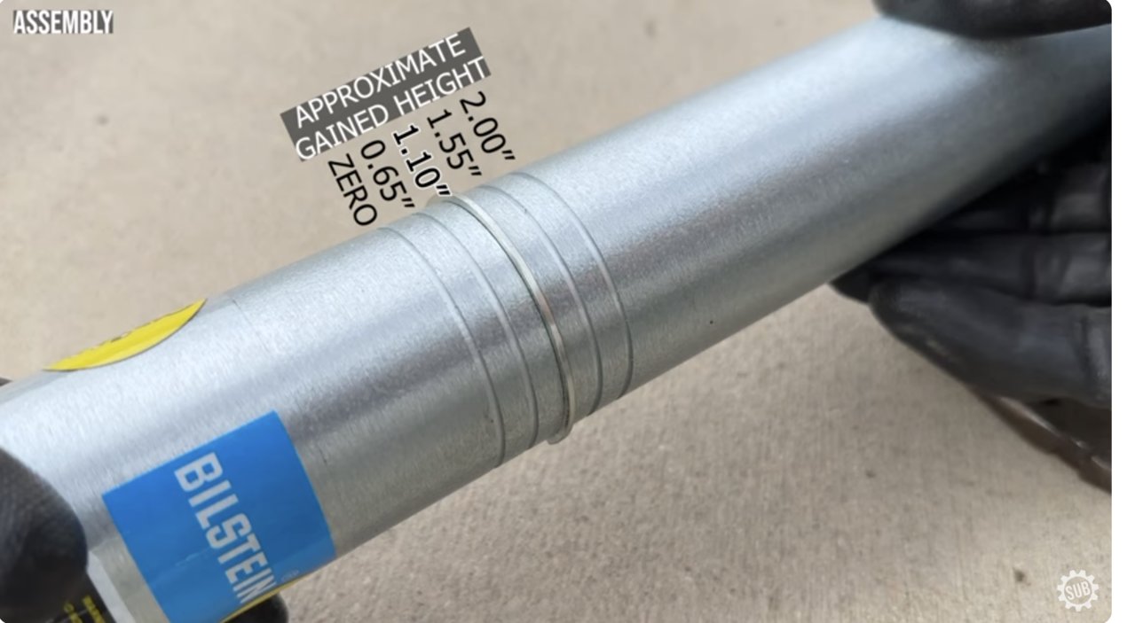

    I like the factory rake and hate the slightest indication the front end is higher than the back. I was able to measure the new truck and it’s currently 1 1/4” higher in the back, measured from the centre of the rims to the underside of the fender flares. The front shocks on the lift kit have at least three possible ride height settings. I am considering 1.55”, not the full 2”. That will leave me with about 3/4” of rake after the lift kit is installed (1.25” current - 1.55 front lift + 1” back lift), but before any load is added.
    Has anybody gone through this with a canopy or bed accessory install? I would like to get the full 2” in the front, but I’m concerned I’ll end up with a squatting truck. And if I understand the installation, going back and changing the ride height setting on the front shocks after the initial install might mean recalibrating cameras/sensors and rechecking alignment.

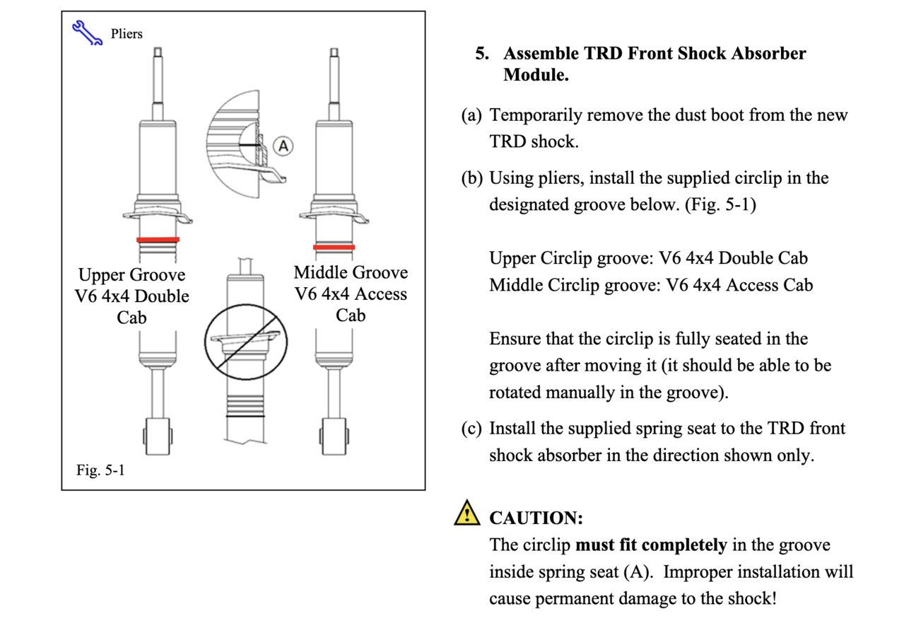

    Here's a couple of pics referring to ride height. The second is from the Lift Kit installation instructions.

    It specifically says not to disable fogs in the Canada instructions.
    I'd say instead of the block do an add-a-leaf to gain the 1.5" in the rear and lose a bit with sag and the leer cap.
    https://www.iconvehicledynamics.com...coma-multi-rate-rxt-leaf-pack-w--add-in-leaf/
    Many caps cause sag and a simple extra spring(s) makes the factory springs last a little longer for little extra money. The 1" block with the TRD pack wont help with this.
    Also, looks like you tow, skip the block. AAL or leaf pack is the best choice.
    This basically leads to the next point, just do a 5100 lift with an add-a-leaf, its tried and true, costs less and gives more choices for rear lift.
    Last point, if you do TRD, they have to install it on the second clip to match the calibration numbers, the shop may allow you to do 1st clip, but by the book they shouldnt.
