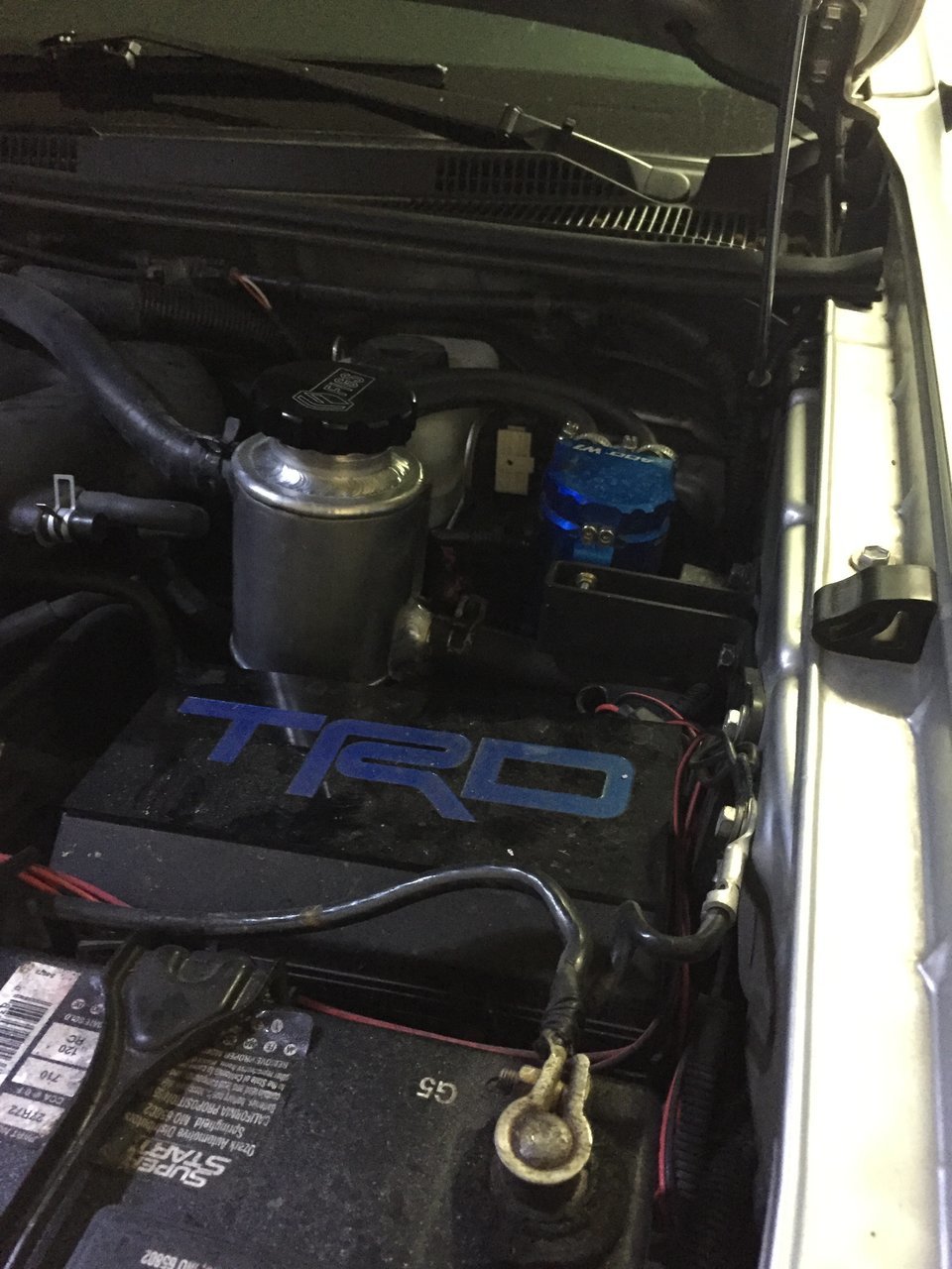

    And before the flames hit, overflow tubing is for my new coolant reservoir. Old one leaked.

    That's for automatic tranny is it not? I drive stick

    Oh okay you are good than. Your fuel pump may be the limiting factor for the pulley than. At your altitude however I cannot say if it will be for sure. @TRON would know more about that than I would.

    I feel like we've had a discussion about such things before.
    Well done man, well done.
    What are the details of the new fancy-pants coolant reservoir?

    Legit man. That's just the way I feel about fuel filters.

    Im going with the tank drop method, we'll see :fingerscrossed:
    got the same kit. interested to see how this external filter does.

    Warning, a pile of Russell fittings ain’t cheap, lol.
    I think this is right. I just woke up and haven’t had my caffeine dosage yet this morning. :pccoffee:
    Starting at the front of the truck (engine side):
    640863 -6an male to 5/16” female
    https://www.amazon.com/dp/B001P29076
    614805 -6an male to female 90*
    https://www.amazon.com/dp/B003CGY9S8
    640003 black straight swivel coupler
    https://www.amazon.com/dp/B001DSV408
    Filter (Wix 33296, Napa Gold 3296)
    https://www.fleetfilter.com/filter/33296.html
    610025 -6an full flow hose end (straight)
    https://www.amazon.com/dp/B004OT5ZHQ
    632050 -6an braided hose
    https://www.amazon.com/dp/B000CPIJCY
    610165 -6an full flow hose end (90*)
    https://www.amazon.com/dp/B004OT47TI
    640930 -6an male to 5/16” male
    https://www.amazon.com/dp/B003CGSUL0
    There are probably many other configurations you could come up with. These fittings are like LEGOs. You can build just about anything you can dream up.
