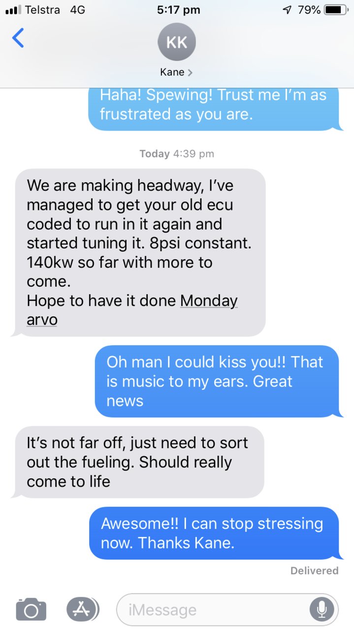

    But also note that if your host vehicle had the supercharger installed and flashed prior to 2009 there were different target id's for the calibration file. I'll see if I can dig them up. That means that if you had an early installation, then you may have a different ID that was correct at the time.
    The installation manual linked is dated 2014 so it only shows the updated calibration ID's

    Yeah if you could find those details it would help. Willing to try anything atm. Thanks

    Without looking I'm pretty sure the same for hilux and tacoma of course I would verify to be 100%. But since the 4runner and fj shared the same pin out with the hilux surf and prado and share the same ecu.

    It’s a bloody great end to a Friday!!
    It’s all working fellas!! I’ll attach the message I just got from the dyno guy...

    :fingerscrossed:. This is sounding like great news!

    Yep sounds like the trick. I’ll keep you all posted on the final outcome.

    Tell me about it! Thanks to everyone in this thread we finally worked it out!!
