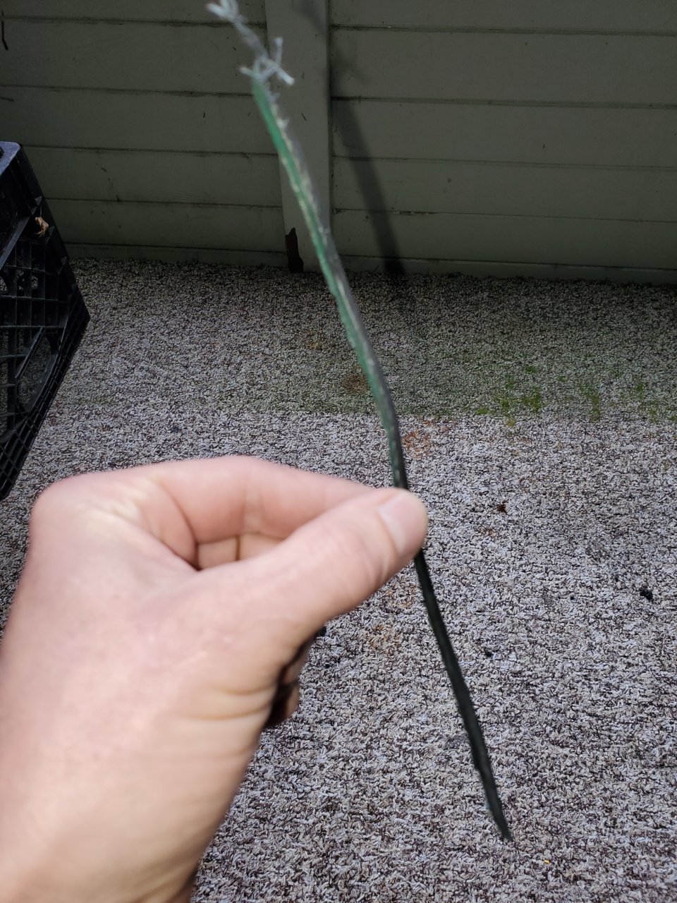

    think i just lost my s/c belt. ill investigate shortly.

    horrible noise after hard freeway romp and a sluggish truck home.

    No more whine?

    It sounds like that poor greenie was just getting way too much tension action. Time to switch to the RPM series. ;)

    ive got another green one here. rpm will be my next one. think i got 15k out of this one. got lucky. dented the oil filter and rubbed the dust off the electrical connector but no other damage to be seen.

    Sucks dude. Reminds me I gotta get a spare on hand

    yep. i consider myself very fortunate.

    I believe I have a cousin that runs her own mobile “tuning parlor”. From what I hear a lot of customers leave “happy”.
    I mean...too much coffee is bad for you. You’re welcome.
    RPM belt.
    Also, your grip on that belt looks awfully familiar.

    I’ve been there before. Make sure all the bearings for the idler pulley’s are good. Sucks having to unwind all that belt shred.

    i do have extra bearings. i found the upper smooth one to have a lot more rolling resistance than the upper grooved one. convienient thing- theres nothing to detangle. belt vaporized at 10+ lbs of boost.

    See, this man right here knows what it's all about, those "homie hook ups" are magical!
    I will now require the name of said mobile tuning service. For a friend of course.
    15K is hella pushing it! Whoa. Impressive nonetheless but it is likely with that sort of mileage the Roush just helped push it over the edge since it has a stronger spring than the OE tensioner.
    The only issue with the belt configuration is that the routing is done in such a way where if it was to snap it is incredibly close in proximity to the wiring and connector right next to it. It's a good way to wipe that out.
    If there is any question replace them for sure.

    I think you trimmed off too many ribs.

    do you need a press to get the bearings out of the idle pulleys? or hammer and socket?

    I used a hammer and socket approach.
