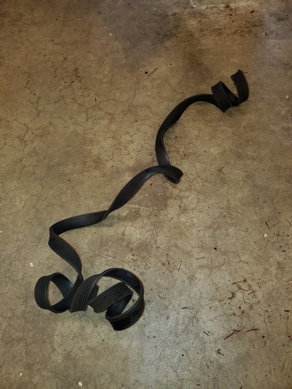

  14. Sep 8, 2019 at 9:07 AM
    zippsub9
    zippsub9 Well-Known Member
    Nov 3, 2014
    #141634
    4,573
    Halfmoon, NY
    14 DCLB
    Shit bolted onto other shit, and junk.
    @White lightning boosted make sure you check behind your pulleys for belt remains. I had the equivalent of bird nest wound up behind the pulleys on mine that I originally couldn’t see. Those ribs will split but not disintegrate and destroy bearings if they sit wound up behind the pulleys.

  16. Sep 8, 2019 at 12:06 PM
    White lightning boosted Well-Known Member
    Dec 30, 2017
    #239848
    8,273
    Jesse
    Poulsbo
    15' DCSB OR S/C
    Lift, pedal commander, led foglights, led interior lights, led back ups, led under lighting, urd tcai, led headlights, methanol injection, 76mm tb, hood struts, dif breather mod, ratiotek trans kit, x-series gauges, true cool trans cooler, belt wrap mod, 2.8 pulley
    my old serpentine belt:bananadead:20190908_114645.jpg
