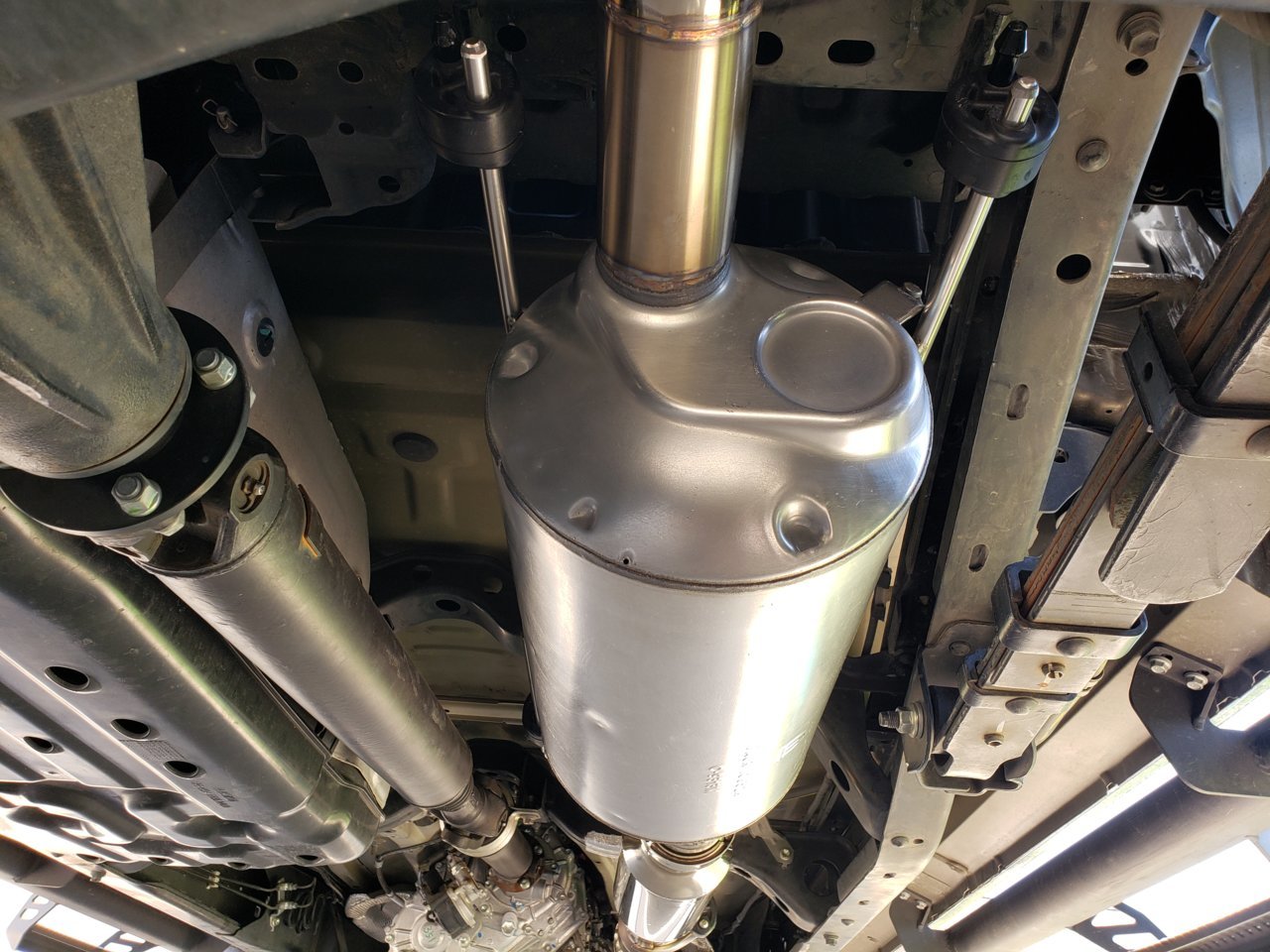

    So I ended up snagging one of these last night. Practically brand new. Going to work on getting it mocked up this weekend. Is it just the photo or is your slightly rotated from vertical? Doesn't look like the weep hole is at the very bottom?

    Just drill your own weep hole. Easy peasy.

    I was just curious if it ended up that way cause he tried to use the hangers that came on the muffler or if he had to twist the muffler a bit to get it to fit nice and snug in the space available.

    Rotate it as needed. mines on like a 10 degree rotation. I also cut off the hangers and welded on 1/2" rod that I formed with hammer and vise.
