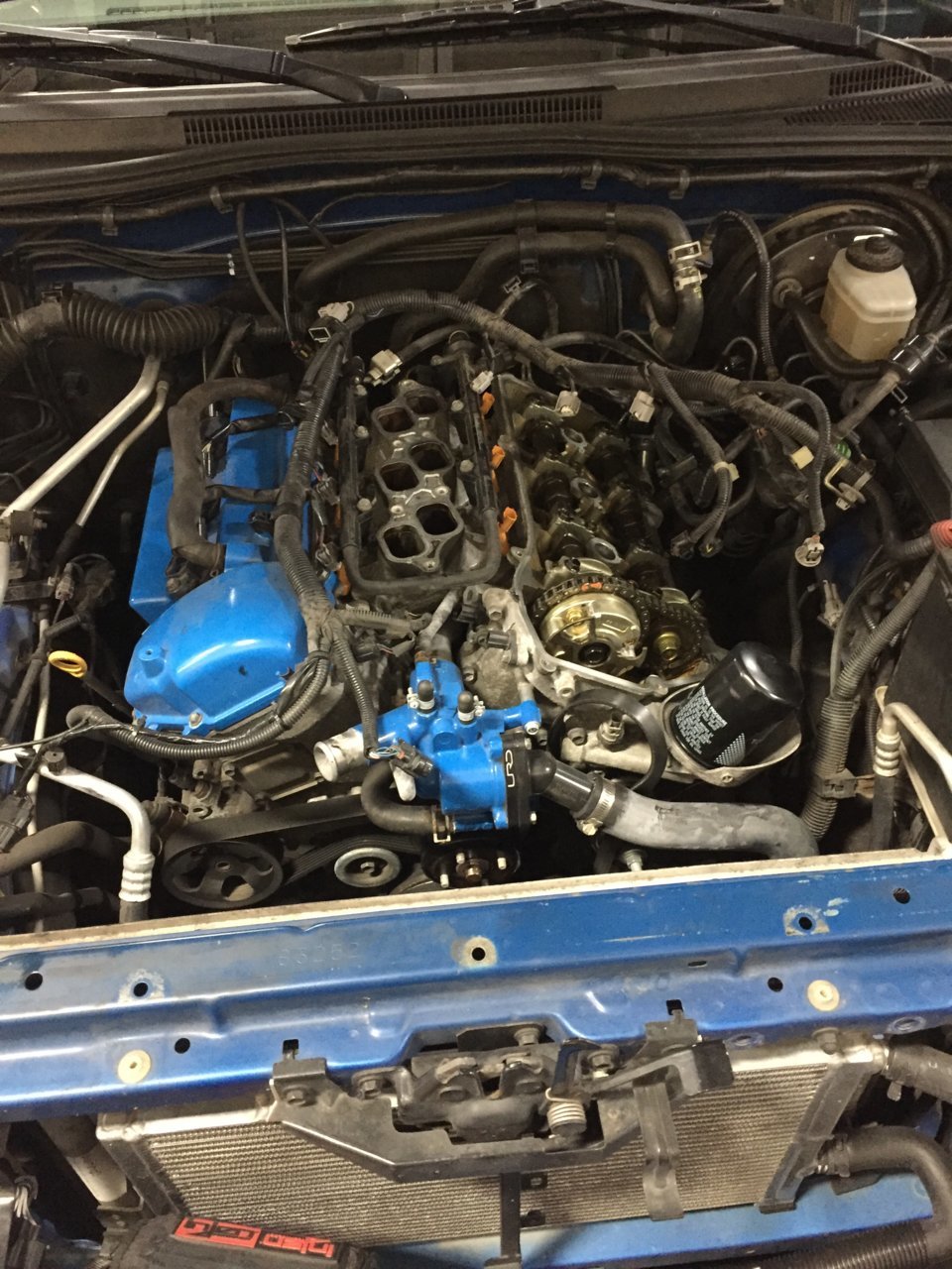

    Did the engine seize? Bent valve would be the first thought if the engine is not rotating at all.
    I haven't kept up with what is going on with your truck so I can't make too many assumptions until I know the full story.

    No it runs still. I drove it in. Not running great but it is. I watched the intake valves move fine.

    Is there excessive resistance on the crank while turning the #4 cylinder? Depending how many miles you have, I wonder if you need a valve adjust. Compression test numbers both dynamic and static as well as cylinder leakage % values?

    No not at all. There’s zero pressure when regular compression test. Was going to do leak down test but never did. I still can.

    Bend some valves?
