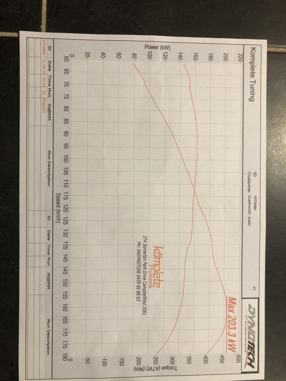

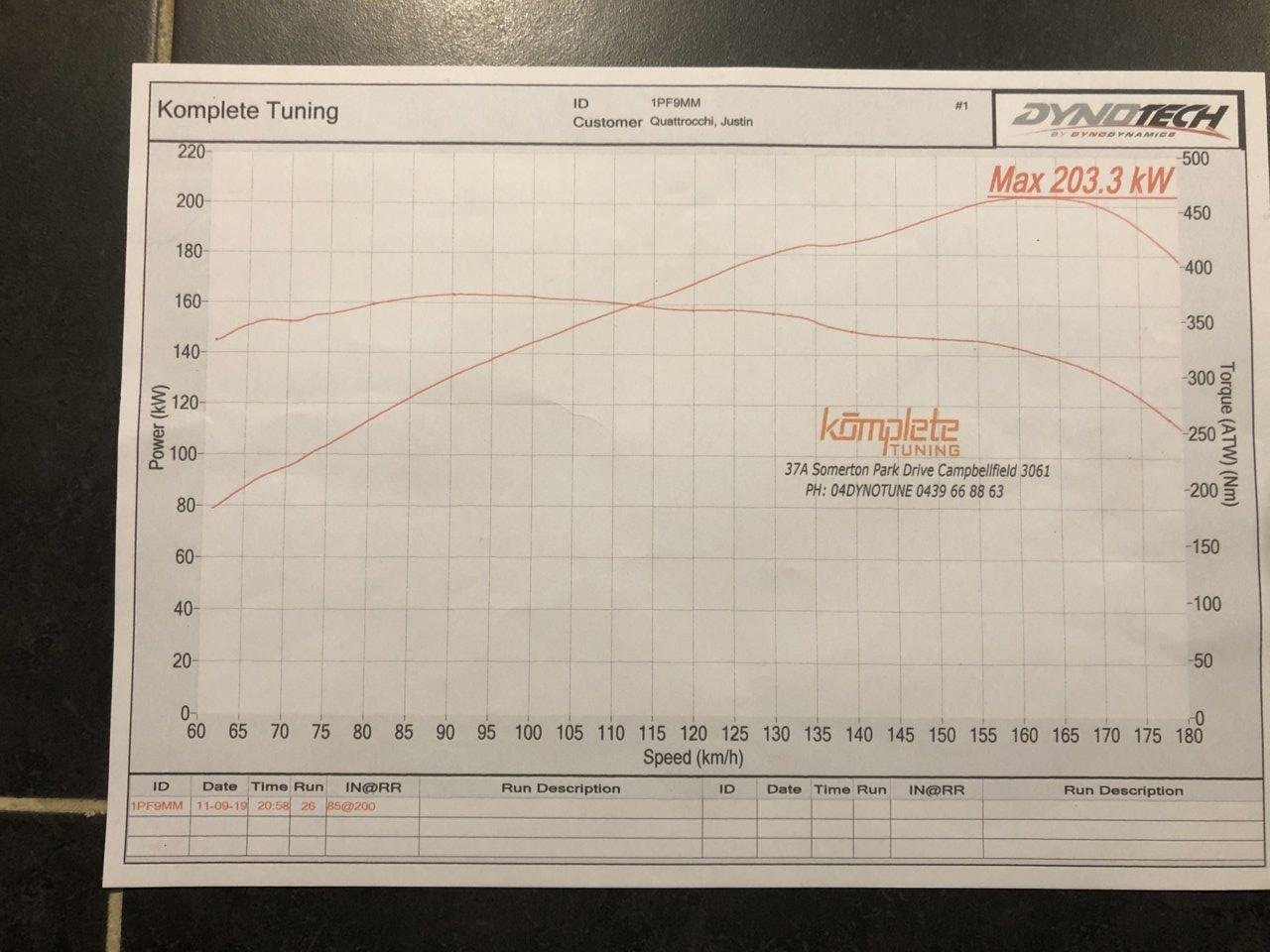

    The dyno is done...
    Following read outs are at the wheels...
    203.3kw
    370nm torque
    Also had LPG tuned. Runs bloody fantastic!!

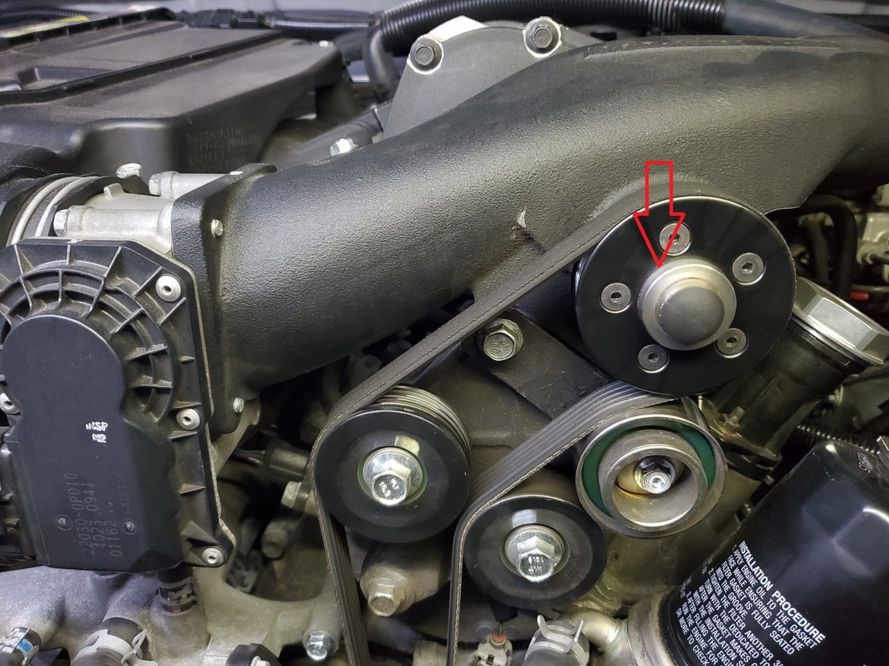

    On a quickchange pulley install, can I install it as a whole or should I install just the hub then screw on the pulley?

    Install the hub first. Attach the pulley after the hub is properly seated. (Note that the hub will likely have to be recessed behind the shaft's leading edge for the belt to ride properly.)

    You may recall, @JuanitoBunito, but I should have mentioned you'll probably need a couple of washers or a socket to seat the hub properly (i.e., past the leading edge of the shaft)...
