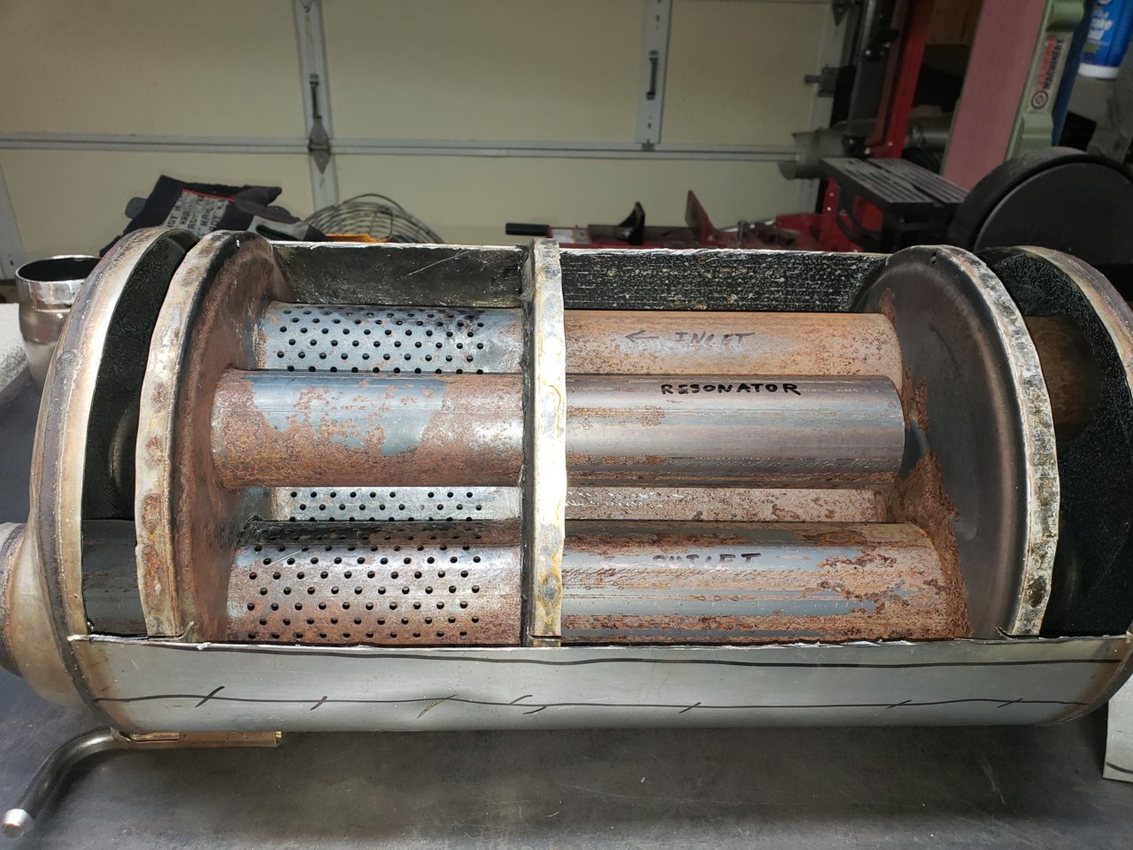

    As requested.
    The left side (with the perforated tubes) is normally packed with a fiberglass or similar packing. I removed it to see inside.
