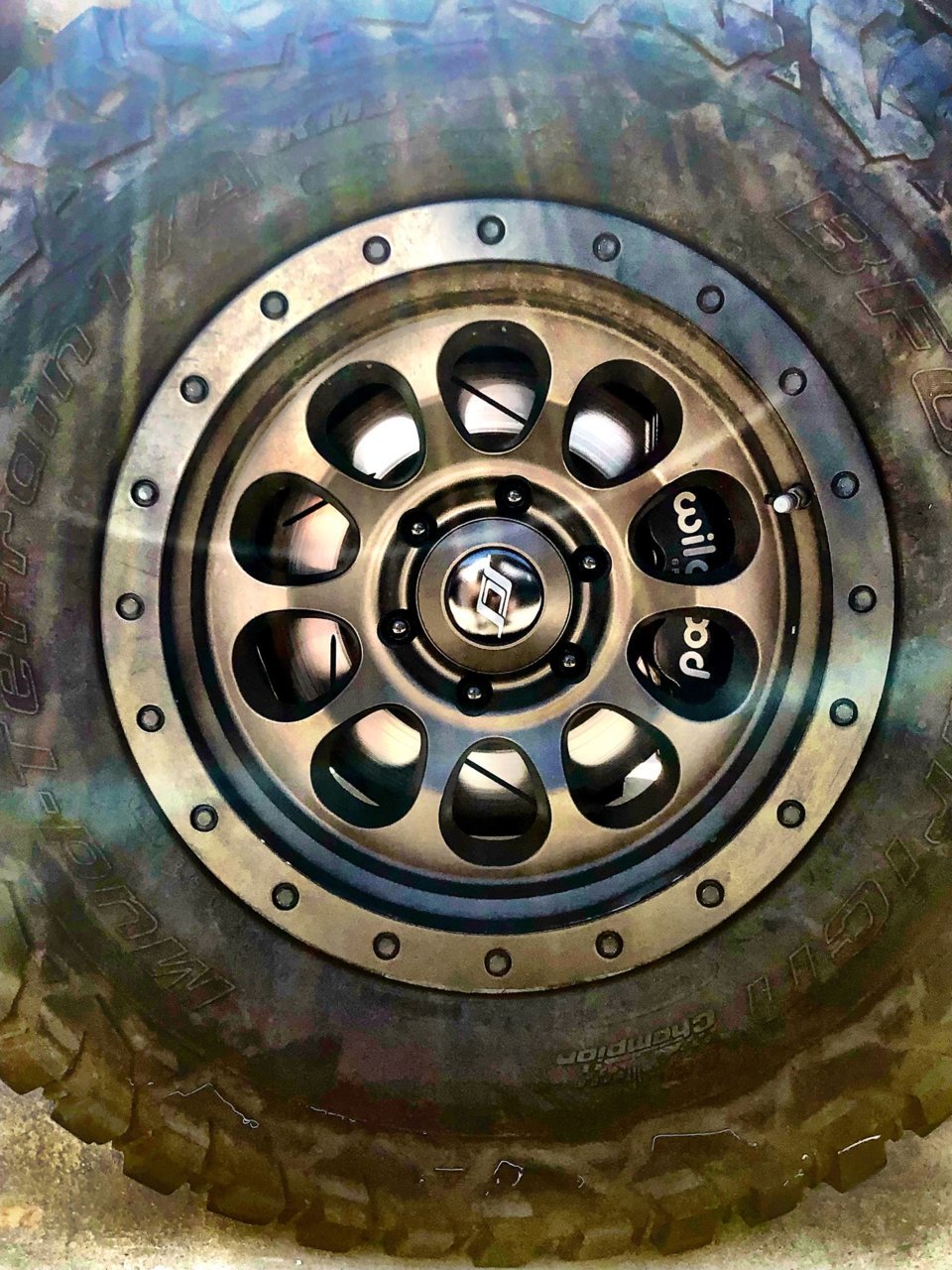

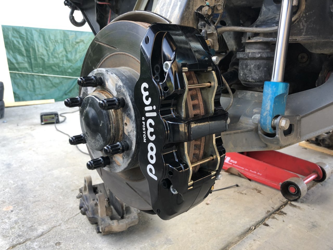

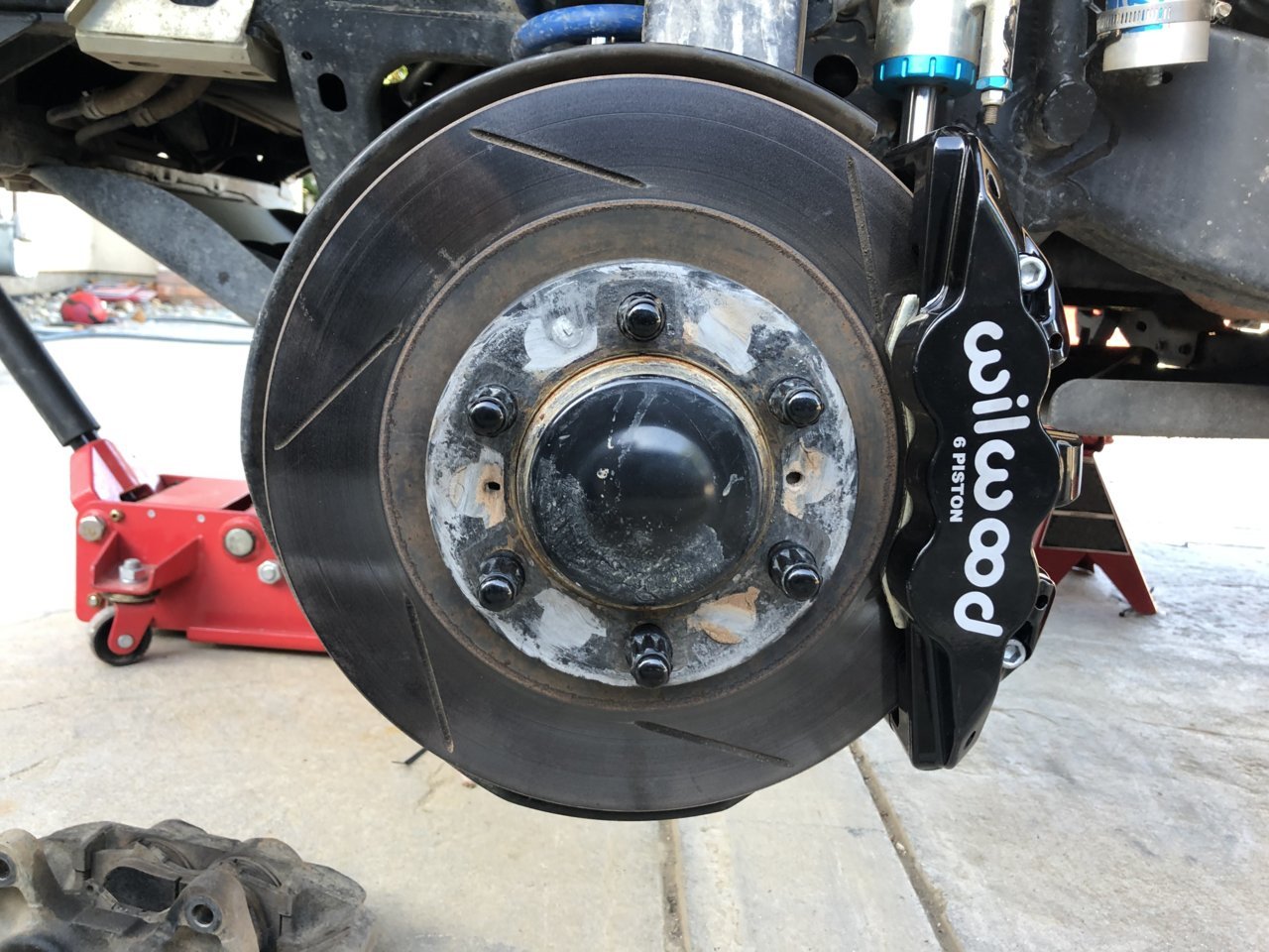

    yah, really want to install it and 2nd that 100% on running 35's. I just swapped in WilWood Aero6-DS 6 pistons Calipers up front. Just need to get a good bedding of the pads. I was mainly hesitant on the disc conversion since I can't add the sequoia master.
    New calipers on 5th gen T4R rotors (used to have that setup) have new dba rotors coming it are on back order.

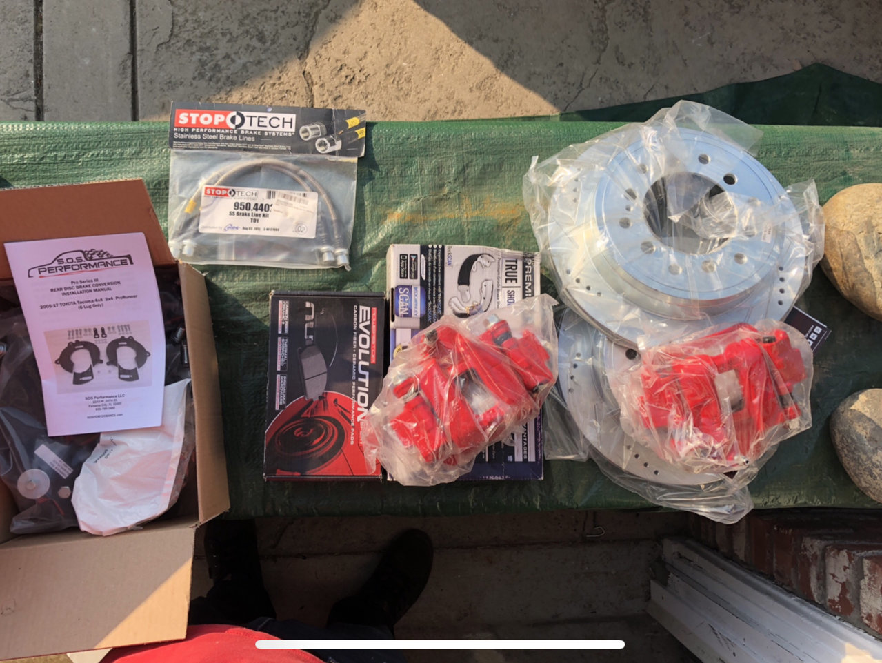

    Some fancy electronic one that’s only on the OffRoad and Pro models making it near impossible or not cost effective to replace ( honestly not sure there is one). How much softer was it without the upgrade master? If I can't update it I was going to look into the wilwood adjustable proportioning valve and see if that could be a possibility. Seen a few people mention that. I think the extra brake boosters in the offroad setup is what mixes it up some. It may already be a bit more powerful than the sport (honestly not sure) so may not be too bad. Its one of those once you start you can't go back without replacing the entire axle since you need to cut off some stuff to install or at least thats what I saw in the install notes.
    Did you install yourself? If so how was it?
    This is the kit. E brake stuff is in there somewhere but would have been good up to 2017 Tacoma so it’s fairly new.

    Same one I got years ago.
    I wonder if FJ/4R have electronic masters that are better proportioned for a rear disk with all those extra features.
    Regardless, it’s an improvement either way. Plus you can upgrade to the stoptech four piston later if you want. Take a sharpie and scribble out the stoptech tag.
