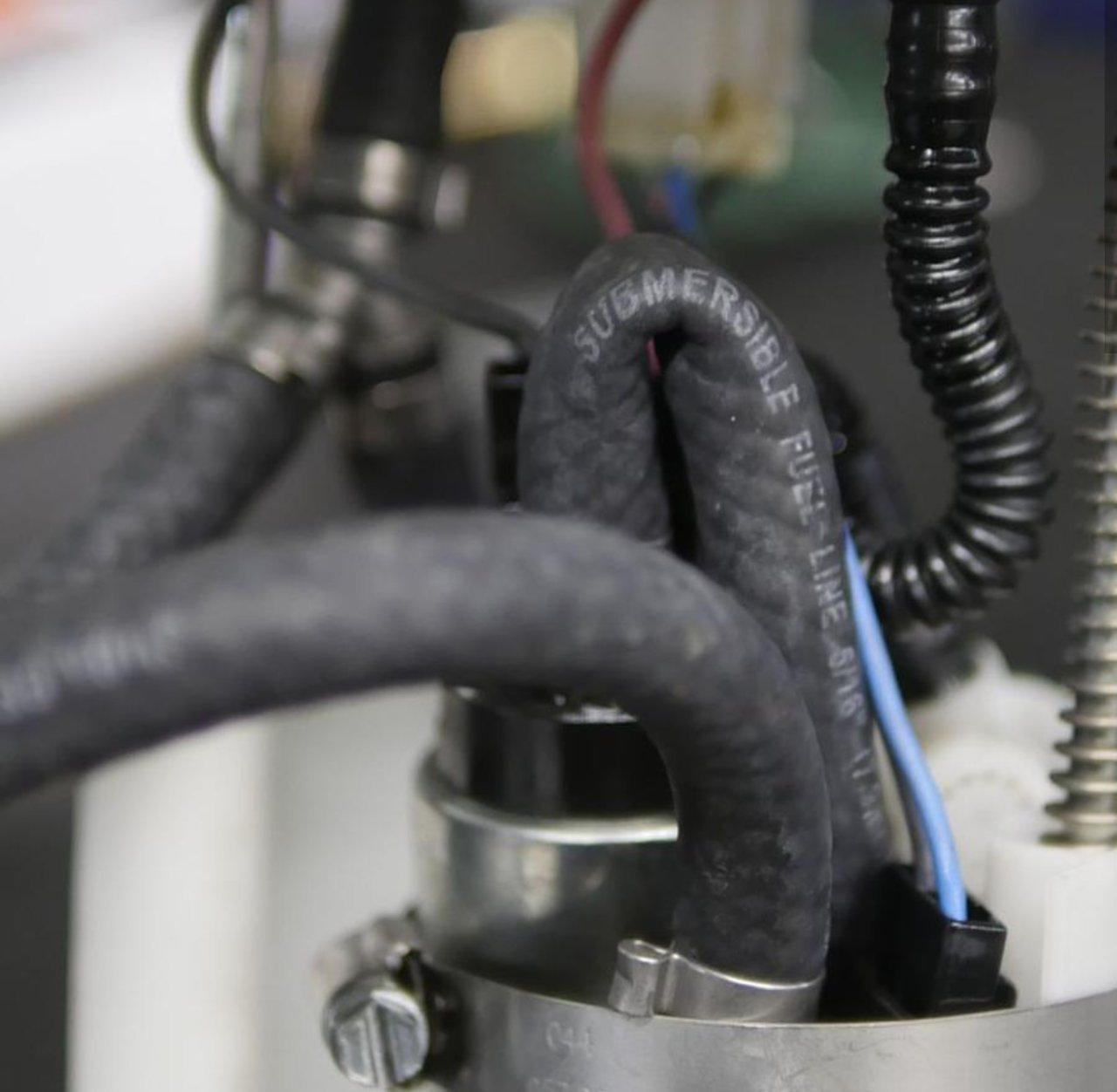

    I ordered the HPT MPVI2 and @JustDSM walked me through the process of modifying the BD tune. Unfortunately, this didn't fix the problem. I still got lean codes in banks 1 and 2. @JustDSM looked at my logs and found that my fuel trims were off by about 40%. I took it back to the shop and had them inspect the fuel pump and line pressure. Turns out the original shop that installed my SC kinked the lines from the tank to the motor causing a huge reduction in volume of fuel to my motor. Now that I look back on it, it seems almost obvious, but I guess that's hindsight talking.
    TL; DR: fuel pump lines were kinked causing all of my issues. Problem Resolved!!

    Wow, hopefully they also used the correct submersible fuel lines.

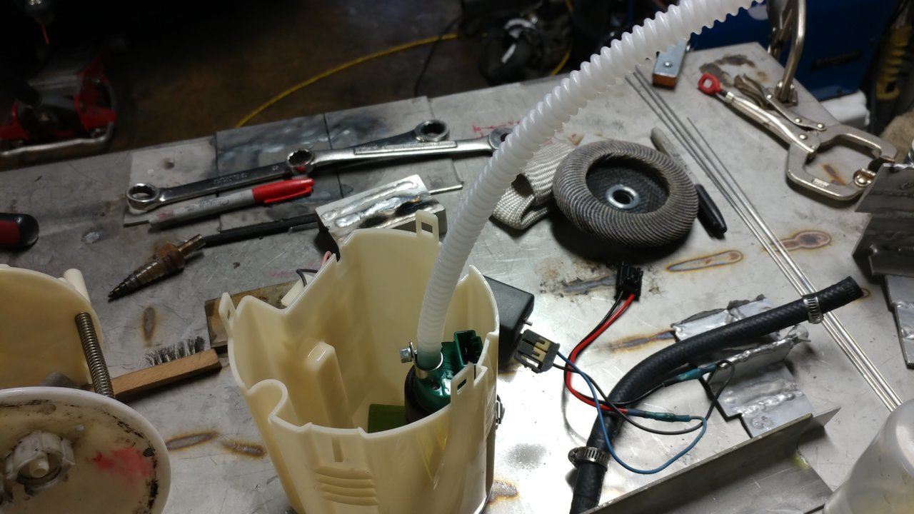

    When I have to remove my fuel pump again for whatever reason I plan on running a nylon line instead of the rubber one I am running now. Less room for error and eventual delivery line issues.

    If provided I like doing stuff right the first time. The radium stuff is great.
