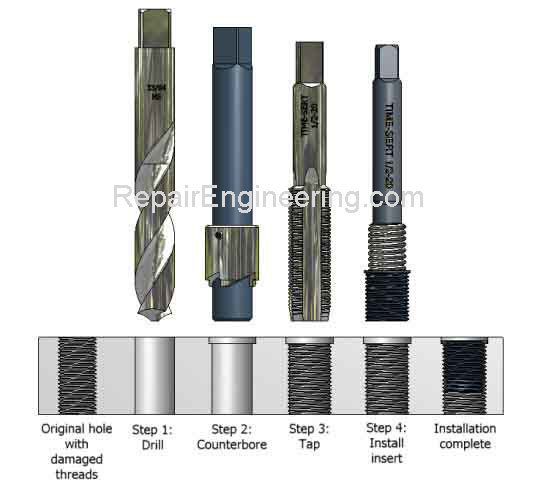

    I had quite the discovery last Thursday. Pulled the intercooler out of the housing to glue the seal back into place that I know was not fully attached. As I did it I noticed that one of the bolts was stripped out. I have noticed that ever since I installed the supercharger I have had a wet/oily area right above that bolt. When I installed it, I did so with a friend that was a master tech so I never thought anything of checking to see if anything was overtightened. But I am thinking it had to have been. So as I reassembled it I ran a very small bead of FIPG around the outside edge. Then on the tightening part two more stripped out just trying to get it down and compress the FIPG. So I have 3 bolts that are stripped on the housing of the s/c. Then towing my camper this weekend to Dillion, MT. I got myself an amazing 5.6mpg and could not get more than 1.2lbs of boost and that was just for a very short instant. So I think I know why I have never had the boost numbers that the others have, even at the same elevation. I am pretty sure I have been bleeding off the boost for a very long time. And I can say that I really like boost, cause towing without boost is very expensive! 92 miles to a tank of gas.
    I am planning on replacing the plenum gasket also just in case I have have had a good seal on the bottom side of the charger. And then I am going to helicoil the stripped bolt holes. Does anyone see anything wrong with this plan? Would love to hear some feedback. Also the 3 bolts are the top front 3 all in a row. The FIPG did hold for about 15 seconds getting on the interstate and got up to 4.4lbs of boost. More than I have ever seen here at this elevation. Also could explain the poor mpg's, the a/f sensors not lasting and the P0101 code that trips after about every long boost run while towing, and the fact that even towing I hang on 0.0 vacuum/boost for a really long time and would only go to boost if I basically floored it. Maybe? Does any of this make sense to anyone else? Am I making it all up because I want this to the be answer to it all? Thanks for reading and I look forward to hearing your feedback on this lovely little issue I have. Cheers.

    This is why it pays to use a torque wrench. If your bolts are stripped the oring can’t seal and it’ll never hold pressure.

    Literally fixing those same issues now. I have had stripped bolts on the intercooler lid for years (bought the blower used, years ago) and have re-sealed since then, a couple times, with gasket maker. It has held for the most part, but recently during some other troubleshooting (disappearing s/c coolant).. I went to remove the lid again, and between the stripped out bolts, and now stuck gasket maker, I am in the process of having a shop remove the lid and fix the stripped bolts. I mentioned Helicoils to him as well, which he said would work, but they had similar inserts that were supposedly better. Symptoms are the same as yours. Hoping to get it into the shop this week, once I slap the pulley's back on.

    If you think of what this other method of fixing it is, please let me know. Or @BillDaCat8 , if you get on and know what they are called, that would be great, as I am planning on ordering stuff tomorrow. I still haven't pulled a bolt to check the size and thread, but just guessing it is M6x1.25 because Toyota loves that size.

    Was he talking about time-serts?

    Time serts are a great product. Race teams will preemptively install these in aluminum parts that are frequently disassembled and reassembled.
    They come in kits. You drill out the aluminum threads, tap, then screw in the steel sert (that kind of looks like a pipe fitting reducer) along with an anaerobic glue, then you run another specially designed tap that spreads the fitting open for a snug interference fit.
    I helped do an entire Buell race engine. Tedious.

    I installed helicoils on almost all the bolts on top of my inner cooler. And they have lasted me over 10 years and no problems. Plus they can hold way more torque than the soft aluminum specs.
    Sure time serts are great too

    Beat me to it. I agree that time serts are far superior to helicoils. Have them on my dirt bike, that I beat the piss out of and they haven't failed yet.

    running helicoils on my intercooler too as one stripped on me.
