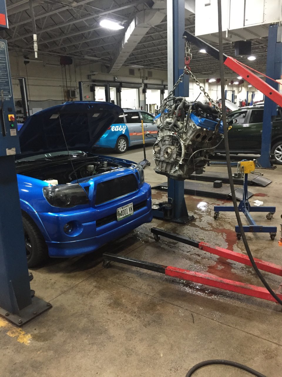

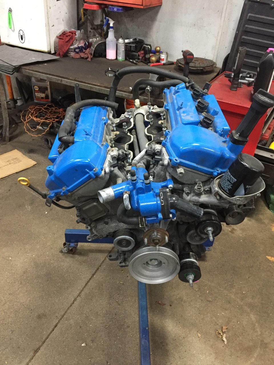

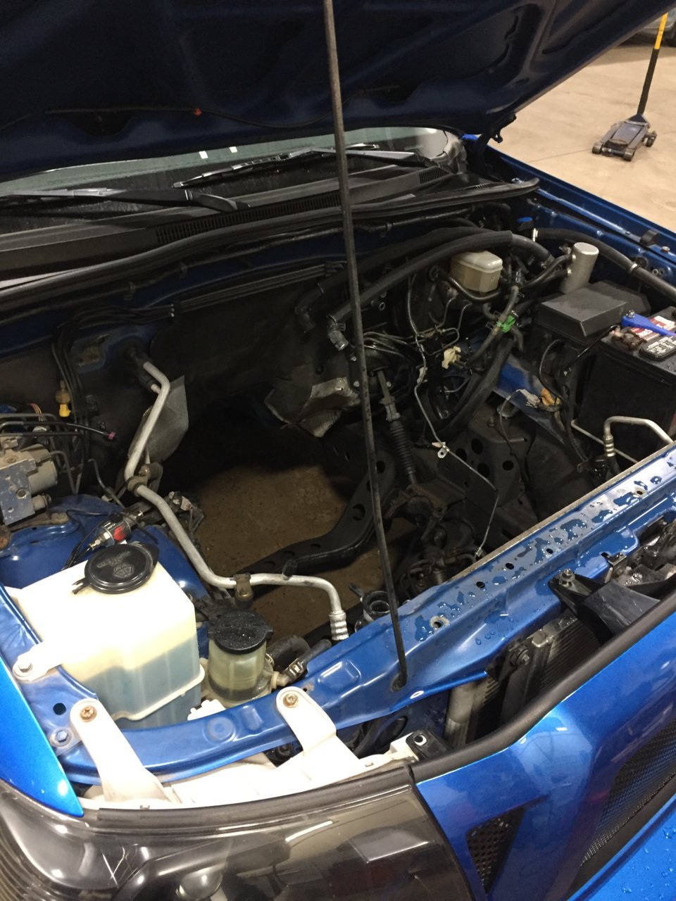

    Things are happening. 0064F4B7-2C26-411F-B976-75BC0B5900C3.jpgB1D6FADD-E45C-473D-9F4C-84EAA084C0F0.jpgB807F688-0AC6-463C-A1B1-E632F6FD19DD.jpg

    Engine is already out, might better do the stoker now!:D So what are ya doing? why did you have it pulled?

    Bent valve. Or something. Figured I would pull it. Would be easier working on motor. And thinking ls swap. I dunno. Got nothing but time.
