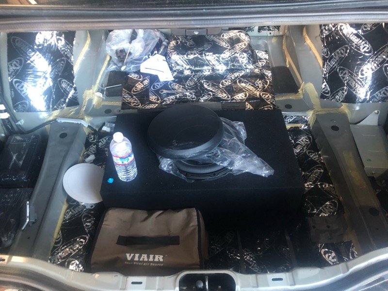

    Spare tire weight reduction guys! Also a change to the JL 12W6. Box is birch instead of MDF.
    Torspd and BassAckwards like this.

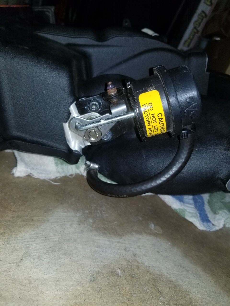

    There is just one vacuum hose. One side attaches to the bypass and the other to the sc inlet. Let me find a pic.
    Your bypass is spring loaded closed and should open quickly when starting the truck (like a half second).
    When giving quick hard throttle in park you should see the bypass valve actuator open and close.
    I know its frustrating but think of it this way, you have now finally realized there IS in fact an issue which means there is much power to gain when we figure out the problem.
    12TRDTacoma[OP] and BassAckwards like this.
  8. Sep 27, 2019 at 7:59 AM
    Roostfactor
    Roostfactor Well-Known Member
    Jun 2, 2015
    #156609
    3,885
    John
    TX panhandle
    2015 DCSB OR Pyrite Mica
    HPT/justDSM tuned factory ecu, URD Headers, JFR Y-Pipe/l 3" exhaust, Walbro 255 fuel pump, Maggy SC (JFR ported), JFR ported lower intake manifold, 76mm tb, 2.5 pulley, 640cc injectors, CSF Radiator, custom electric fan wit Autocoolguy controller, JFR SC pulley wrap mod
    Hope this helps.
    P.S. The sc is upside down in the pic.
    12TRDTacoma[OP] and mr.trd like this.
  9. Sep 27, 2019 at 8:05 AM
    Roostfactor
    Jun 2, 2015
    #156609
    3,885
    John
    TX panhandle
    The bypass valve is a simple spring and diaphram setup. Spring pressure forces it closed and intake manifold vacuum opposes the spring pressure to open the bypass valve in vacuum.
    mr.trd likes this.
