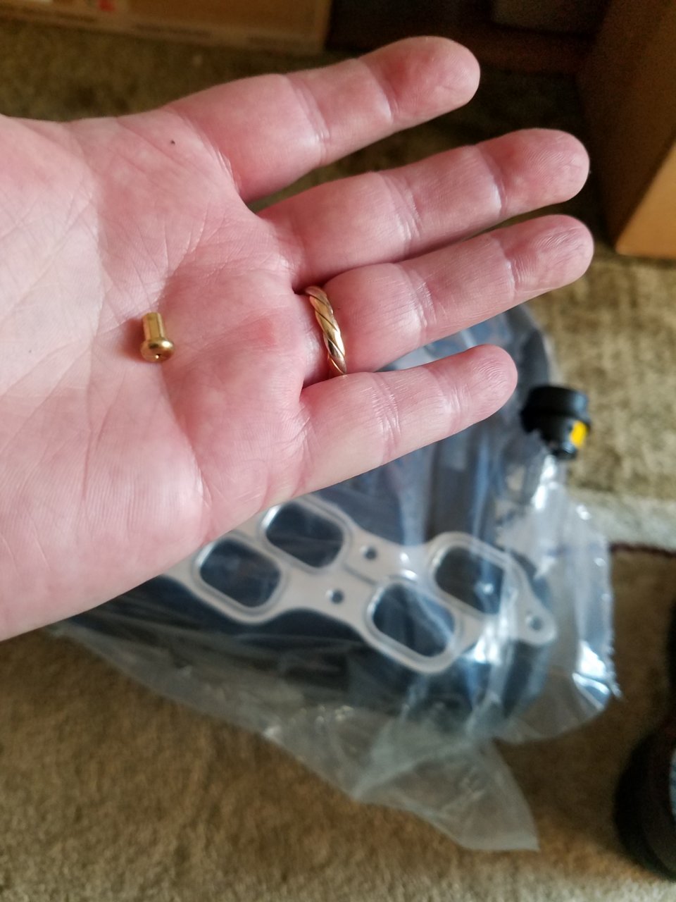

    Anyone have their ZZ coupler come apart on them?
    .....asking for a friend.
  13. Oct 1, 2019 at 7:00 PM
    JuanitoBonito
    JuanitoBonito Que Pasa
    Dec 29, 2013
    #119422
    9,203
    Juan
    CHI-TOWN
    2024 Raptor
    ......like break apart inside the blower?

    I have never heard of it, but figured for $10 for the Eaton one, I wouldn't chance it. I have way to "good" of luch with this supercharger.
