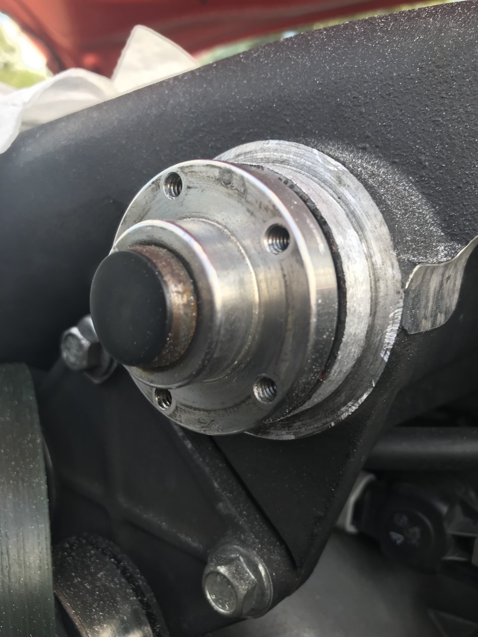

    No I'm running a 2.3. It always lights my face up when I step on it. :D

    so is it advised to run the jfr belt wrap with an rpm belt and 2.3? did you remove the hub to do further griding with your 2.3?

    I didn't remove the hub I just did some angled cutting with the Dremel at the very edge of my snout. It turned out good and hasn't caused me any issues since.
    I advise running an RPM belt and the Roush tensioner with a 2.3 setup. I don't advise an wrap mods unless you are running the oversized OE length 70.5" 5 rib RPM belt.

    Im running a 2.3 with the rpm belt and no wrap mods.. didnt have to remove the hub to grind it down further. I used a dremel as well like @12TRDTacoma and just took a little off at a time until the 2.3 fit good. I didnt want to remove the c-clip/dust seal thing, so i took my time

    my main concern was metal shavings getting on the seal and shaft damaging things.

    No issues here.. i didnt even cover up anything before trimming, just cleaned up the shavings afterwards

    So you didn’t wrap up your shaft?

    No sir, went straight for the massaging
