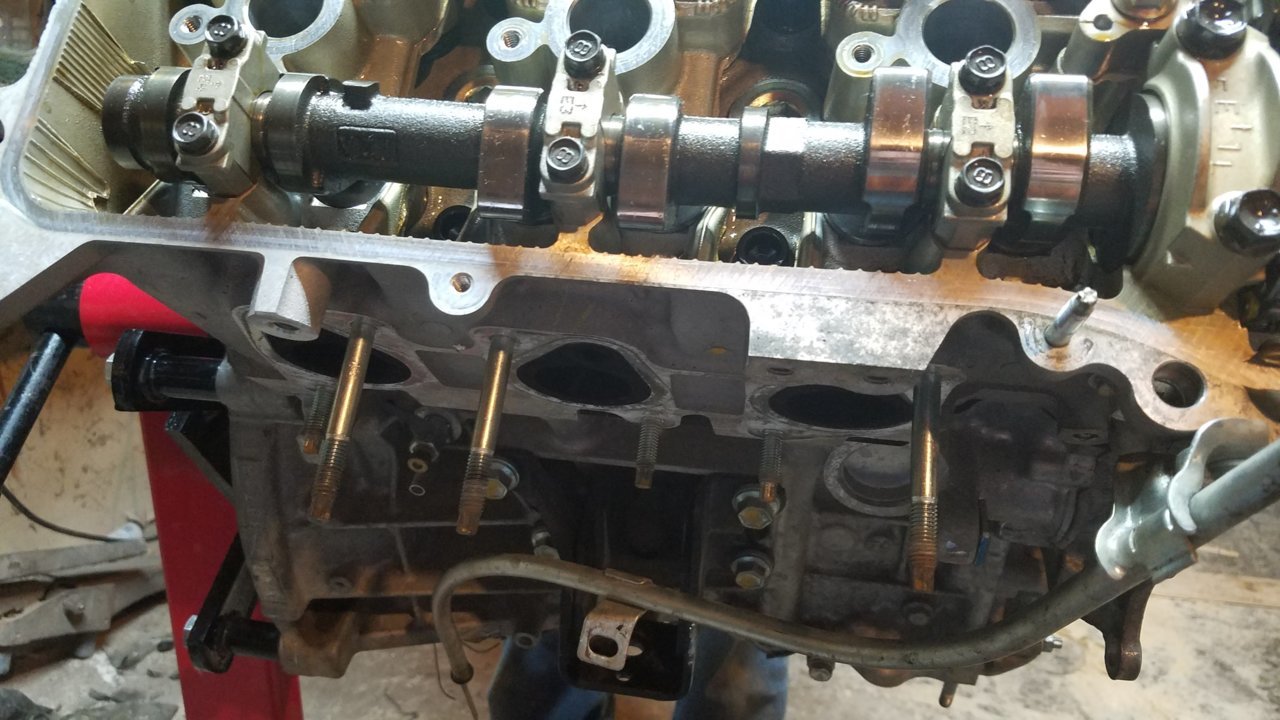

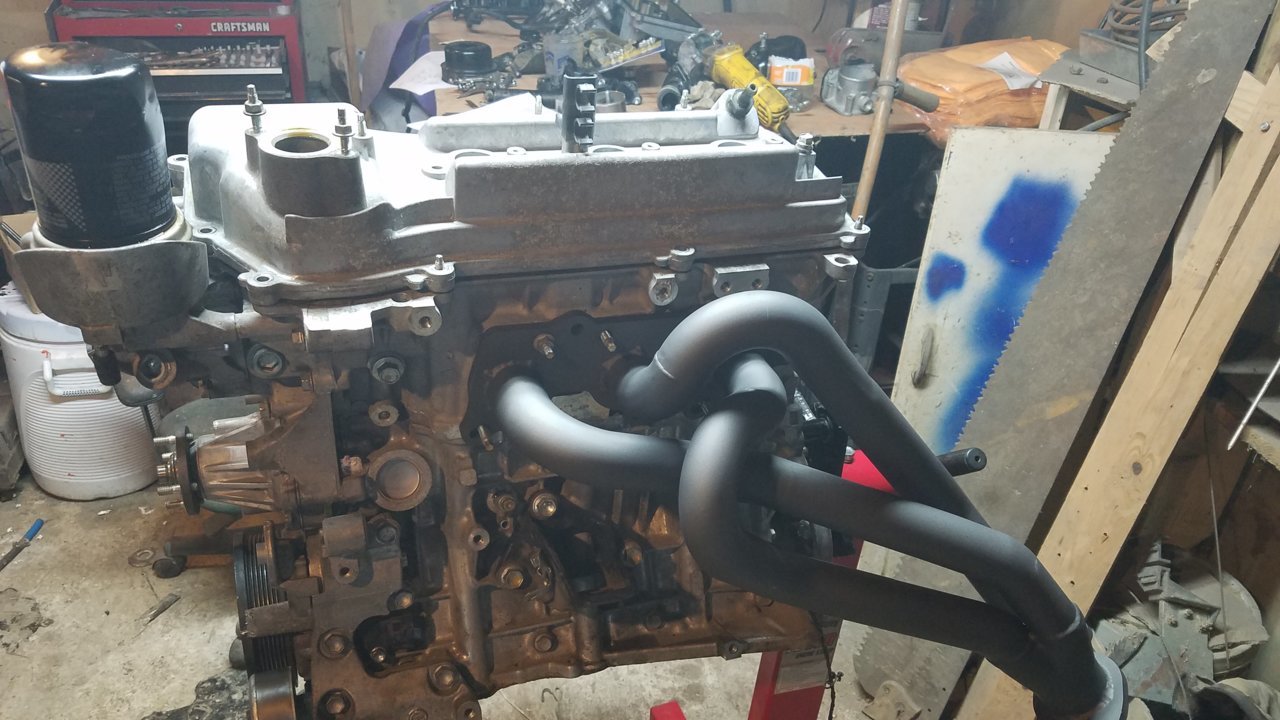

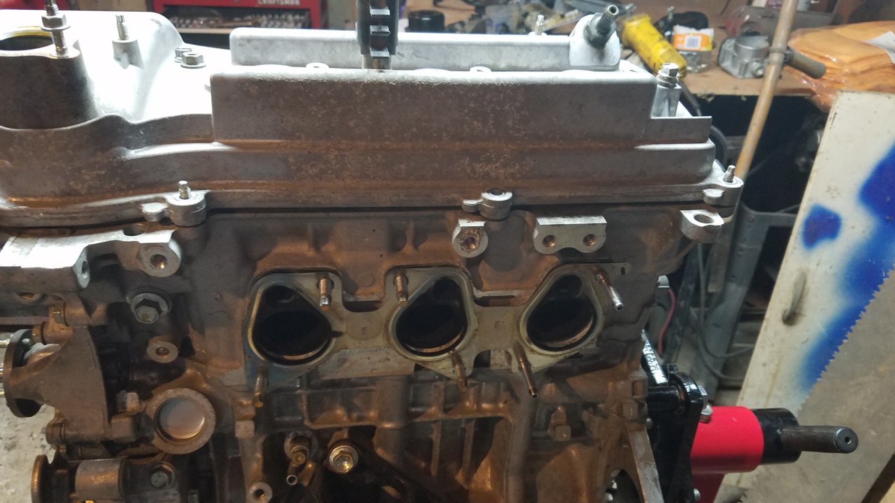

    To update this. Yes the 05-11 urd headers will work on 12-15 engines but some things are required including secondary air injection delete. After it's deleted, the long exhaust studs need to be replaced as they won't clear. The apr exhaust studs it's what I'll be doing to work around this. The header will cover the extra holes in the exhaust ports but a gasket to a 12-15 will be needed to prevent leaks.
    These long studs prevent fitment.
    Now it fits.
    Here you can see the secondary air exhaust ports. With a 12-15 gasket- they will be fully enclosed against the flange of the header.
