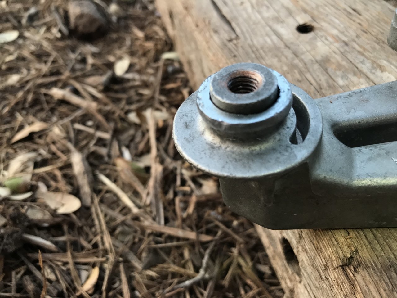

    So to clarify, when getting the Roush tensioner, we should also get a 50mm double roller bearing linked on page one? The bearing that comes on it doesn't fit properly?

    I agree, i just reinstalled the stock tensioner. Gonna go for a test drive here in a bit, but alignment already looks better

    What about the stock one? Can’t you just swap them? Maybe I misread the previous posts. Does the stock pulley on the roush tensioner is not properly aligned?

    Thats the case with my setup. Running the stock tensioner pulley on my roush

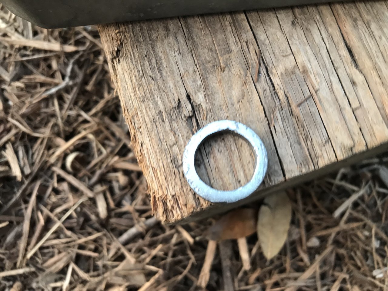

    Working on making a custom spacer right now to get things back in line

    Just did this today when swapping in the 2.5. Installed rousch tensioner with stock pulley. I first tried the 69.5" belt but it was too tight and the tensioner had too much preload. Put the old belt back on (70.2) and it was just right, slight preload on the tensioner. Very little if any misalignment.

    So here was my solution.. took a thick grade 8 washer and enlarged the inside of it and then ground down the outside of it with a dremel so it would fit between the stock idler pulley for the tensioner. Put this spacer on and used the longer bolt that came with the Roush on the stock tensioner pulley. The belt was riding about and 1/8" off of the idler before the spacer and now its back on the pulley and lined up nice

    Do not space it out much further than that. Remember that sleeve that you put the washer around secures the bearings inner race. You want that inner race held down and secured tightly. The bolt helps that to an extent but the sleeve itself is the other side to that coin as far as support goes.

    Theres just enough of that race still sticking out to keep it centered i think. Im gonna leave it right where its at and see how it does. Fingers crossed this is all it needs

    I would personally run that temporarily and run a double roller as soon as you can. You will notice an improvement in the switch. Between the upgraded tensioner and the upgraded roller I found a notable increase in boost holding stability while at any particular range in pedal position while in boost.

    Im fairly sure id have the same if not worse spacing issues with the double roller. Since i just replaced the all the idler/tensioner bearings today, im gonna run this for a while unless it fails for some reason. As easy and cheap as those tensioner bearings are, ill just swap em out every 10-15k so i am less likely to have issues. after 25k most of mine were hard to turn so it was time for some new ones
