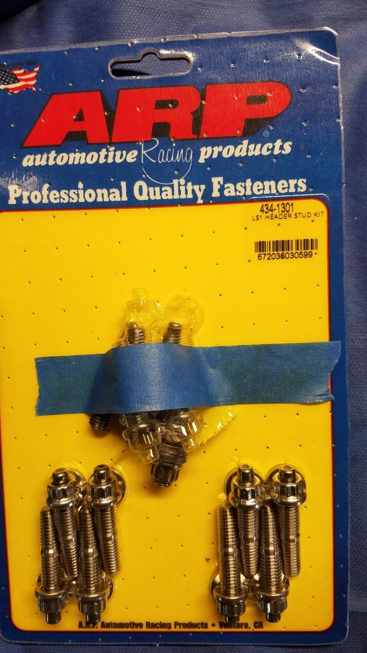

    Which Apr studs? Got model # or specs handy?

    You'll most likely want to tap the holes again. From factory they fit extremely tight and the apr studs will not fit well. M8x1.25. Either the factory block is heated prior to install or the factory studs are cooled.

    Did you use helicoil or time-sert or other brand? Or just straight up drill and tap?

    I think there are earlier model years that are like that.
    My old ones came out, and those same ARPs went in without issue.
    I used heat and wax to get them out with none of them breaking off.
    This thing helped a lot.
    Shop Iron 16023 3/8" Drive Stud Extractor https://www.amazon.com/dp/B00265M8N4/ref=cm_sw_r_cp_api_i_oUKMDbN1H7WQK
