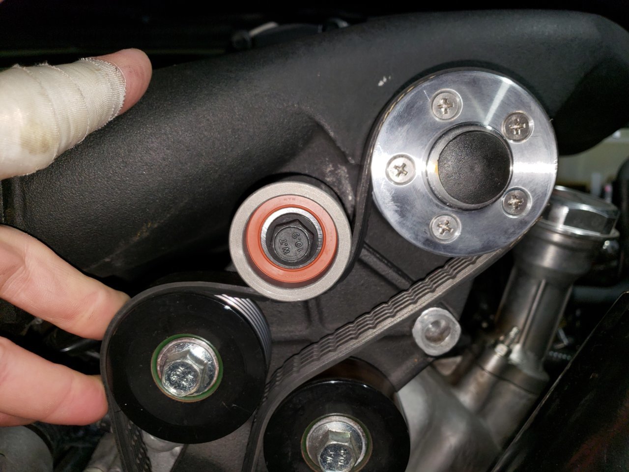

    At the request of @BillDaCat8 I am posting this here. Also for @12TRDTacoma to add part # 99421 to the billdacat8 wrap mod. It is a Cloyes brand idler at Rockauto.
    I just installed a 2.3 pulley with a stock 70.5" Gates RPM belt and an M8x60mm grade 10.9 flange head bolt.
    The tensioner is perfectly adjusted and wrap is where it really should be.
    I may go back to the stock (non Roush) tensioner now to alleviate extra stress as the extra belt tension (I dont think) is needed due to the extra wrap.
    I fully agree with @12TRDTacoma on this one! This is the belt wrap to run with a 2.3 pulley! Great work @BillDaCat8!
    The only thing I dont like is the 60mm long bolt going into maybe 1/2" thick aluminum threads which puts a huge side load on the bolt/idler. I may fabricate a brace to reduce the side loading.
