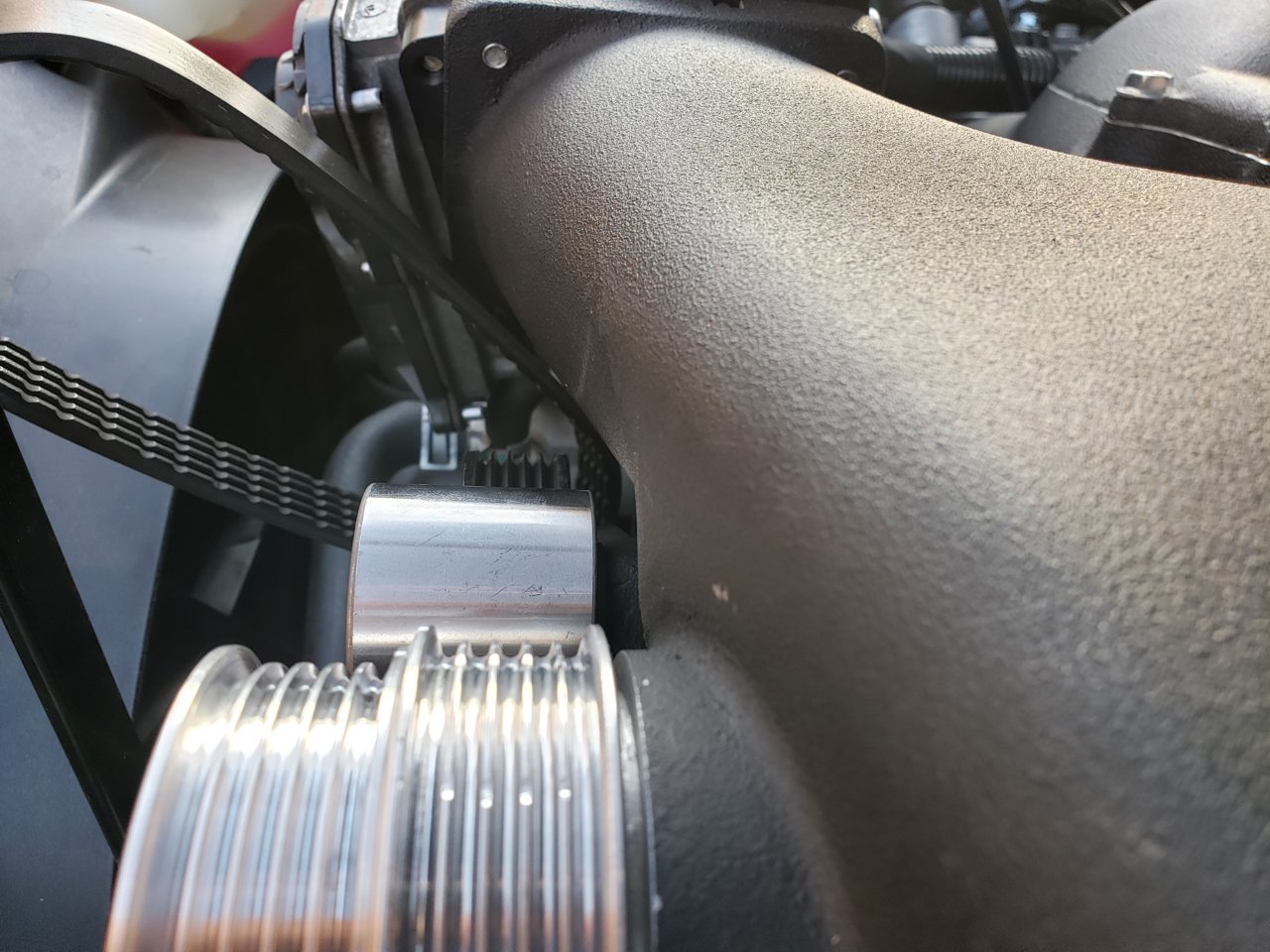

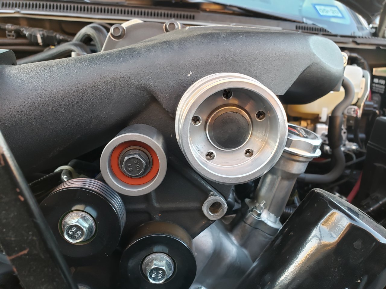

    A couple more pics.20191007_184903.jpg2.5 vs 2.3 with @BillDaCat8 mod.

    Now to tune. Definitely lean on top end now.
    I set up FPR and now time to tune for it.

    Would that wrap mod with the 70.5” belt, 2.5 pulley, and Rousch tensioner work ok?

    With this new pulley you did not need to do any additional fab to the pulley? @BillDaCat8 audi pulley required that you machine it to work. If we can do it without thats a big plus.
    Would you go this route and for the 2.5? with similar belt?

    Beat me to it. Exactly what I was focusing on as well.

    Very nice John! :thumbsup: I have some update work to do on page 1 as of recently!
    I would feel comfortable with running a Roush with the wrap mod, the 2.5, and the 70.5" belt

    My work is gonna get done tomorrow. When the cutting starts, did I see somewhere that there is a specific line to cut to. ....for a 2.7 if it matters.

    I cut mine to the start of the silver line in the OP in here.

    With the wrap mod you stated you did not need to machine it though right? that was one part that limited me form @BillDaCat8 's mod due to access to do it. one of the things holding me back from the 2.5

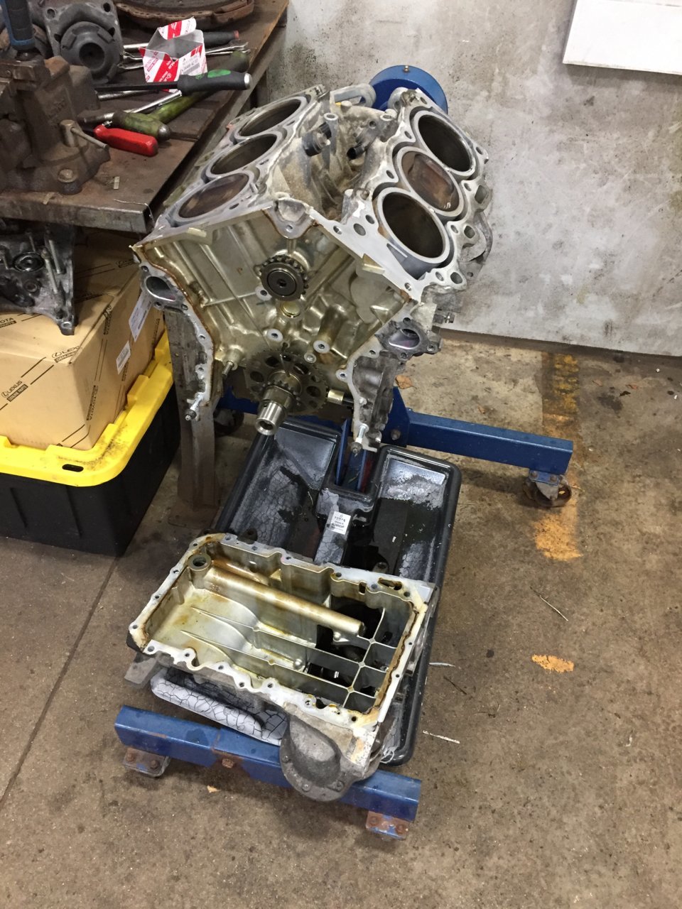

    Almost apart. Pistons and rod will be coming out tomorrow. And ordering new stuff.
