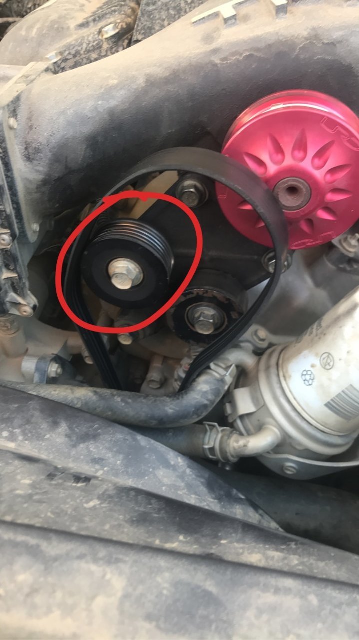

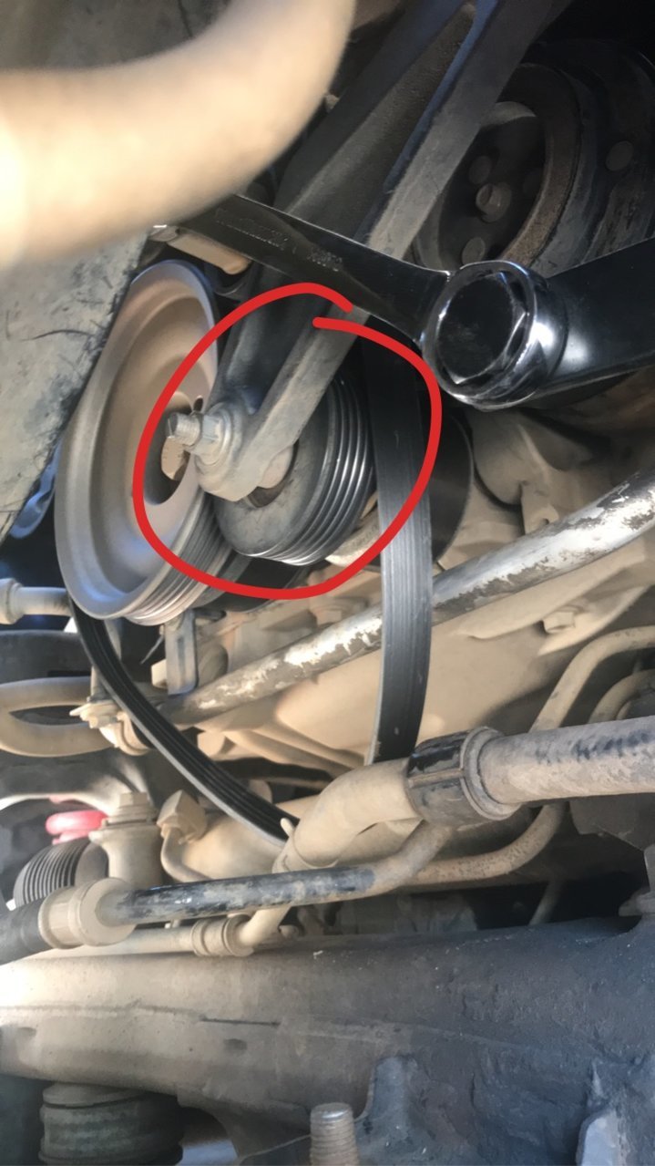

    Anybody know the part number for these two bearings? Please and thank you

    I’m not seeing it

    NSK B17-102DG3
    47mm od
    17mm id
    14mm width
    Timken in the OP: 6303-2RSC3

    It’s the same bearing for both pulleys?
