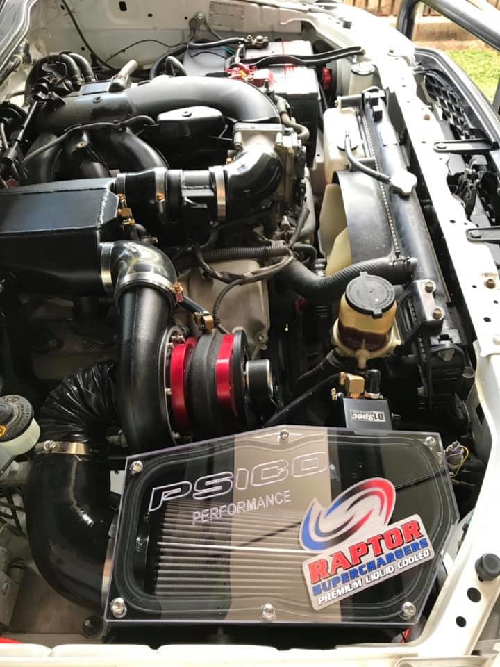

    Raptor Superchargers..
    Anyone see these before? Centrifugal setup with Air/Water IC and it's only $3500USD with a reflash included (Thank you US:AUD currency rate)

    Looks kind of like the MK1 kits. Is it a Rotrex?

    I wonder at what rpm their getting their results at.

    Nope, appears to be a AUD mfg. making their own SC. I thought the same thing re: Mk1. Also thought it was a Rotrex when I saw the thumbnail pics. After visiting their site, apparently they mfg. the SC.
