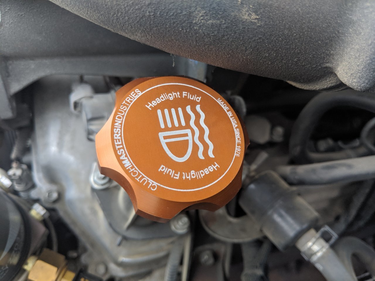

    Spec stage 3+ and clutch masters hydro bearing (with billet oil cap). Urd lightweight steel flywheel and equal length headers (the older version) coming tomorrow!

    I’m thinking spec is the way I’m going when the time comes. Stage ll though. Did you get it through URD when you got the flywheel? Last pic, is that an oil cap??

    Last pic is indeed an oil cap.

    That’s awesome. Is that custom or did you just buy it that way? So the clutch comes with an upgraded throw out bearing and you just got a light weight flywheel?

    There was a group buy recently for the hydro bearing which should cure the throw out bearing issues with our transmissions. I believe they are running a second one and/or clutchmasters may become a Tacomaworld vendor. The oil cap was a freebe with the group buy although it sounds like they'll start selling them separate. They did custom designs and a number of color options
