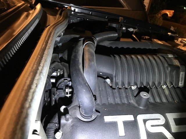

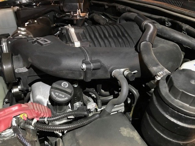

    here’s some photos - anything look wrong (besides the pulley not being smaller)?

    Did you check intercooler reservoir?

    Yes, it’s good. Checked flow too.

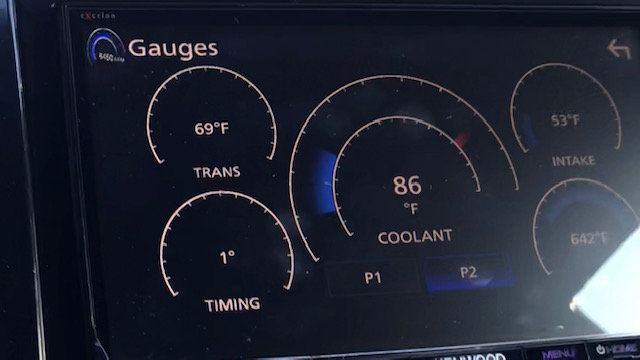

    The maestro is not a good indication of air fuel ratio because it is utilizing the OE sensors through the OE PCM which tops out right around that amount. You need a reliable AFR gauge and a boost gauge to really figure out what is going on. A blower equipped CA without either of those is just asking for problems.

    Still dogging it this morning, checked timing at WOT and it's a 0* +/- 2. On another thread guys were saying they're at ~12. Does this look like my engine is pulling timing likely due to low octane?
    4500' elevation if that makes any difference. Again, all stock TRD sc setup except for AFE intake.
