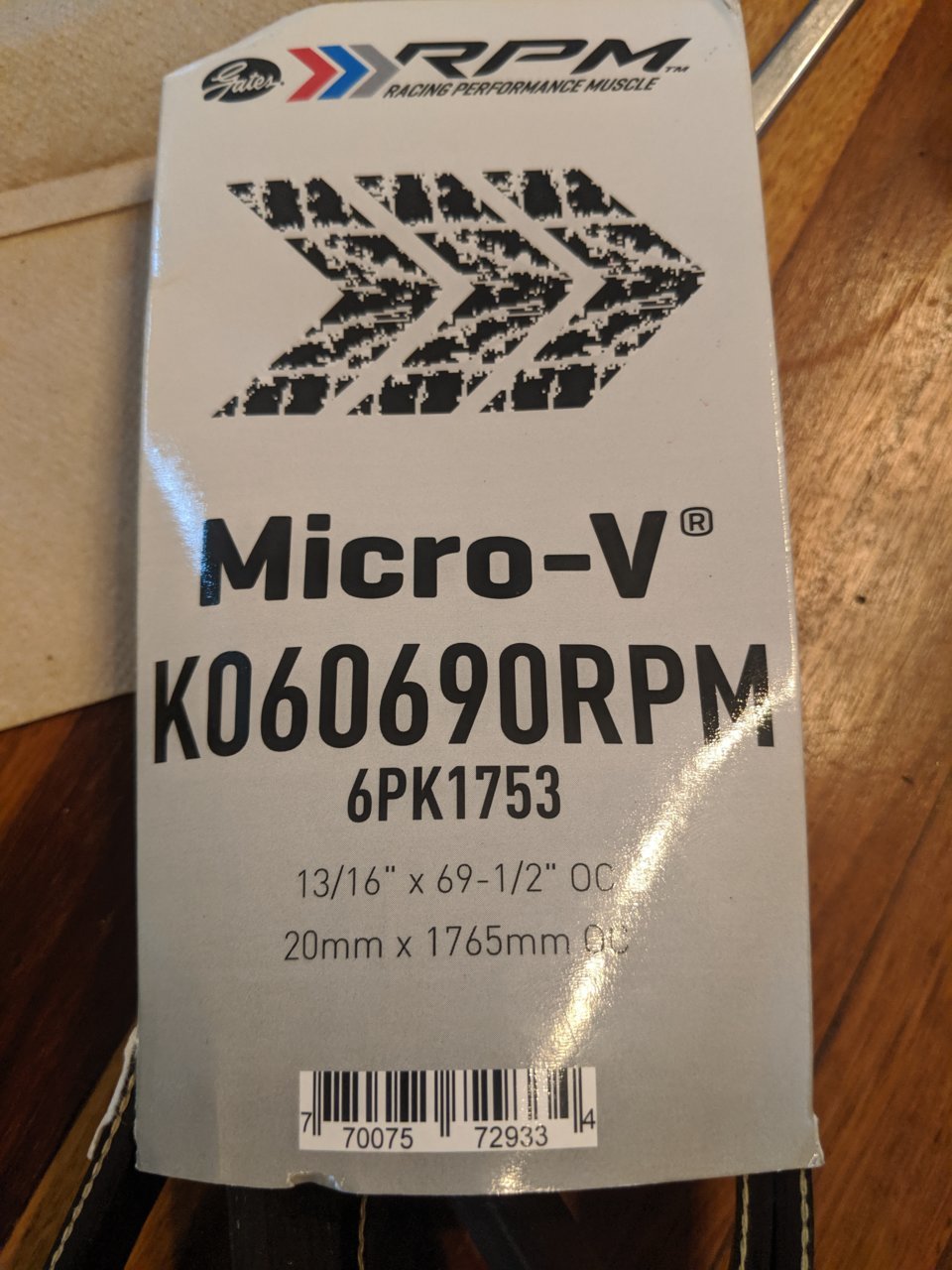

    Front page says K060690RPM is 69" but I just got one and the packaging says 69 1/2". Although it says OC.... Outside circumference? Just a heads up.

    You do know OC stands for "outside circumference" and what is actually important regarding belt lengths are the "effective length" right? :smack:
    It is a 69" belt as page 1 states. :cheers:

    Hence the question mark.
    I am not belt yoda
    :cheers:
