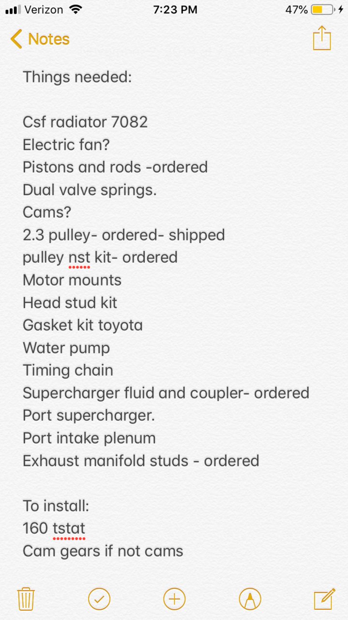

    71AB421A-B75F-491F-BAF3-5CA35114FFC5.jpg This is my list so far. Let me no what else I should/need to do while motor is apart and out.

    solid motor mounts??
    say, if youre doing an electric fan have you considered making a used lexus one work? when i do one ill use a lexus unit. 2 reasons- factory toyota part, and factory toyota part.

    Going with stock pistons and rods?

    Yeah guy on here makes them. I dunno about electric fan option. I might just buy the kit. I forget who makes it.

    No sir. Brian crower rods with coated cp pistons 9.5 compression.

    keep us posted on a rad kit.

    Yeah where’s the build thread? Gonna need a reference for when I blow mine. :D

    Here's my timing chains parts list:
    • Chain sub assembly: 13506-AD010
    • Chain sub assembly: 13507-AD010 x2
    • Larger Damper, chain vibration: 13561-AD010
    • Smaller Damper, chain vibration: 13562-AD010 x2
    • Slipper chain tensioner: 13559-AD010
    • TENSIONER ASSY, CHAIN: 13540-AD011
    • TENSIONER ASSY, CHAIN: 13550-AD010
    • TENSIONER ASSY, CHAIN: 13560-AD010
    Probably not going to change crank/idler sprockets. Still undecided on cam gear retards vs new cams from Kelford (probably the latter).
    Probably a good idea to replace your supercharger silicone foam seal while tinkering in there (couldn't tell if you had this listed)
    https://www.urdusa.com/magnuson-rep...al-intercooler-core-4-0l-supercharger-system/
    I've also ordered the idler pulley bearings mentioned in the OP.
    Good luck!

    While you got it apart, new belts.

    I’m going to just be getting a master gasket kit from toyota. Going to replace crank bearings this week. My serp belt is pretty new only has like 5k on it. I also have a brand new knock sensor harness that’s going in. Nothing really wrong with mine but if you have ever had to do one they are a pain. Also got the 650 injectors to install. Almost forgot.
