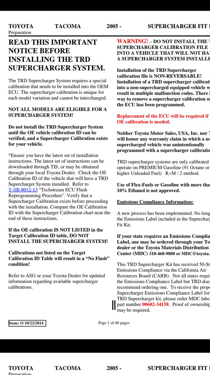

    Just placed this order today:
    Magnuson SC - no tuning
    2.85 pulley
    URD deatchwerks fuel pump kit
    DT Shorty headers
    URD Competition Ypipe
    AFE 2pro dry intake
    Need to order:
    Speedhut boost and AFR Guage
    Vibrant hi-flow cats
    My OVTUNE handheld is waiting on ECU setup.
    Question - If I get everything installed before my OVTUNE is ready, is it safe to crawl the truck at low speed/rpm to my dealer about 25 miles for the TRD flash?

  11. Mar 23, 2018 at 10:35 AM

    Would I do it? No. Have people done it? Yes.

    Are u sure they will flash the truck?

    Both dealers closest to me said they could do the flash. Quoted $110 and $185
    If I'm lucky, OVTune will have my ECU setup before I install the SC and I won't even have to mess with TRD flash ...just exploring my options

    I drove mine 14 miles, just stayed out of boost.

    Yup, just stay out of boost...

    Apparently the dealers still have access to the Tech Stream reflashing program and TRD SC calibrations

    Of course, it’s running rich without the TRD flash, but not rich enough if you boost it, like said twice. You can drive normally.
