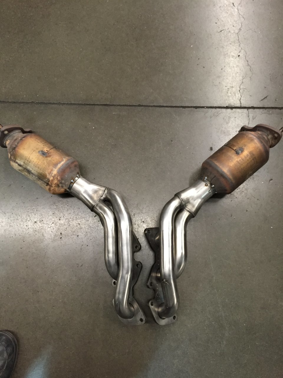

    I have them. Welded my stock cats to them. They work. Been installed for roughly 30k. No issues with them so far. I’m not crazy about the alignment of the primary with the exhaust port on the two rear most cylinders tho. It’s kinda off a bit. I also found them to be about 3/4” too short when I initially installed them. Had to extend them a bit. Easy fix for me, but might be an issue for those paying someone else to install them.
    Pic was taken after I’d fit up and tacked it all together. I took them home afterwards and welded it all up. Welding stainless properly requires filling the tube with an inert gas to prevent sugaring of the weld.

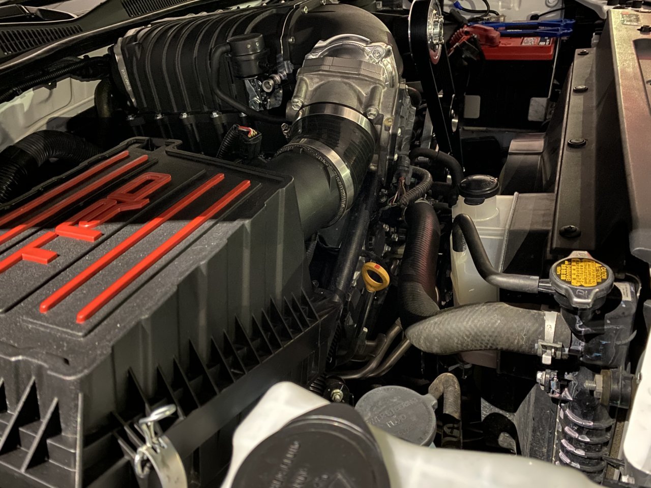

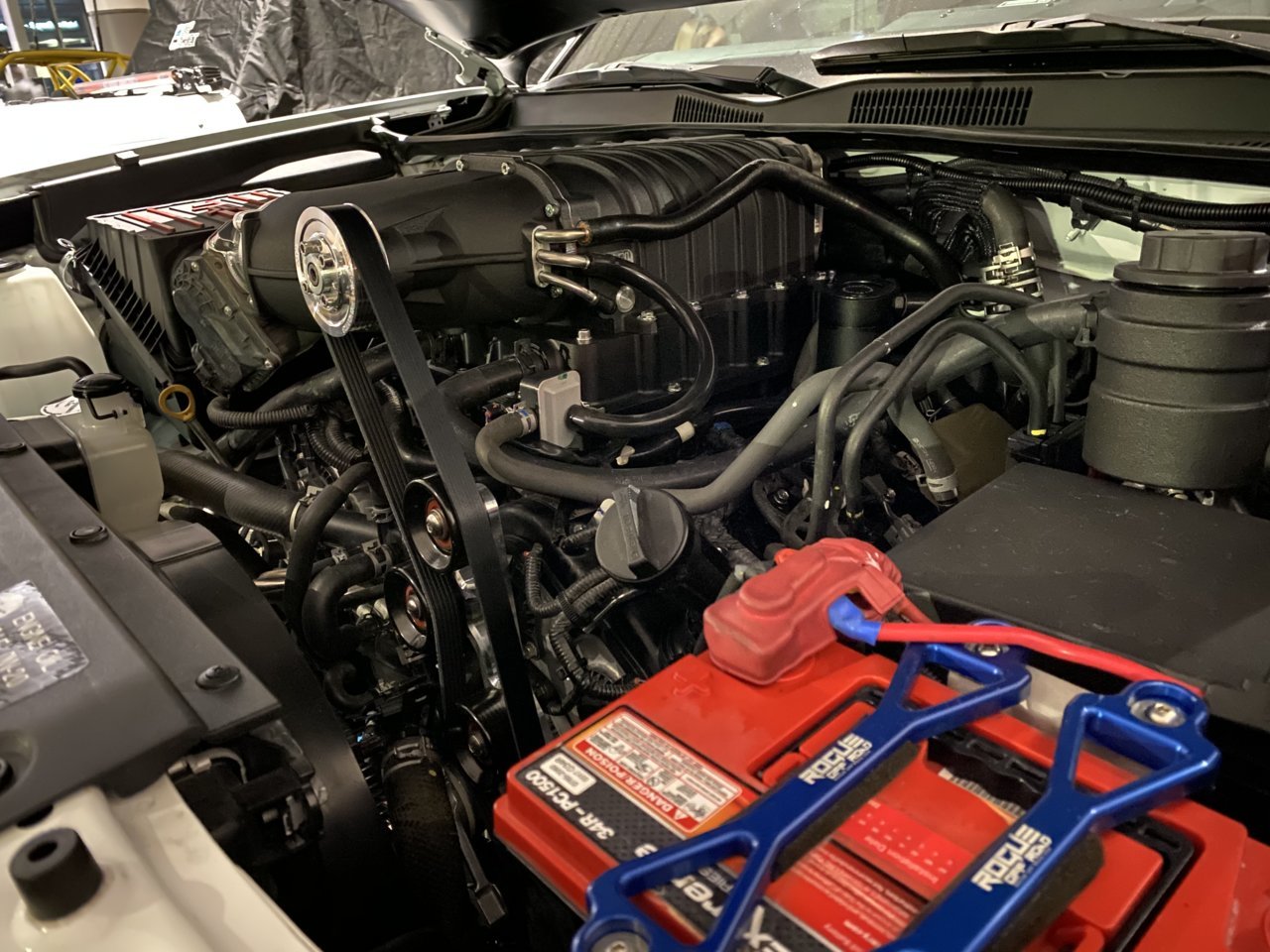

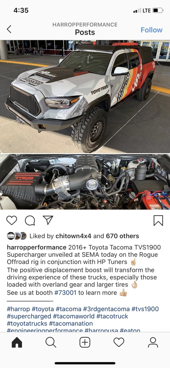

    I saw this. Was leaving Thursday night and spotted a turd gen with hptuners graphics. Hood was up, so, I got nosey. Owner chatted me up for a bit. He works for Rogue. Spoke to Harrop the next day. They hesitantly admitted that they’re currently developing this blower for the 1gr. But, no promise date. Tvs1900. Improved manifolding and intercooling. I haven’t fact checked this yet, but, I was told that the blower was capable of 500 hp airflow. Quick change pulley out of the box, cool. I see this blower in my truck in the future.

    That’ll be nasty!!! That’s pretty cool that you got to see it.

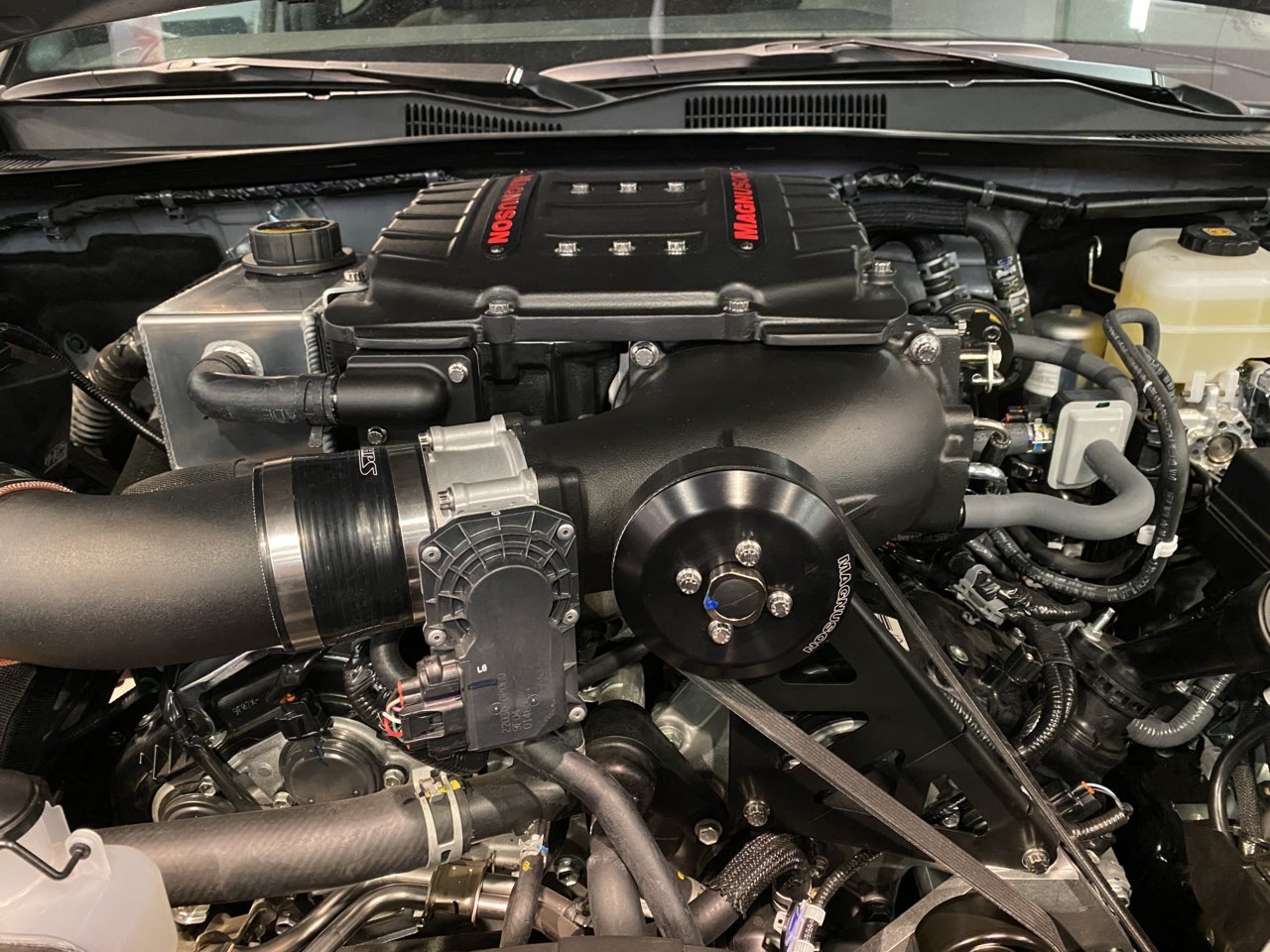

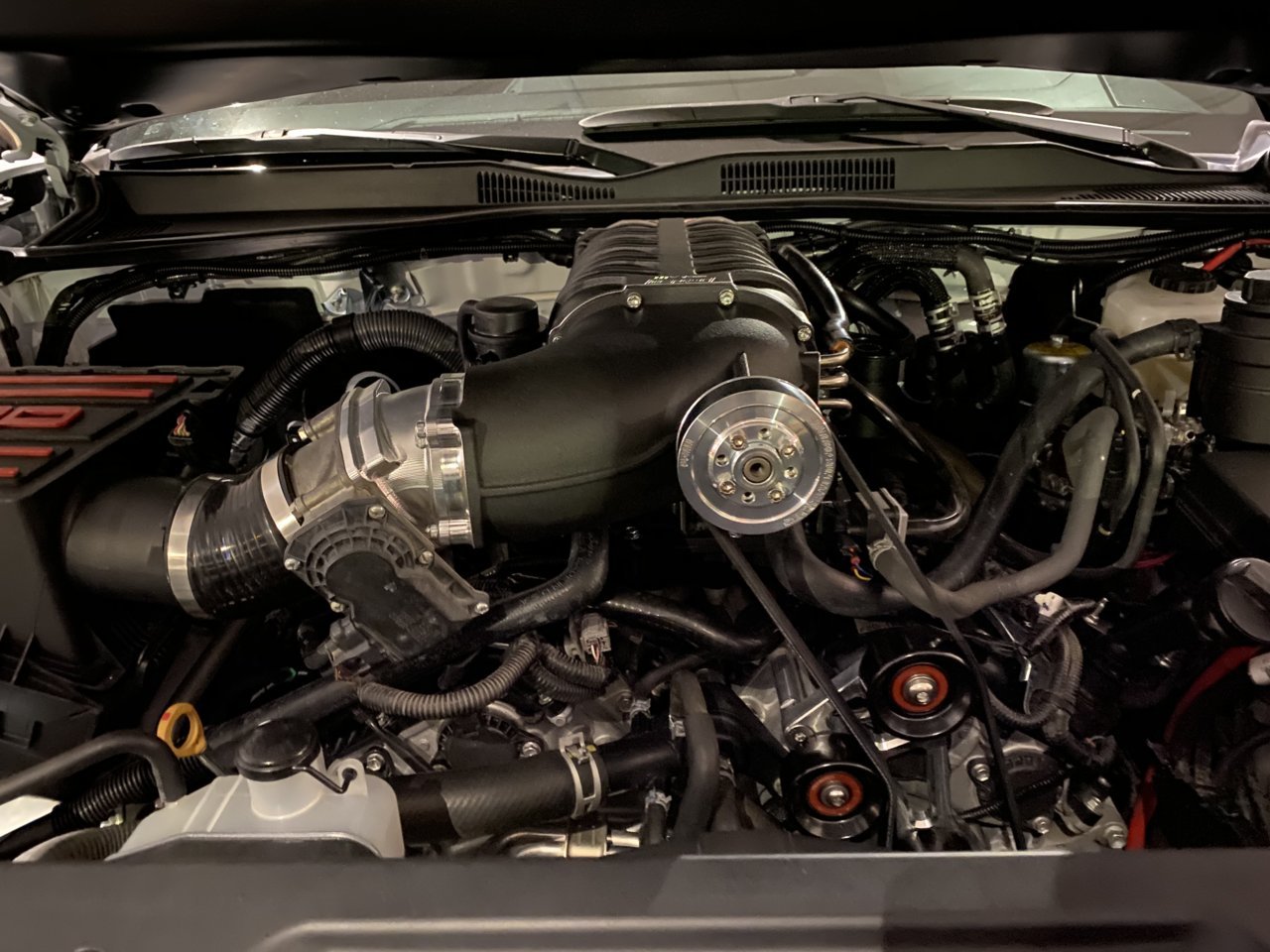

    Maggy version. Hptuners doing the tuning for both Harrop and Magnuson.
    $6500!
    I chatted them up too. The $6500 is an “estimate”.

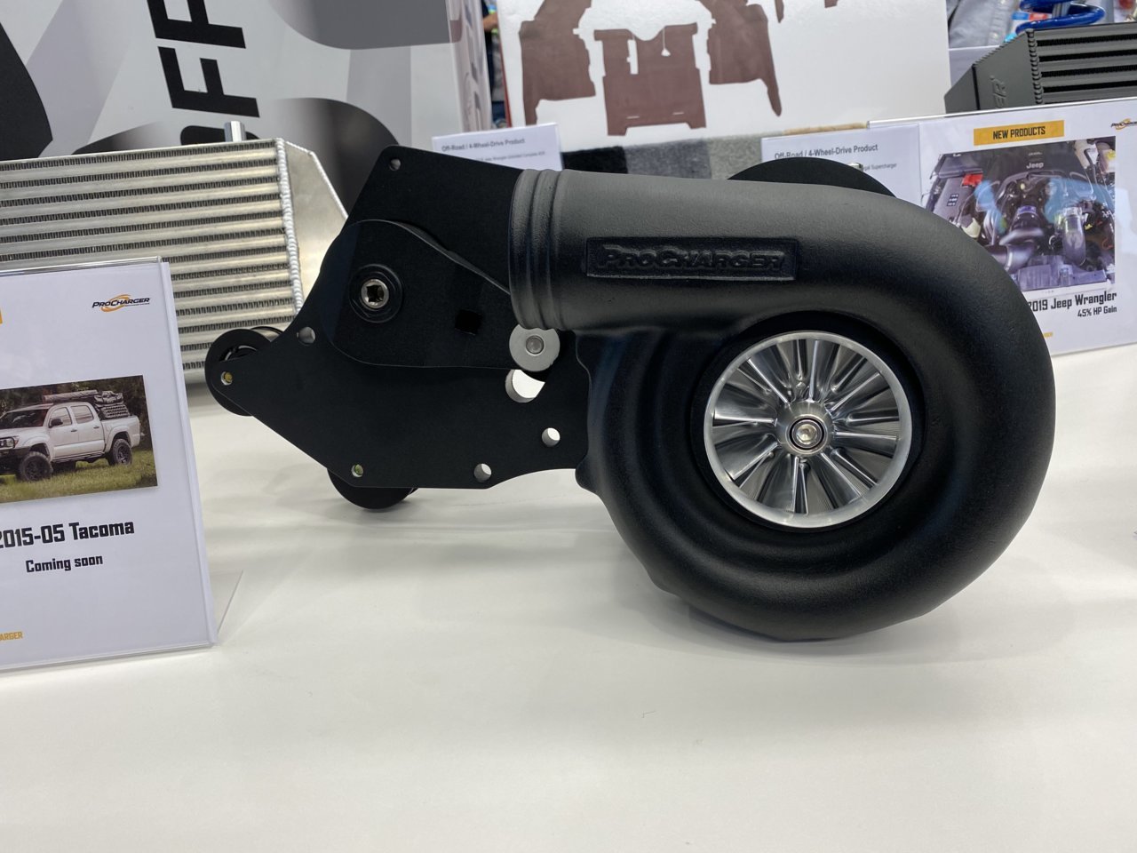

    Spoke to these guys too.

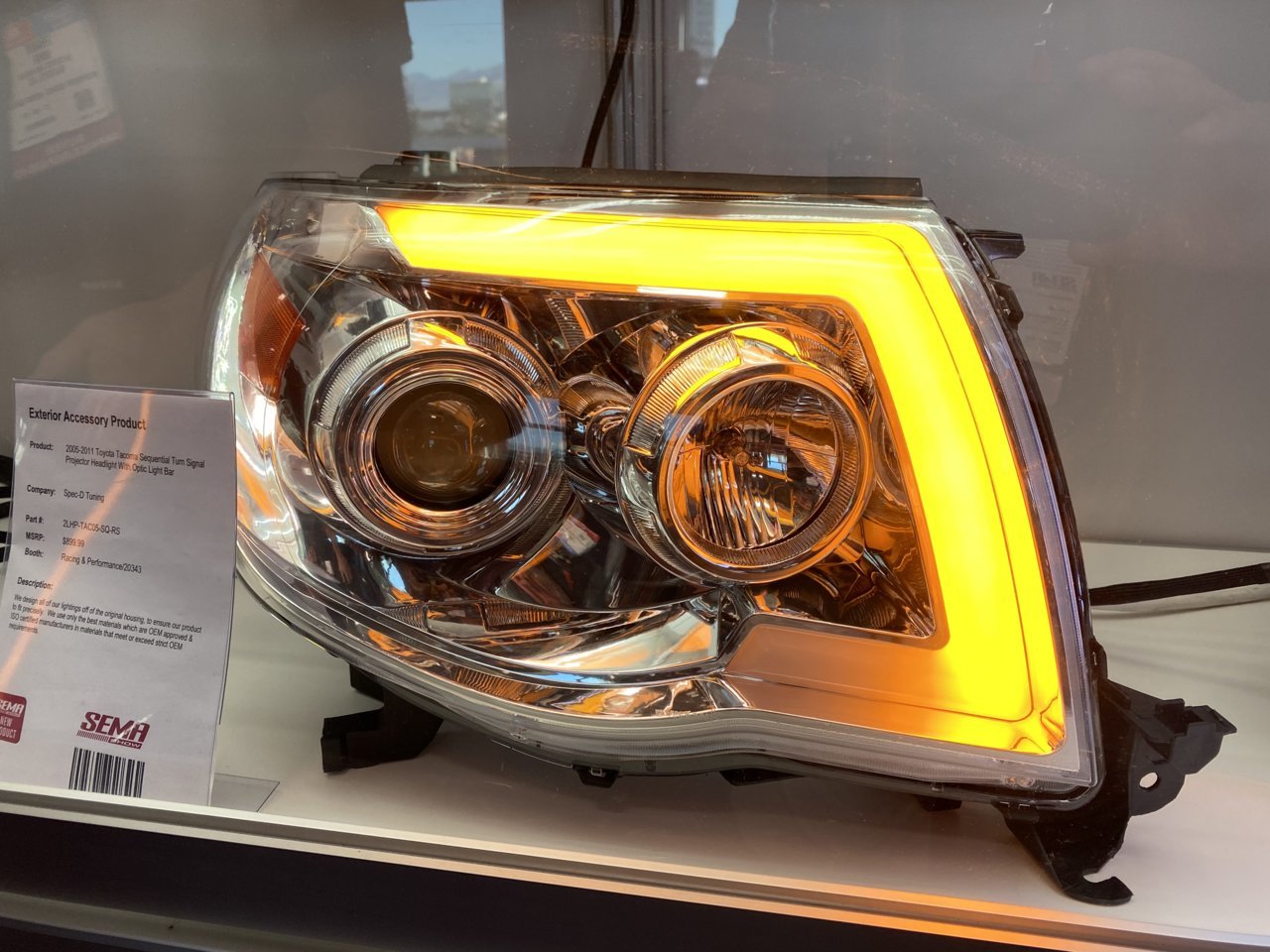

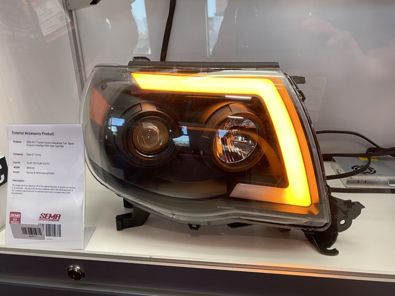

    Fancy lights for early 2nd gens. Spec-D tuning
