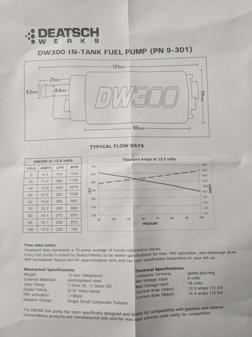

    2013 X-Runner
    I mean it came with pressure and flow vs amperage curves so if you have that plot for yours we can get more scientific than butt dyno comparisons lol

    I dont have that, at least paper version

    Here's mine if anyone finds one for the green top.

    The pressure and flow vs. Amperage curves can be found on AEM's website.
