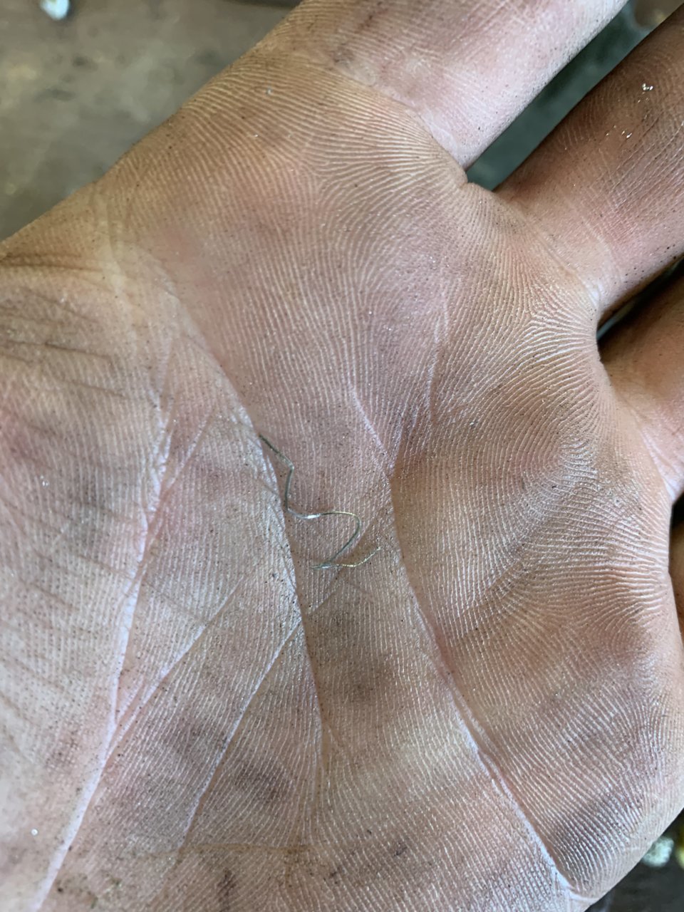

    @DiamondW didn't you have to chase the threads on your truck to be able to use the ARP studs for your headers? Id hate to see folks that want to throw these in start running into problems with that

    I had to chase the treads on the arp studs to make them work. I found the studs were not cut deep enough. I spent a long time on the phone with ARP but when my brand new Snap on chase pulls this 1CDE32A0-5253-409A-A7AC-CE4EC97783BB.jpg
    from the stainless stud, and then it goes in the head after that with out a problem, the studs are the problem. I hand chased all of them and got them in, but man did it suck.

    Your way worked as well. On the '03-'04 heads, the studs fit without hesitation. On the '05+ the head tolerance is tighter.

    So is it better/easier to chase the block or the stud?

    All depends on the installer.

    i gave up chasing studs.
