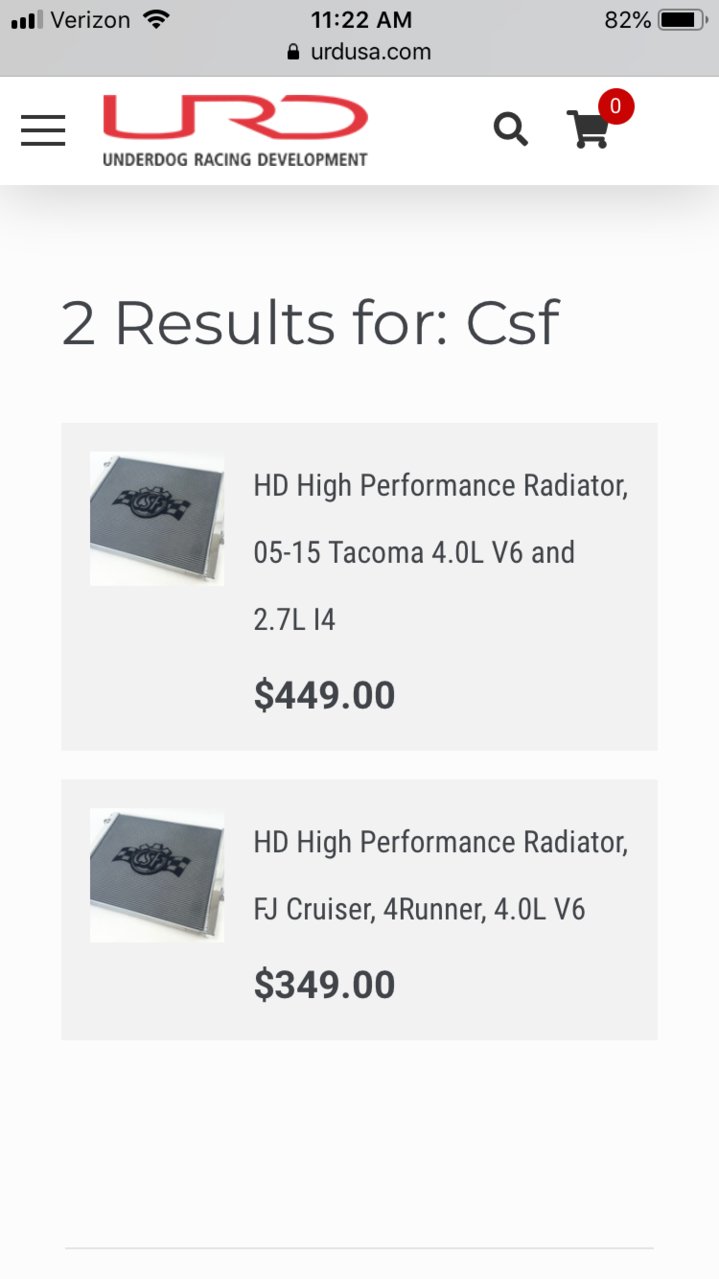

    Happy thanksgiving boosted brothers. I’m alone today so I’ll be on the inter webs a lot lol. Family is down in Tennessee. And I no everyone is busy but was gonna order a radiator and then saw this. 2 options and I thought there was only the fj option. Also $100 difference???

    Sometime after everyone put the FJ one on their Tacoma’s, they came out with the correct size for the Tacoma. The FJ one fits just fine and easier if you use the fj fan shroud(then there will be no cutting)

    wonder if there are any advantages to having a tacoma specific one? like for guys that go wild with suspension. sway bar clearances??

    I think the only clearance issue is/was the trans line issue. The ones that got it know it’s an easy fix by hand bending the line subtlety

    the tacoma one is thick with 2 rows not just one row like th fj style. i have the tacoma one in my truck. i like that it does not hang lower than the frame rails. hope that help.

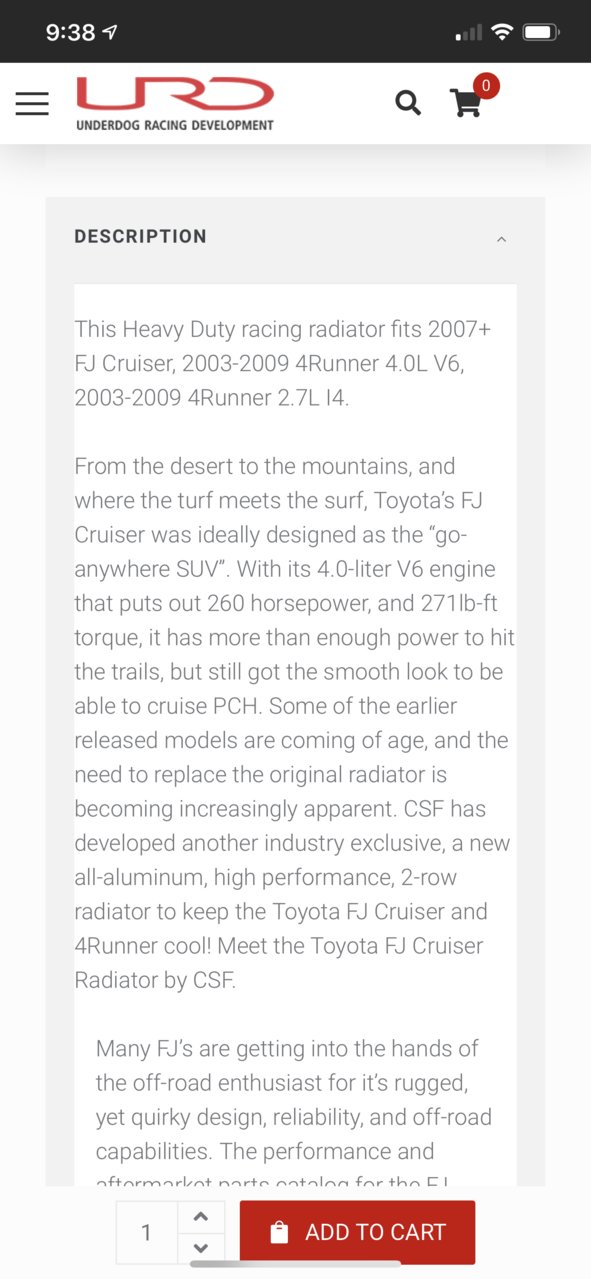

    The fj one is two rows also and it’s bigger

    Interesting......when I was looking at the radiators I thought it said the fj radiator was 1 row B-tube and the Tacoma was 2 row B-tube.
    I must have misread it.

    Strange that the Tacoma version is actually a smaller rad but is priced $100 higher. I guess you pay $100 extra for the privilege of reusing your existing shroud and reservoir and not having to use your fingers to tweak the transmission cooler line.

    I’m thinking of gettting the fj one and making it work. No tranny lines for me and saving $100 for a bigger radiator sounds good to me.

    Just get the cheap Chinese FJ shroud and coolant tank. That’s what I did (before I went e-fan) and they fit great.

    You didn't misread. I remember seeing the same thing posted several times in the CSF All Aluminum Performance Radiator For our trucks FINALLY!!! thread, but I think the the 1-row claim regarding the FJ version was eventually discovered to be false or a typo.

    I have the Fj one. Have had it for almost a year. Fits like a glove (once my 4yo helped me bend the trans lines). I had to spend about $100 on FJ parts to make it fit. The taco one is newer why I guess it’s not on sale. I don’t know if anyone has a head to head comparison between the two.
