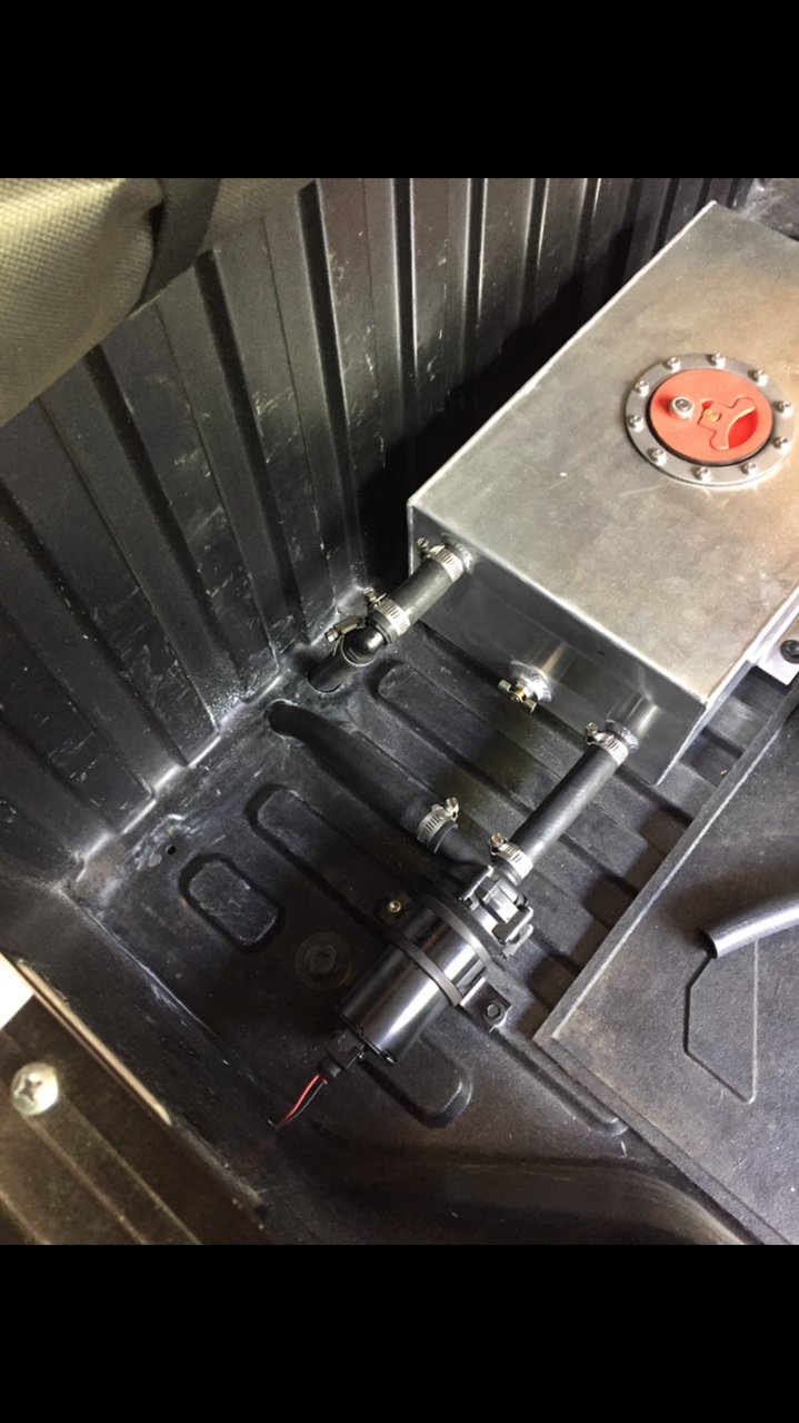

    Yup. A motorcycle radiator plumbed in series with a second pump. It's a smaller pump though, so I am considering upsizing the additional one.

    Let's see what you got. Any pictures?

    I'll have to dig through them when I get home. I think I took some when I first installed it.

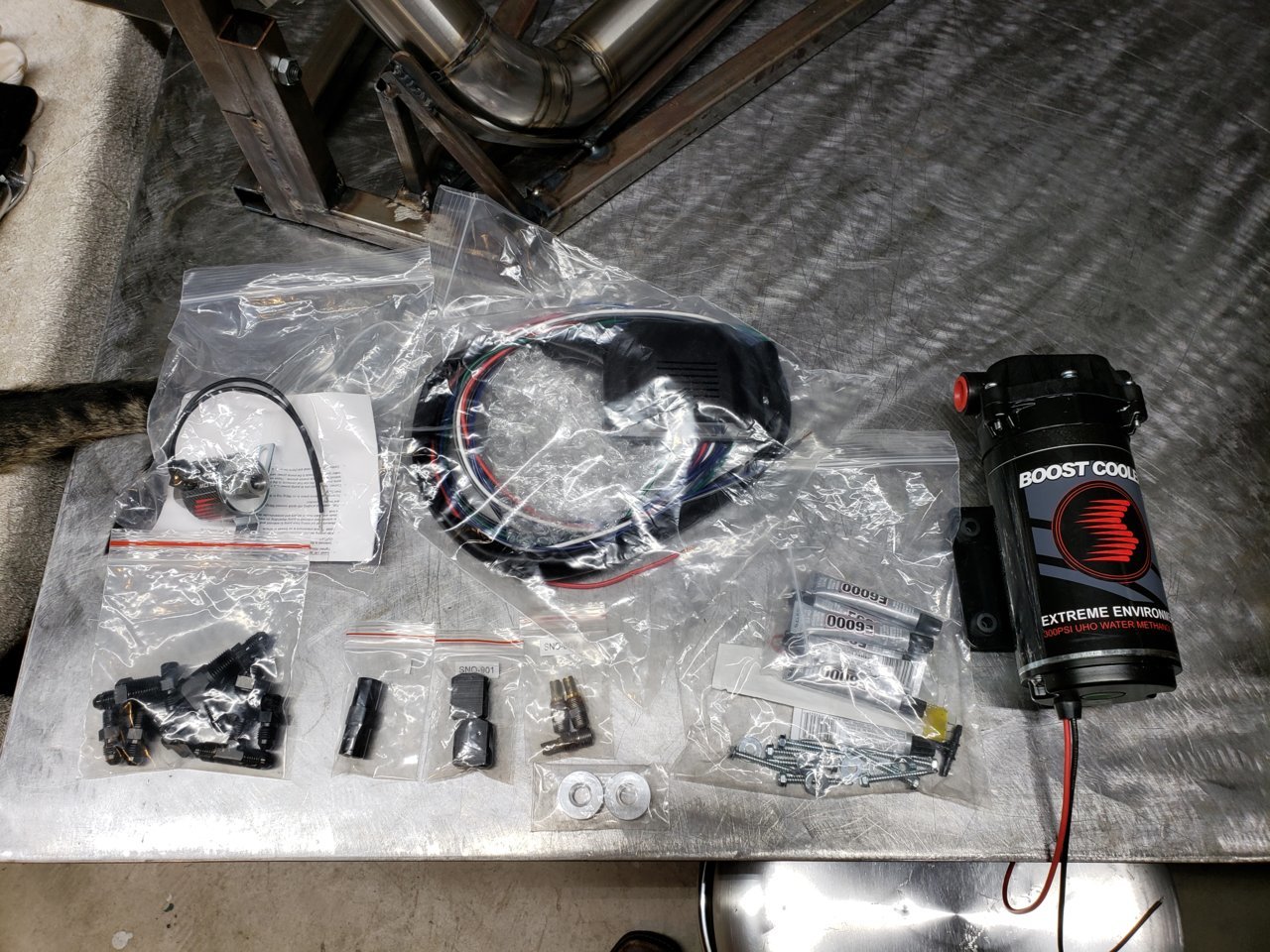

    Kind of a Frankenstein kit. I am going to do some testing for them and us since I can monitor intercooler temps. If all goes well I MAY be able to provide a small ?? discount to the homies here.
    Will do! I have the stage 3 controller and plan to control two stages with this controller. I currently have a #2, #3, and #5 nozzle.
    I need to get my boost and afr hooked up to my HPtuner to be able to accurately test/tune the system but I am excited!
    5 gallons of pure meth in metal container in hand ready to work! :D
