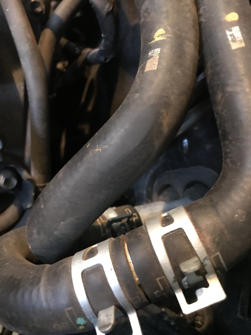

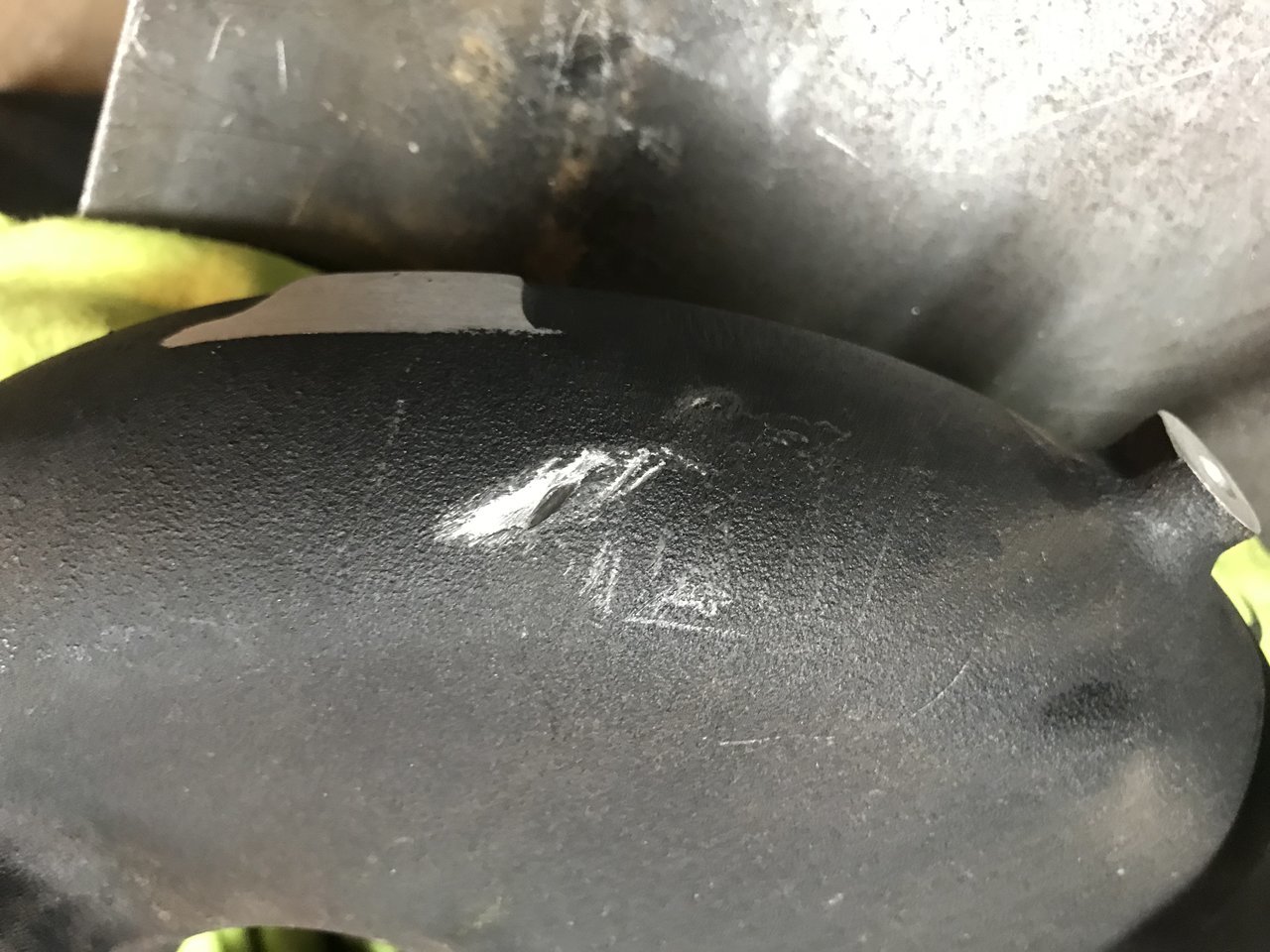

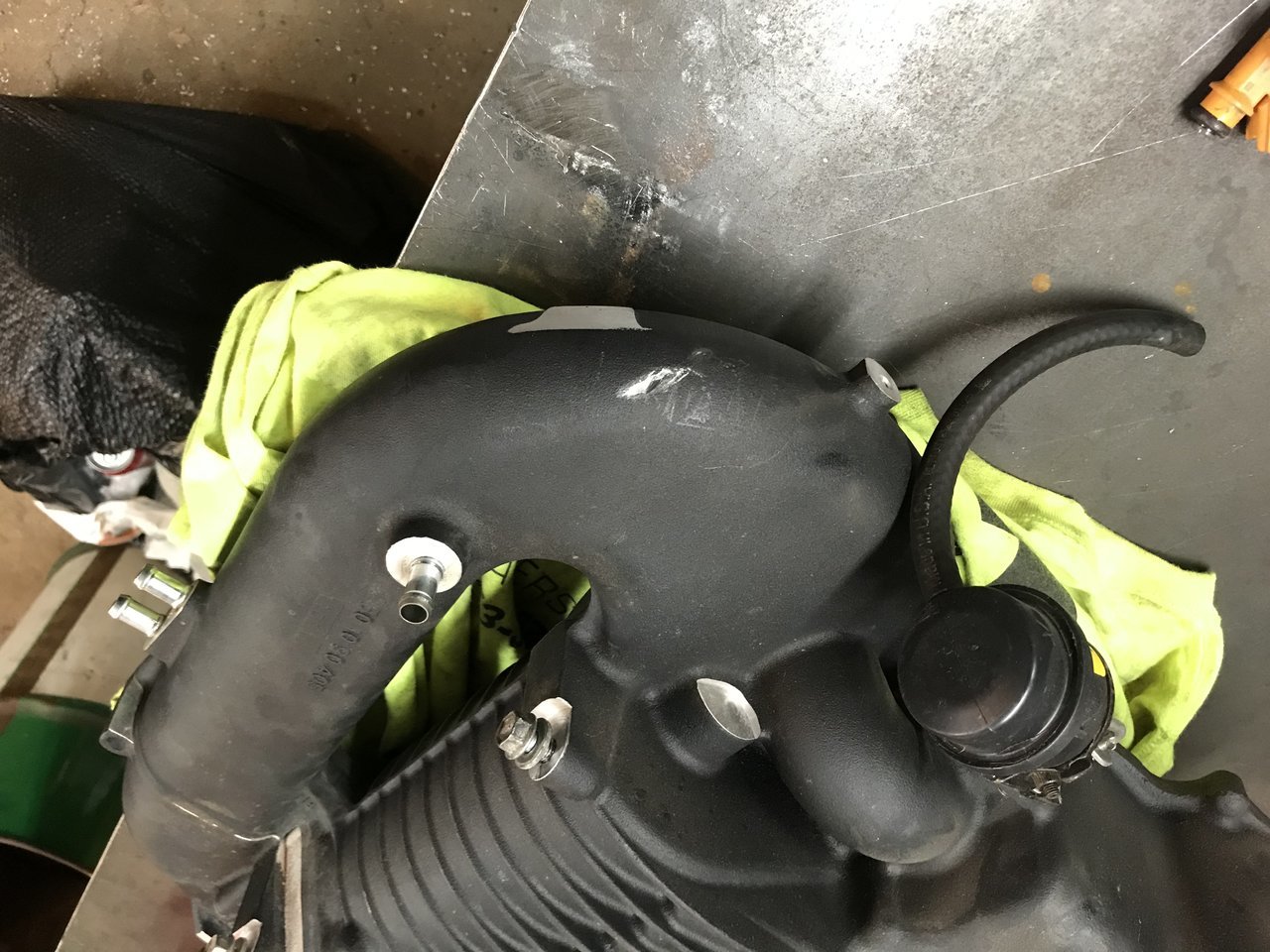

    Here’s a heads up. Found this today when I pulled the Supercharger.
    The spring clamp was rubbing, and cutting into, the SC. The other hose has a flat spot from rubbing on the SC.
    I rotated the spring clamps, and will put rubber between the hoses and SC when I put it back on.
    Anyway, check yours if this isn’t a known problem.

    Thanks for sharing, Ill have to check that out on mine.

    I see.. will rotate soon

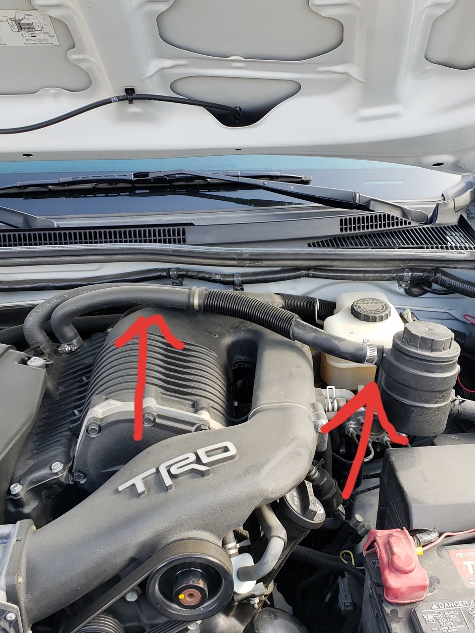

    Hey folks, does anyone know the part number or size of this coolant hose? Mine is leaking at the clamp (arrow on the right) and I think it's because the clamp dug into the hose. Any help would be great.

    Ah, this is where I throw out my Figs Engineering option and the world hates me. I think you can move that clamp and tighten it some more. My lid was leaking on my reservoir and I was convinced it was that clamp. I replaced the lid. Still leaked.
    http://www.shopfigs.com/v3/TANK-COOL-FAB-MAG?search=supercharger
    You already spent a bunch of money on your truck. Give it the reservoir that it deserves.

    I don’t mean to hate, and I am sure it is a very nice piece. I just don’t get how we can buy a complete aluminum radiator that is bigger than stock for cheaper than that tiny tank :/

    Its not the hose or the clamp.
    Its the fucking reservoir. The texture on the nipples seems to prevent a decent seal between it and the hose. This is a common problem.

    @#$%!!! You're hating already. Just love the little reservoir. I have NO leaks. I'm sure the savings in antifreeze is paying it out.

    Hahaha. I want to love it but she isnt even bigger than the stock tank :annoyed:
    If it was maybe 2x the amount I could justify it somehow.

    Hell I wonder if we could get something like this to work instead of the garbage plastic tank? https://www.summitracing.com/parts/ctr-80-242
    Or just relocate the battery to the bed and mount that big SOB that is in the op.

    So only solution is to replace the reservoir huh? Well damn :(

    Or let it leak...

    Emery cloth?
    Dremel and high grit drum?

    @Coupe used to make a reservoir. Insufficient demand, I think.
